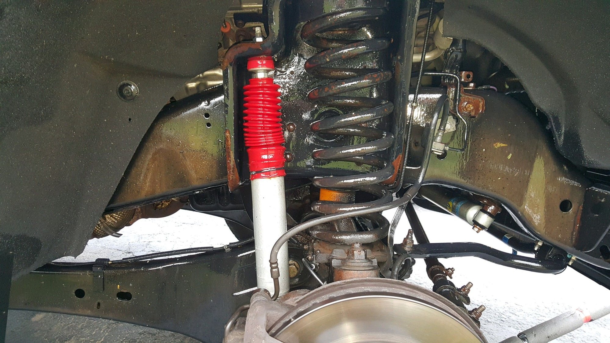

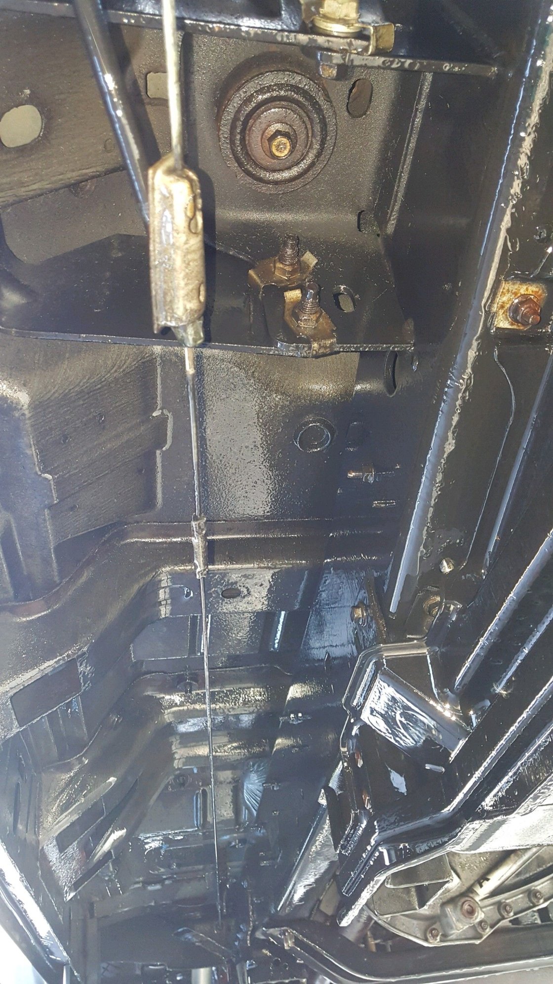

Purchase a truck NOT pre-rotted from the rust/rot belt. Shop for southern or western dry trucks.
Then find a Krown or Corrosion Free dealer and get it salved up (treated) from the get-go. LPS3 and Fluid Film are ok too. But read up.
Why would anybody drive a new $60+K truck off the lot directly into the salt with zero protection? You'll get 5 years before it falls apart.
https://www.howtosavemoney.ca/which-...ervice-is-best
Nothing else works. Do not do the rustproofing which applies the black tar-like driveway sealer substance to the underside. It actually holds the rot and water in then rots upward...ask how I know.
Purchase the FOMOCO rear fender well liners.
Here is my 2011 just after its annual Krown application. I live in the rust belt. The truck has 88K on it.
Don't wash it until the spring when the salts gone.
The only negative is if you don't drive the truck much it can get slimy when working on the chassis. A 1/2 dozen passes through a good car wash helps.
It's designed to somewhat dissipate and it is water-soluble. Thus the annual reapplication for the 10 year rot through warranty.

I've heard before that Krown is the Canadian version of Carwell Products. My truck looks exactly like that when they spray mine. Red oil creeping and a crawling. I get mine done once a year also. That's what I have to buy this year are the Ford rear wheel well covers. I'm going to MonstaLiner the wells first, then install the liners. Great pics.

@droldsmorland that looks good.
