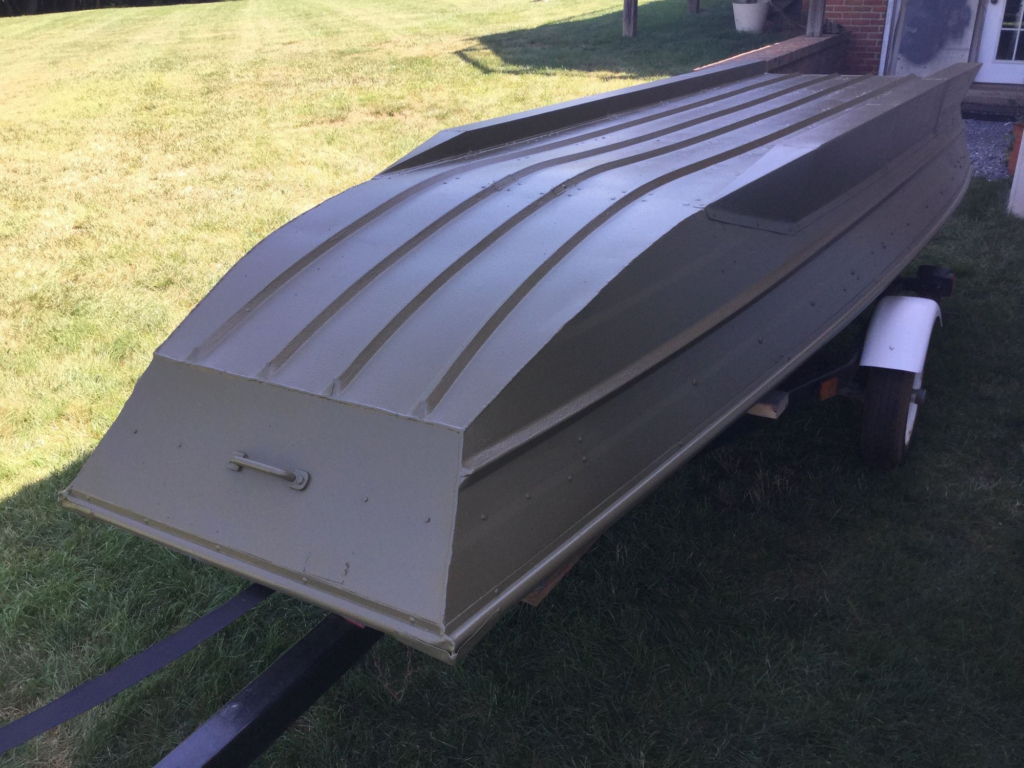

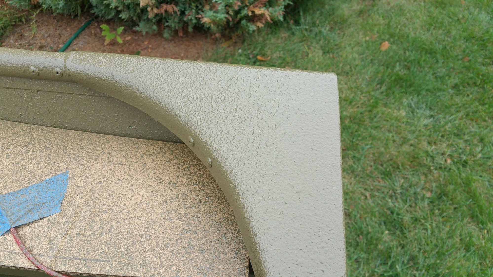

Personally, I like chrome bumpers. But if you are going to coat them, I would do a full two tone. The stripes don’t look so good to me.
If you DIY, I would not use the Duplicolor. Not one of the better products out there. Raptor works good, but it’s hard and brittle when it hardens. My last few projects I’ve used Monstaliner. Very durable, but stays a little flexible after it cures, so it’s not as likely to chip. I have a Jon boat I coated with it a few years ago and it still looks great. Monstaliner is tintable to match paint too. My new 350 is two tone, and I’m thinking about going over the rocker panels and wheel arch molding with it just for the texture. Rolling it on with their rollers or an undercoating gun both work well.
Edit: Here’s pic of the boat. I rolled on a coat for good coverage, then sprayed the last coat.
