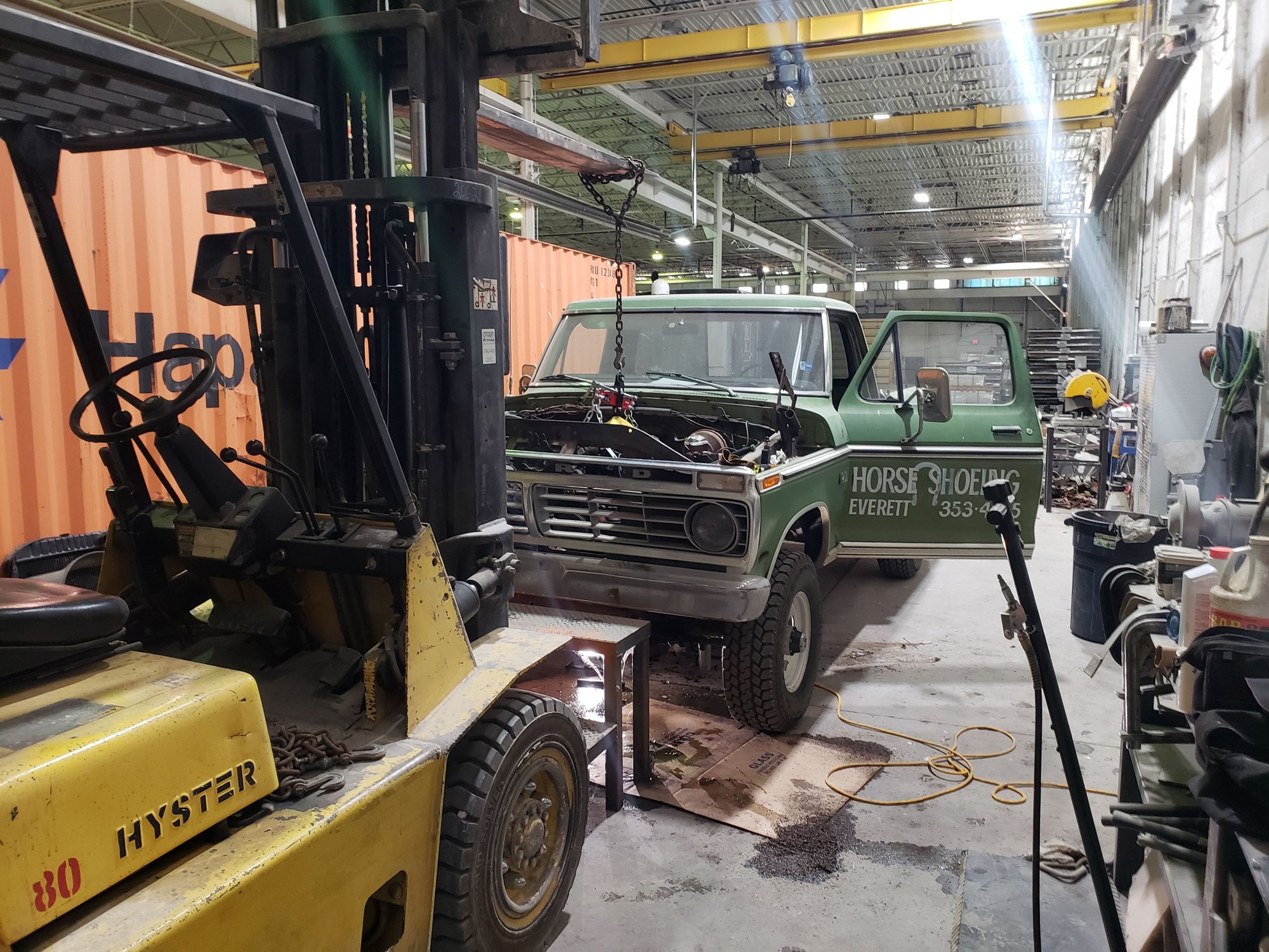

My journey with my 74 High Boy began 3 years ago when I found this truck parked next to my neighbors barn in Washington.
My neighbor purchased the truck off the showroom floor in 1974. When I first approached him, he was "never" going to sell the truck. And to be honest, he still hasn't "sold" the truck however it is now my truck with the promise that I will pass it along to someone else who want's it as badly as I did.
So, it's a western Washington truck that lived out among the pine trees and wet weather. It has cancer, lots of cancer, everywhere the pine needles collected and held moisture. So, she will be in need of a lot of metal work. Thankfully there are still plenty of resources to get said pieces of metal.

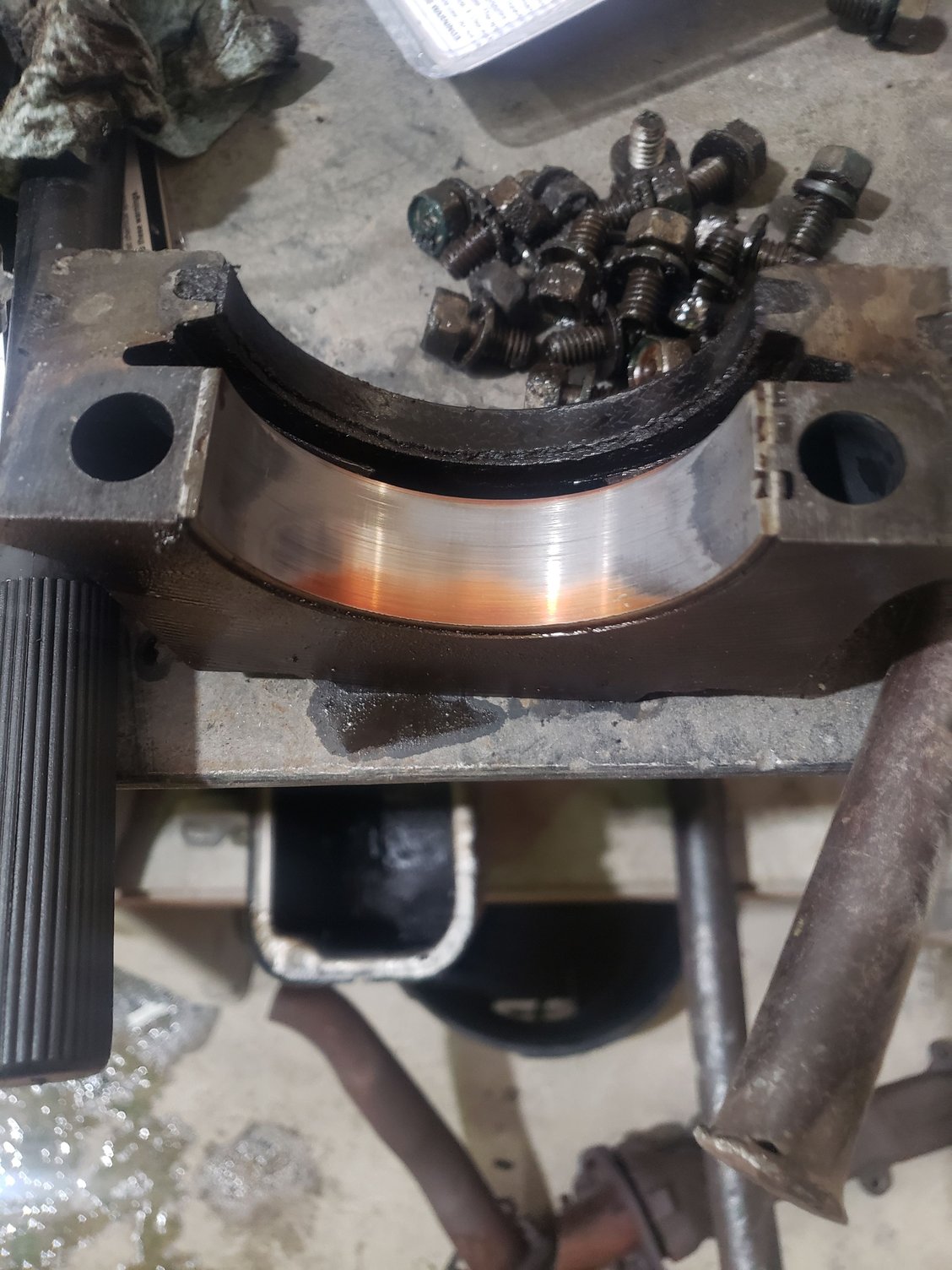

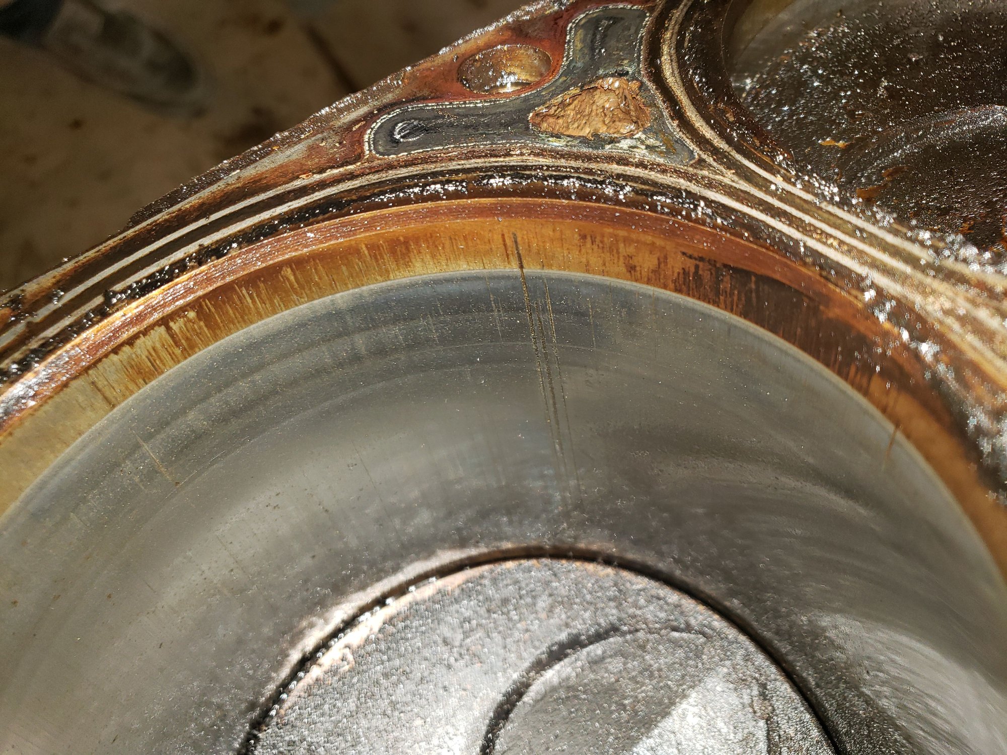

My immediate concern however has been the motor and it's desire to mark it's spot every time I parked it. According to the original owner the motor had never been touched. Well, what someone else considers touched and my take on touched are not quite lined up. Every bolt was loose, one exhaust bolt was stripped with a nut on the back side to hold it, the lower exhaust bolts had obvious anti-seize on them so definitely off since it left Louisville. My goal was new gaskets on the pan, covers and new rear main seal. Once I got to the rear main, I find copper staring back at me which means new rods and mains. Heads come off next to find gouges in 2 cylinders deep enough to catch my nails on them. So we are now at a full blown overhaul.

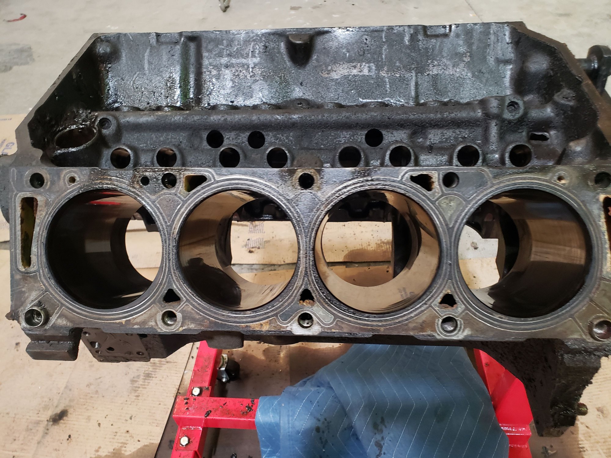

Engine is tore down
Engine is down to bare block, lots of color on all bearings. Cylinders, rings, pistons on the other hand look fantastic aside from grooves in a few bores. Expected to find broken rings but all were intact, sharp and clean.
At some point, something got in the engine, sand, small parts, who knows.
