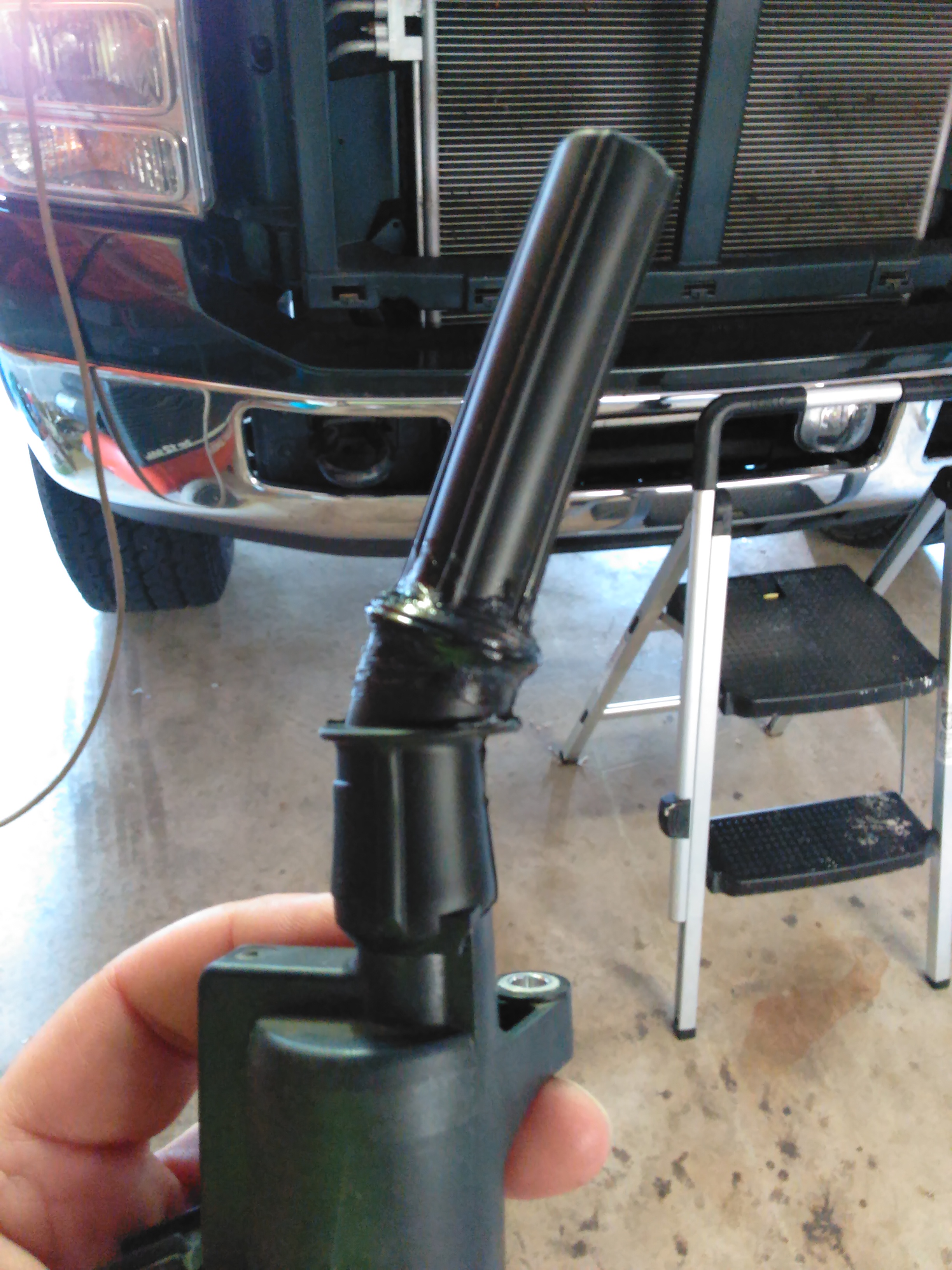

However, when I pulled COP #3, the boot looked like this:

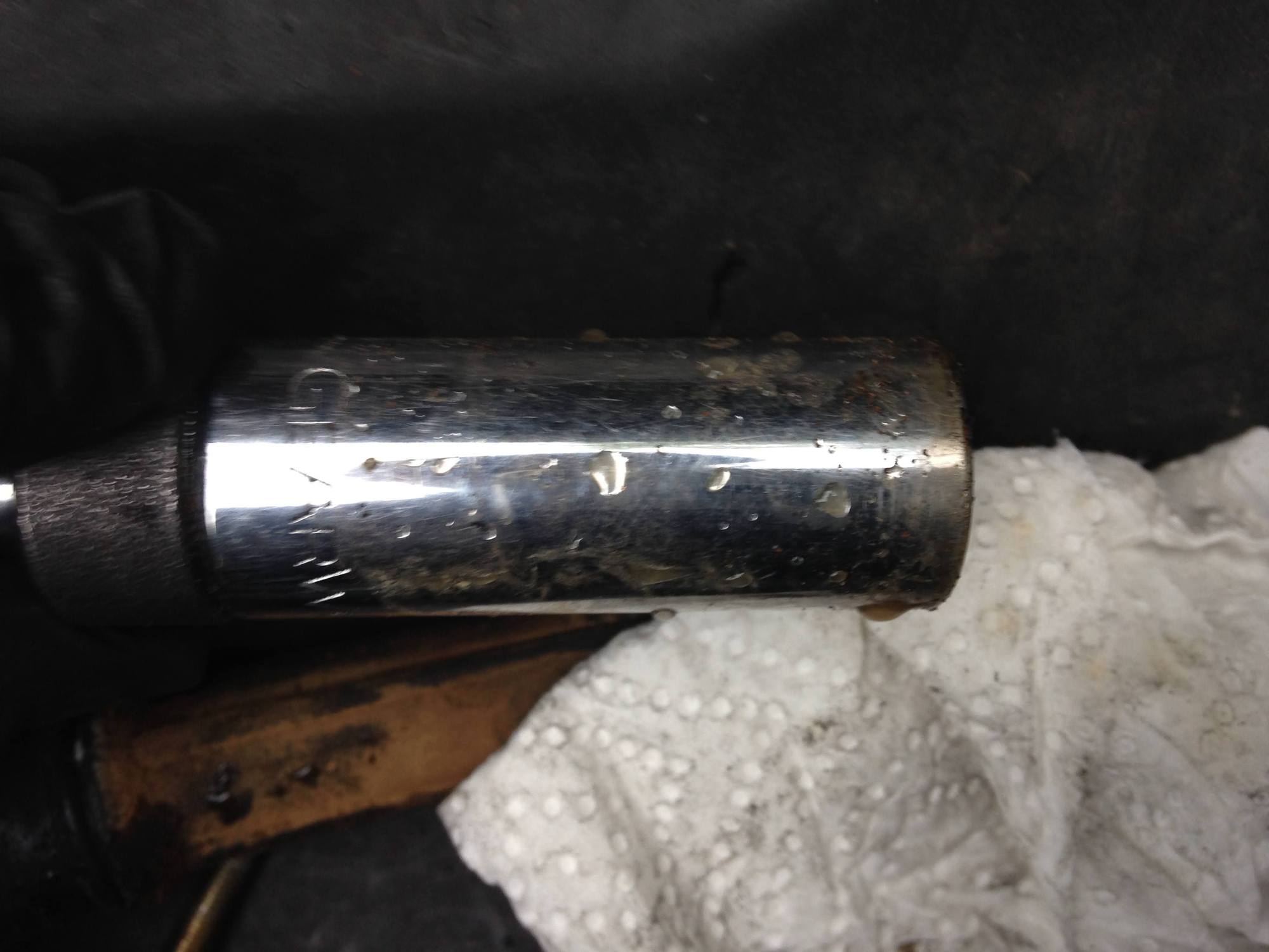

I put a spark plug socket on the spark plug, and it came out with coolant on it:

Given that the spark plugs and boots are all fairly new, I'm considering simply cleaning out hole #3, replacing only that plug and boot, and then putting O rings on all 10 spark plug boots with dielectric grease. They all had grease when I put them in, however I did not put O rings on them.
My concern is that this is an intake gasket leak. What are the changes of that? Would coolant be in more than one cylinder in that case? Given that only #3 has coolant, it seems more likely that coolant has been slowly dripping from the heater hose or something? Although that all seems dry to me.

The coolant in the intake is only at the front and back, nothing close to the middle. It would be in a front or back cylinder, if that was the case.
Check for leaks of the heater hoses around there. Does the X have a heated PCV? That would be right above #3.
What happens is water or coolant get on the spark plug boot seal, and as the engine cools off, the air in the spark plug hole contracts, and it sucks the coolant down the hole. Takes just a few drops a day, and suddenly you have a tablespoon of coolant in the hole. Same thing for water too - my V10 with something like 30K miles on it had a mix of dirt and water down the #10 and #9 holes.
