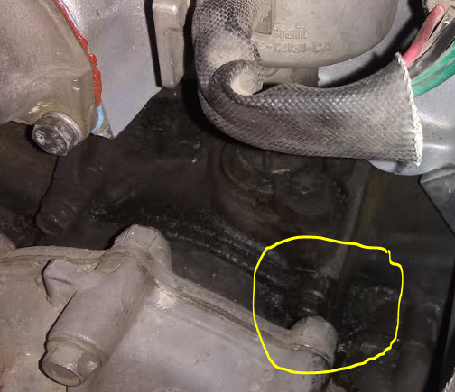

you didnt say I6, v8, if v8 mine started slow and finally enough puddled up I could see where, it was oozing out timing cover at top under distributor

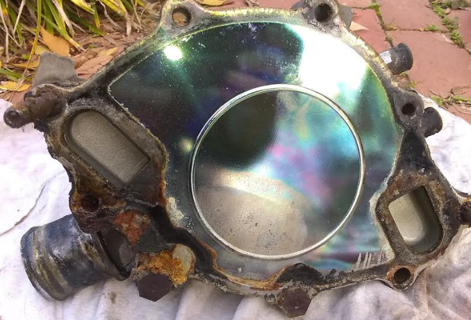

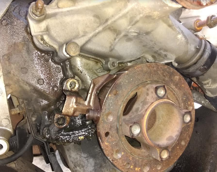

Old Jul 2, 2020 | 05:50 PM
torq'ta 5 8's Avatar
torq'ta 5 8
Joined: Jan 2019
Posts: 5,070
Likes: 863
From: N.W. Alabama
new water pump, stud was rusted in, not coming out, no telling how long leak was not noticed, and no puddle on driveway, and if yours 302/351w LMR has the bolt kit, even though it says lightning, still same
