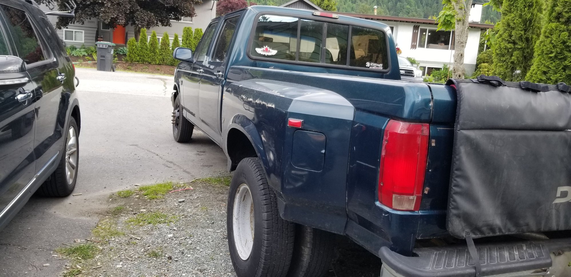

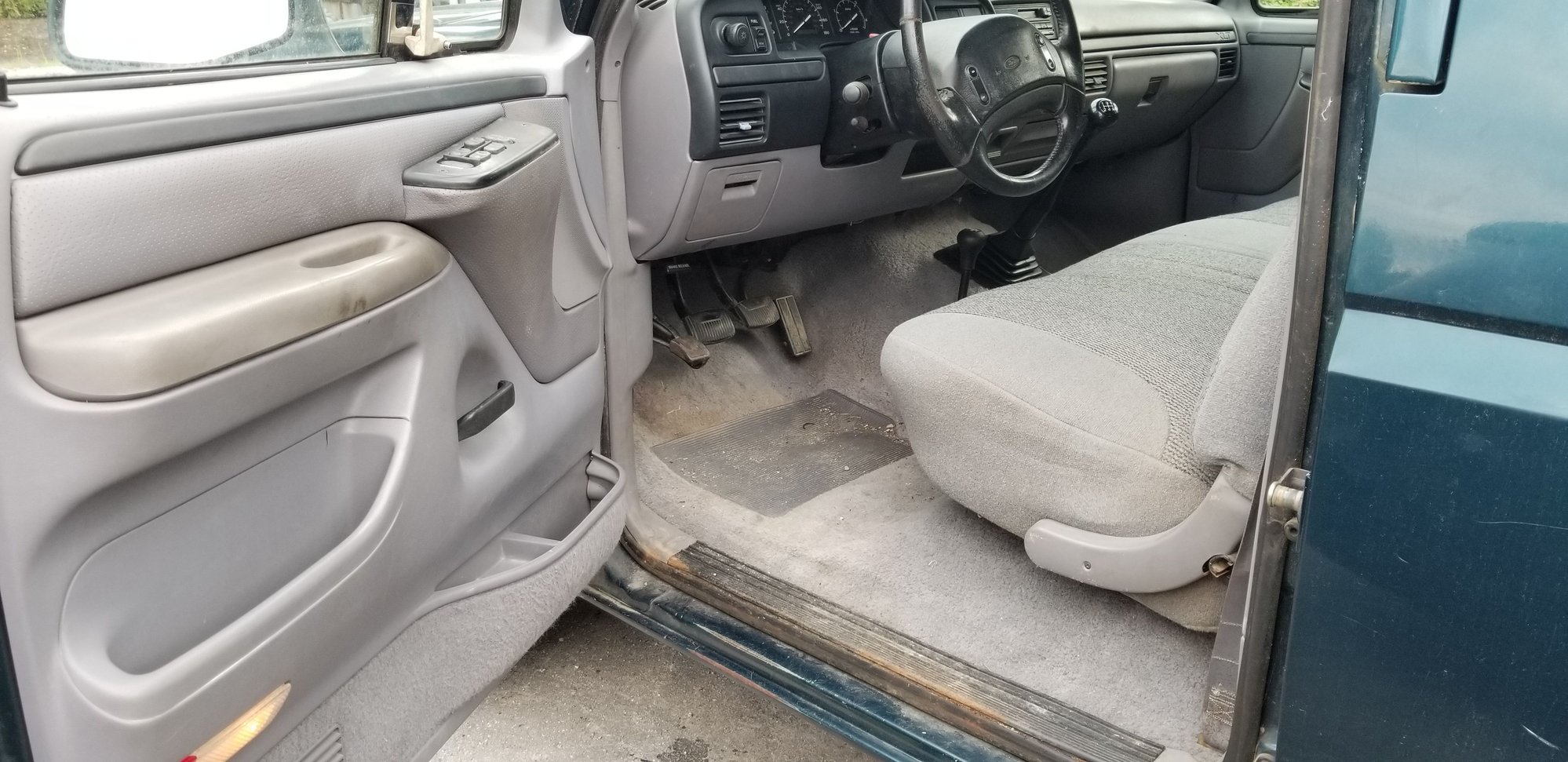

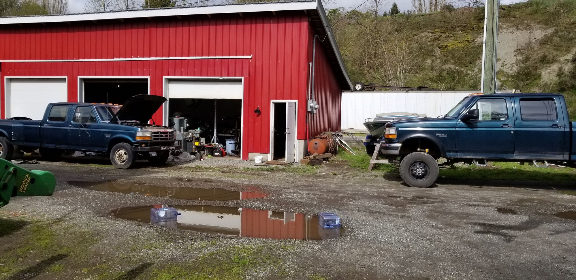

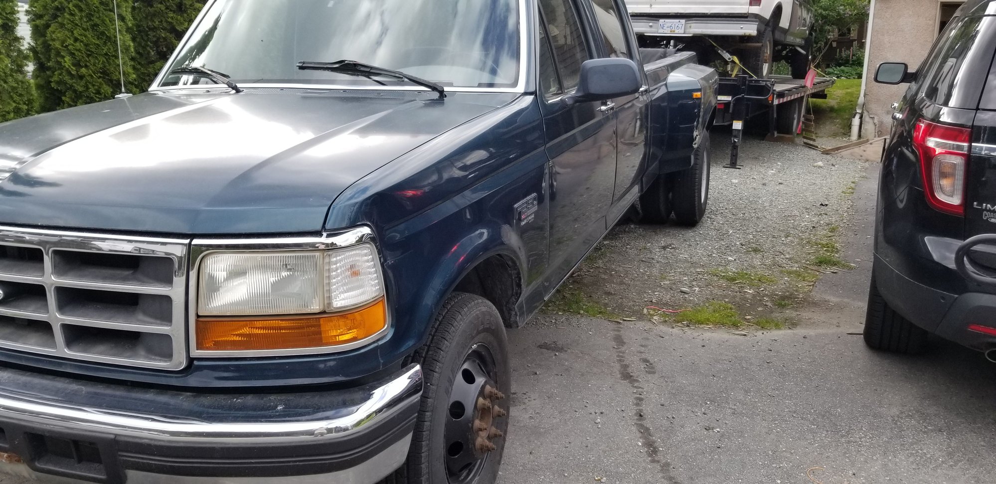

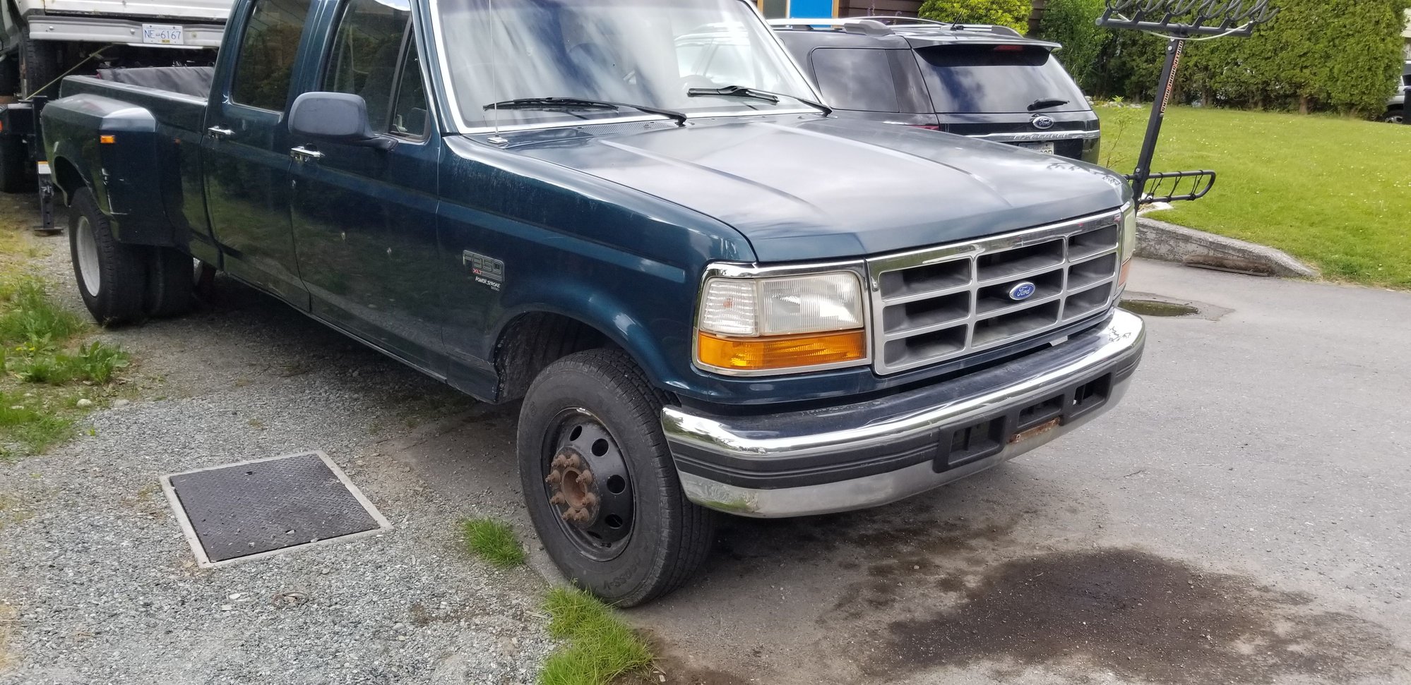

Well a little up date here.
And of course some photos. The neighbors have been 'helping' me out by finding buyers. So I gave a high price..
Last few mechanical things are dragging front brake, AC and fuel bowl reseal or delete, not sure yet.
The final step will be getting the dual fenders fixed and some bodywork done with paint.
There are Alcoa's and the correct bench seats waiting.
