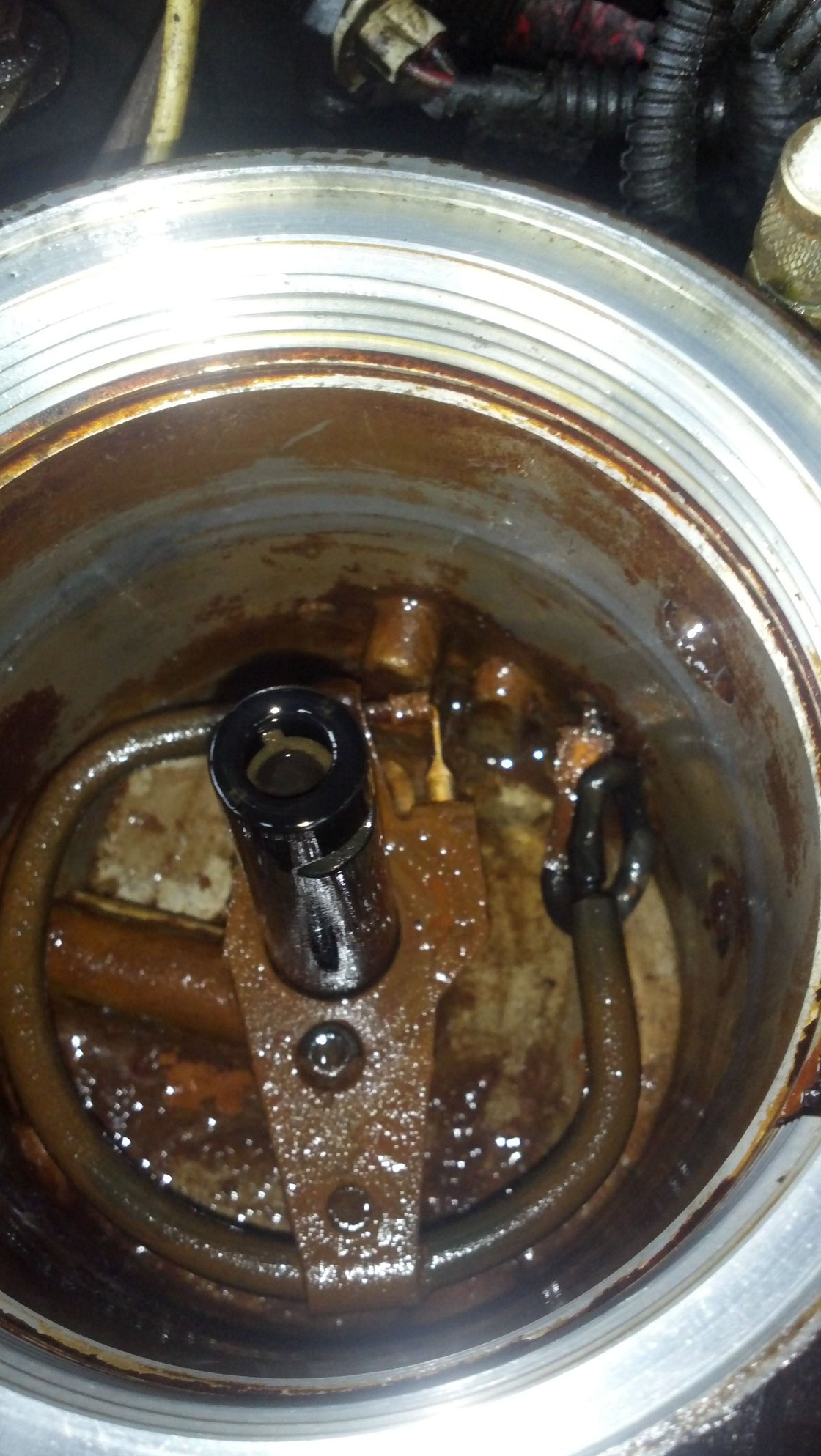

Yeah that was kind of my thought as well. I am hoping I can get by without doing a block flush but this is what my block looked like when I did the front plate assembly as the previous owner ran plain green coolant. So I have a feeling I will be fighting debris for a while.
