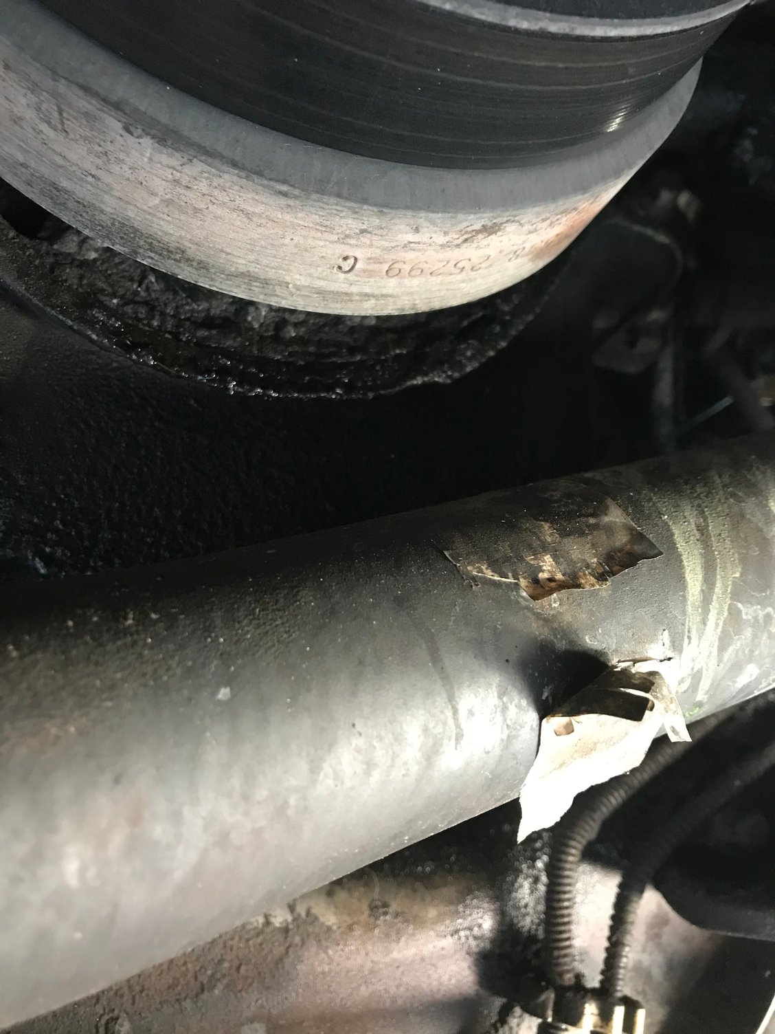

This could be fun!
Front oil pan starting to leak! Not looking forward to this adventure!

You sure its the pan and not the oil pump housing O ring or damper seal?
Honestly not sure till i take some things apart!

I just had the same leak, it ended up being the oil pump. I put on a melling lpop and a fluidamper harmonic balancer. Just dont forget to put some sealant on the keyway for the HB. I found out the hard way lol

LPOP was my first thought as well. Mine leaks a little and I have a new one for when I get the time to dig in to her.

Just about put money on the lopo, not that bad to do.
