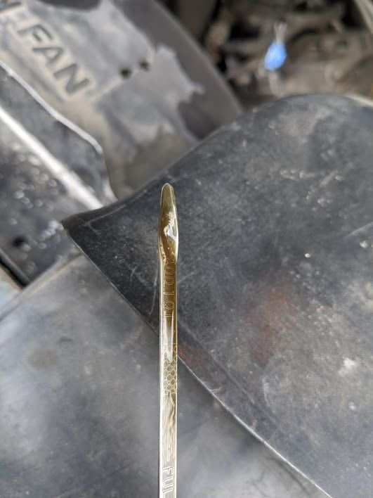

However, after driving it a second time, I decided to pull the dipstick just to double check the oil level after my few trips. There was a little tiny bit of white stuff ON the dipstick. My heart SUNK. Upon reading forums, I guess it's fairly common to see this after a truck has been sitting for a while, HOWEVER, after I got it running I ran it for a few hours total before I noticed this.
With the truck running, I can see puffs coming out of the valve cover when the oil cap is off, and there was a little bit of white residue under the oil cover.
NO contamination with the radiator fluid -- bright green and looks great, SMELLS great (well, as good as coolant can smell).

Hard to see it but there's some white stuff on the dipstick
This was one of the first pulls of the dipstick. That is the only time it appeared this much, other times oil is almost 100% clean.

That just looks like moisture that has sat in the crankcase from sitting. And you did say it had sat awhile before being brought back to life.
I wouldn't condemn it yet. Drive it. And drive it some more. Moisture can hide in every part of the engine and left for long periods of time, can take some time to burn it completely off.
Check it after a day of good long running and then after a few more days. I think you're ok and have nothing to worry about.

That doesn't look like a head gasket failure yet. My 88 headgasket failed and it was streaming water out of an exhaust eader port, and made a cloud large enough to envelope my whole street, and the oil looked like gray chocolate milk. It is possible you have a tiny breach in the gasket or crack, can't rule that out yet, but still unlikely. Head gasket job aint that bad either.

You can also test for exhaust gasses in the coolant to see if a gasket failed with this kit from O'reillys
https://www.oreillyauto.com/detail/b.../67094/4700290
You just add a special fluid sold separately with the kit (like 8 bucks) to that bottle, and hold it over the radiator after the truck is warm (be careful opening the radiator if it's hot, usually I let the truck warm up with the cap off, the thermostat needs to be open for this test). You then use the squeezy bulb thing and keep sucking vapor from the radiator through the liquid in the bottle. If the liquid changes color, you have exhaust gasses getting into your coolant. If it doesn't, then you know that at least that section of your head gasket is good.
I know head gaskets can fail in many ways (like 7); coolant mixing with oil, coolant mixing with combustion chamber, combustion chambers leaking to each other, combustion chambers leaking to oil, or any of those leaking outside) HOWEVER, it seems the most common failure mode for these head gaskets, and pretty much any head gasket I've ever dealt with is coolant mixing into the combustion chamber or oil.
That block tester kit will test pretty much the most likely scenario of a head gasket failure. I highly doubt it would have failed any other way, especially with the miles is has.
I'd also agree with everyone else, if it sat for that long, moisture was probably hiding in the engine. If there is no white smoke coming form the exhaust, you're probably safe. When my head gasket failed on my 94 351W, it was like a steam engine all of a sudden and smoked out the whole freeway!

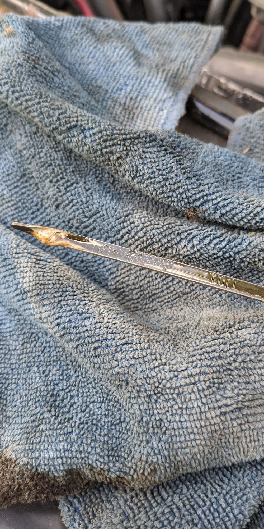

The attached pictures are after a few days of making some short trips with the truck. I decided to chance the pinion bearing, broken leaf spring, and on-the-way-out fuel pump and drive it a little bit on some easier roads.
I did 2 10 mile trips, and another probably 10-12 mile round trip... I would say probably another total of 50 miles or so. I also ran it ALOT around my property until hot.
After all this, 90% of the time I pull the dipstick to normal oil. The other 10% of the time, its got a white blotch in it. Sometimes its hard to see it but there's a small streak of white, but that's seldom. The rest of the time pulls clean. I'm thinking its much less likely a head gasket now, since the antifreeze is also bright green, and has no abnormal smell to it.

My 93 4.9l once in a while would do this. Depending on the humidity in the air. Short trips will do it. My solution? added a catch can to the PCV system so it isn't sucking the moisture and oil vapors from the crank case back into the EFI system. Only have to dump it when I change the oil. The catch can allows the air to pass thru and any fluid or dcondenstation will drop out of the air stream and stay in the can. I cleaned the inside of the intake manifold one time with some spray seafoam and got out as much of the crud as I could after 25 yrs of just normal PCV operation.

One of our long time senior users, which I forget his name, swears by Heet. All of the replies when mentioned are positive. Maybe some that have experience with it will chime in with their opinion. I have NO experience with it but check it out and see if it's for you. I also agree you don't have a blown head gasket. Sandy
