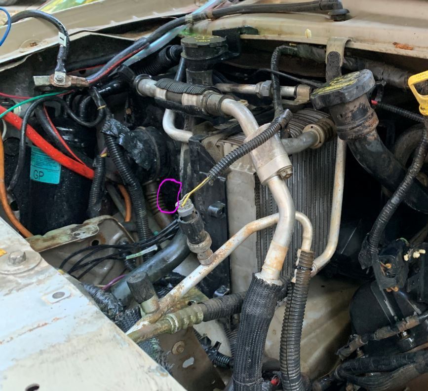

Blower resistor. It is probably rusted and needs to be changed. Easy job, take the battery and you will see the blower motor mounted on the firewall. This is the best picture I can get. It doesn't show, but it is by the marked spot.
Blower Resistor Blower Resistor
