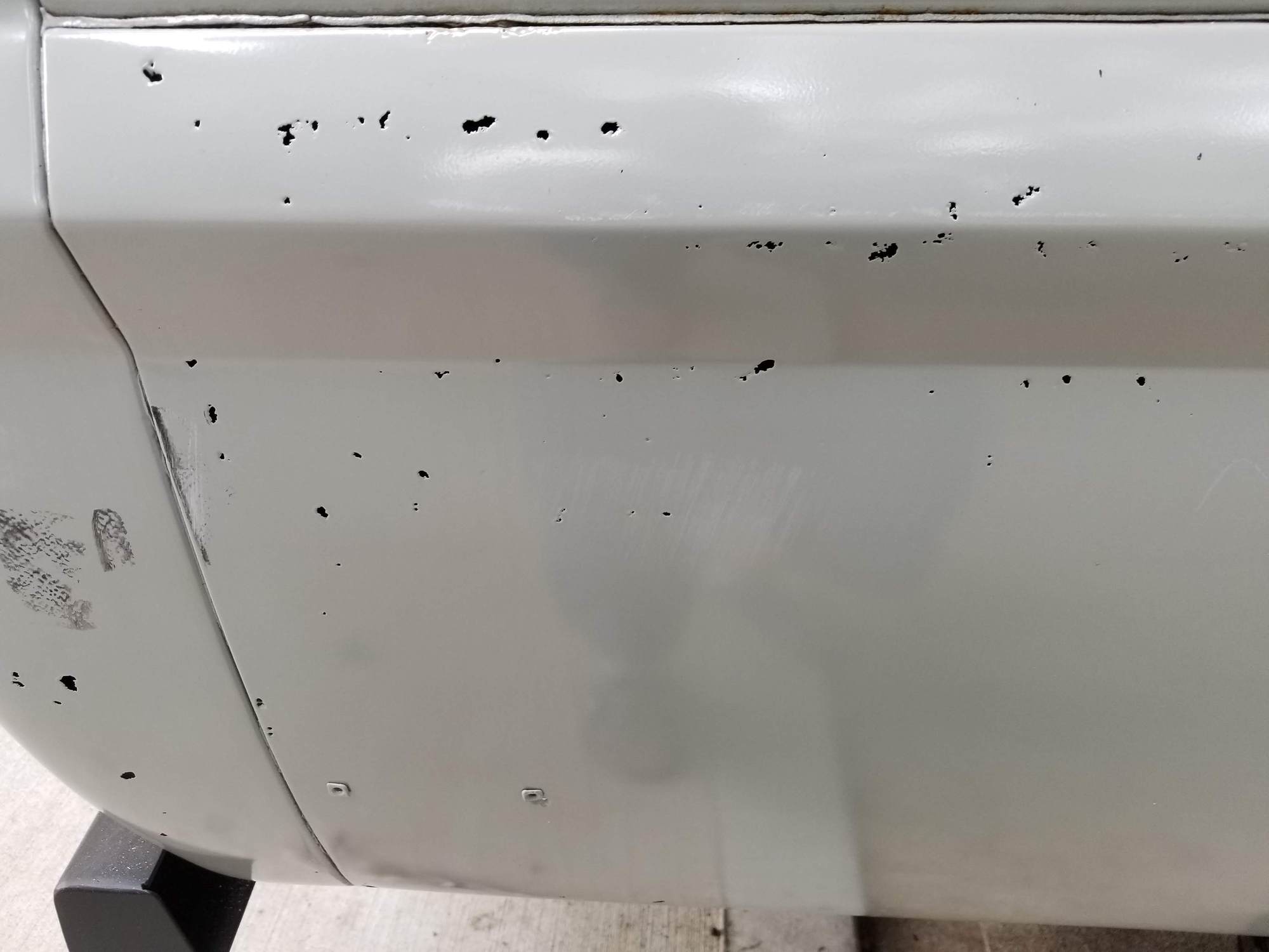

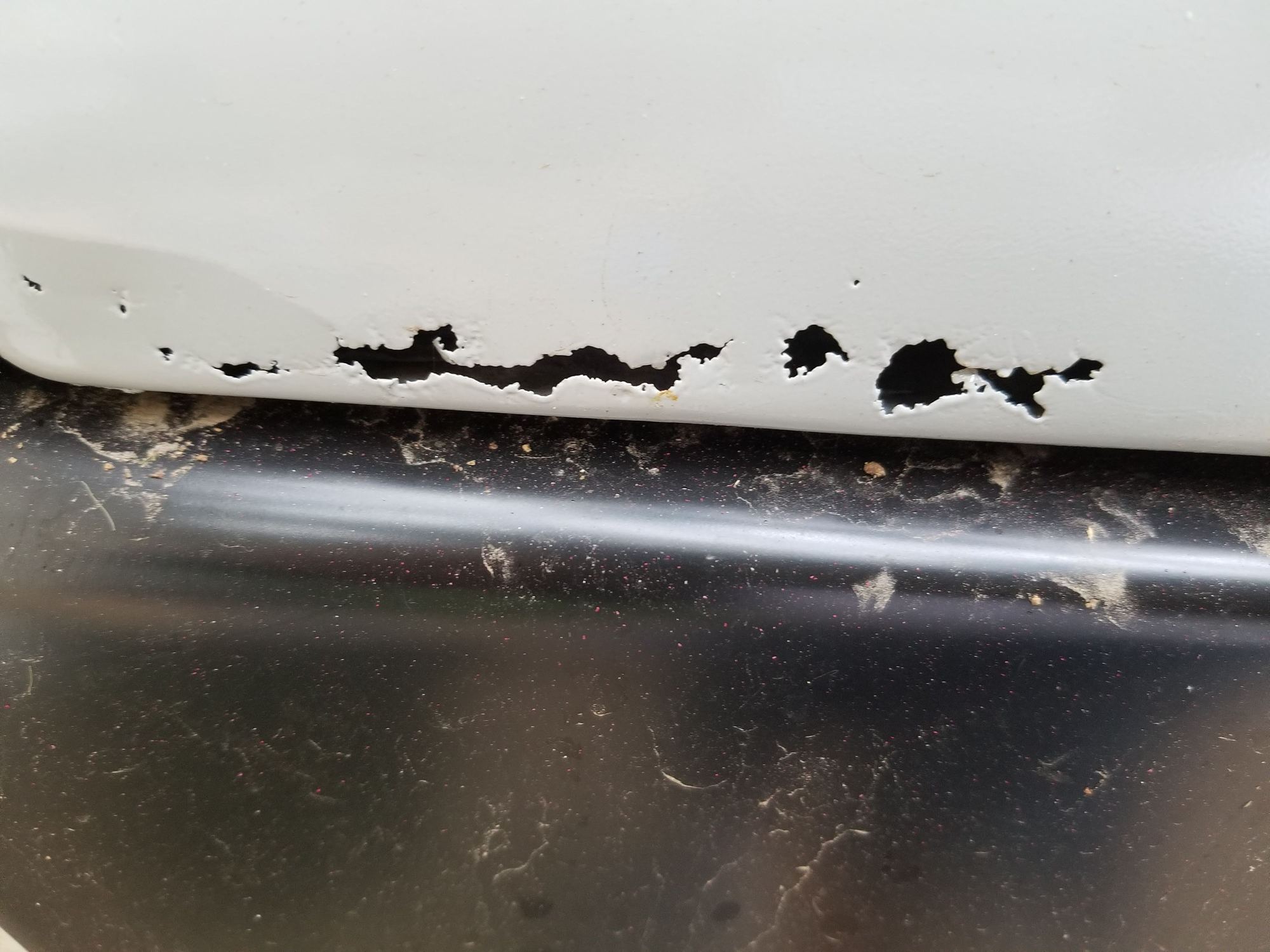

Can someone tell me what is the best way to fix this rust? Should I cut and weld or use bondo? Thanks.

I am no part of a body man but that looks like a lot of work to make right. I will be interested in what others say.

There is only one way to get rid of rust . Cut it out and replace it with new metal,But Not any metal from lmc. Don't ask me how I know this.

Unless you have a lot of time on your hands or just want to fix this specific truck I would find a donor that is solid.
Replacing panels and cutting out old medal and replacing it with new is the only way to fix it with any longevity.
There is not cheap or easy way to properly fix rust. If I am looking for a project I will spend 5k on a solid car/truck vs take a free car/truck this is a rust bucket.

Wow. That has been eaten right through. Is that all the way around the bed, cab, doors and fenders? If so, that would take a whole donor truck or a lot of cutting and welding. Ive never done any body work but I have some replacement doors and fenders for my truck project and two floor boards I have to cut out and replace.

Does this particular truck have any special history or meaning or is this a truck that you are considering buying? If you don't own it, I wouldn't consider it. If you do own it you may want to look for a replacement as the time, effort, and expense will be much greater than a suitable replacement. You can save anything but you have to consider the value - even if it is an emotional attachment. I thought my truck was pretty clean but have many hours in small rust repairs that I hadn't expected.
Might make a good drag race truck, though. There has been a lot of weight removed that in the past would have required an acid dip.

I can't believe you just called Whitey a rust bucket. Anyway, I don't think its really that bad, its been blasted and shot with epoxy primer.

I agree with the others above. Body work is a LOT of work. I just started on my 67 hood and it is way more time consuming than I originally thought. I have three days into it and probably have another week before I'm done - originally figured it was a weekend project. Now I'm afraid to take any of the paint off other places on the truck for fear of what I'll find underneath.
One nice thing on Whitey, I think new fenders are pretty easy to get. Not sure about the other parts.
Good luck.

On body panels look at http://tabcoparts.com/ I used them for my 81 F100 for floors, rockers, cab corners, lower rear door posts and the lower inner & outer left door and was vary happy with them.
They are right the only way to get rid of rust is to cut it out. After you have the panels welded in place you should also use some type of rust converter on any surface rust you come across.
I have found East Wood has some good products for fight rust and depending where the rust is will use different things.
Oh I have had training in body work start to finish. I don't mind the metal work its the body filler I hate!
But I do love the out come after 4 years
