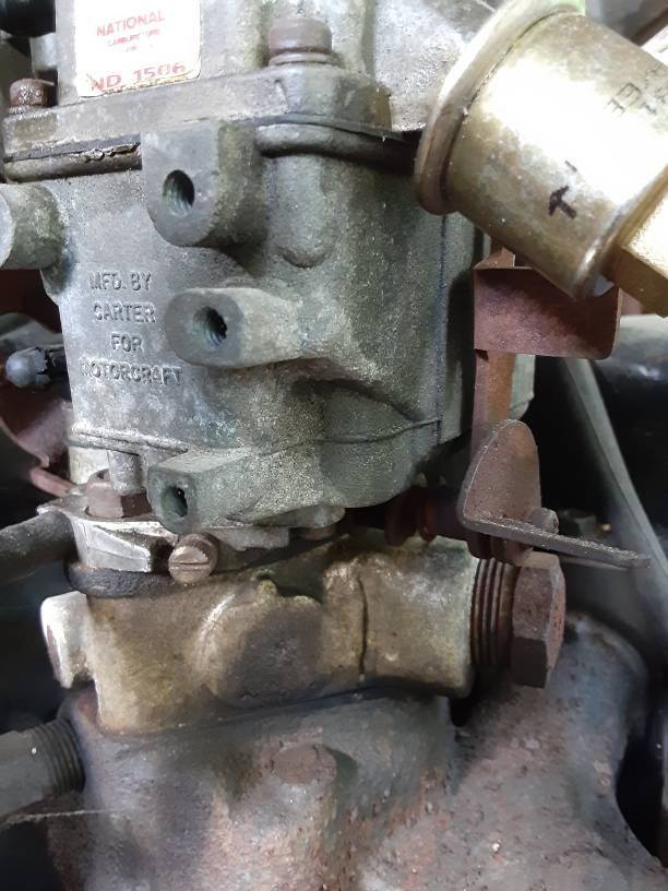

OK, here's a quick follow-up...I pulled the sending unit out & inspected it. It was clean and unobstructed. Lines are fresh,too I forgot to mention that. However, while looking at the carb I found a crack at the base of the carb spacer. Would this cause the evaporation issue that Franklin2 mentioned? Anyone have an idea on where to score a new (or good used) one?

That looks to be, on phone so hard to tell, the EGR plate.
That would not cause any evaporation but could cause a vacuum leak.
There is a "for sale" area down farther could check there maybe ask in the 240/300 motor area if someone has one after they did a v4 manifold and carb swap.
Dave ----

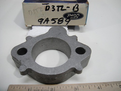

It looks like your EGR adapter plate has been modified. That is an aluminum piece and can be repaired by welding. A few are available on eBay:
https://www.ebay.com/itm/1979-1980-1...-/392847883577
https://www.ebay.com/itm/Carburetor-...kAAOSwPbldSava
https://www.ebay.com/itm/NOS-Ford-Ca...0AAOSwbb5d3pAU
The following is a spacer used on the 300 engine before EGR. A spacer or EGR adapter is required to keep the throttle cable geometry correct,
https://www.ebay.com/itm/NOS-OEM-Gen...IAAOSwyDFd0OQz
https://www.ebay.com/itm/Ford-Carbur...gAAOSwkO5e-niW

What I am talkign about is the large open pipe to the right of the fuel inlet on the single barrel carb in the picture below.
And it Tee's into the canisters under the battery and vacuum is pulled from the PVC with some other valves in place for when the EVAP system is to work.
Thing is I don't have the other valves so when ever the motor was running vacuum was pulling on the bowl vent & canisters.
If it was pulling fumes it could make the motor run rich and why I am getting poor MPG.
With that and now not driving the truck much, to damn hot & no AC, I don't know what all is going on but so far I can live with it and when I get time will check some things.
Dave ----
