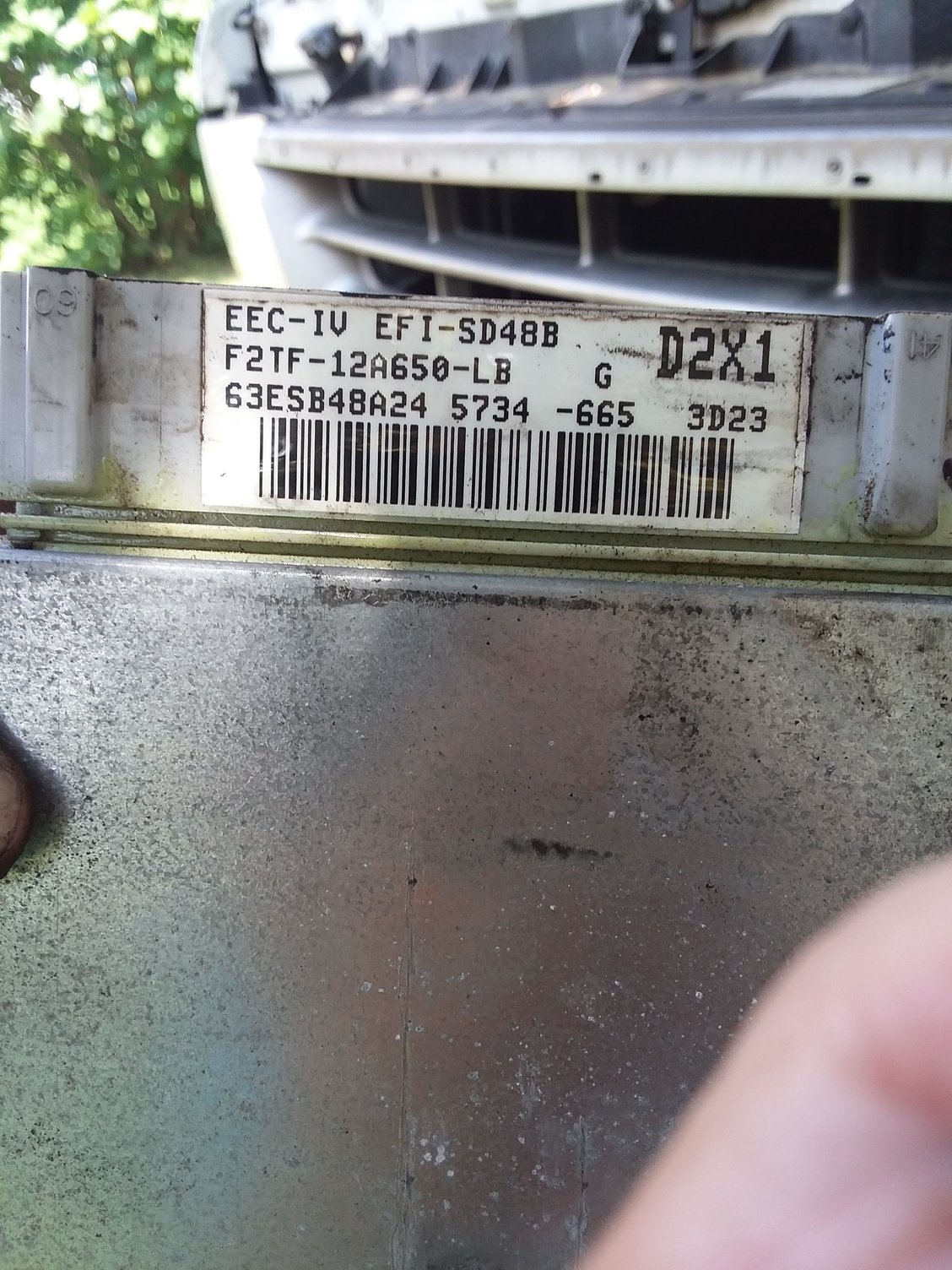

Ughh.. The shop won't even take it until next Wednesday. I grabbed the ECM code off the sticker. Can anyone decipher where I can find a 2-64K-R11 F2AE-6E061-GPD replacement, should I need one?

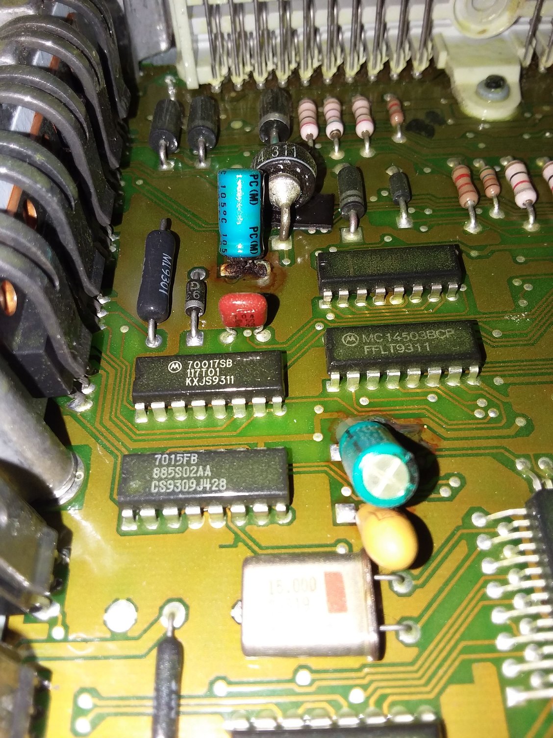

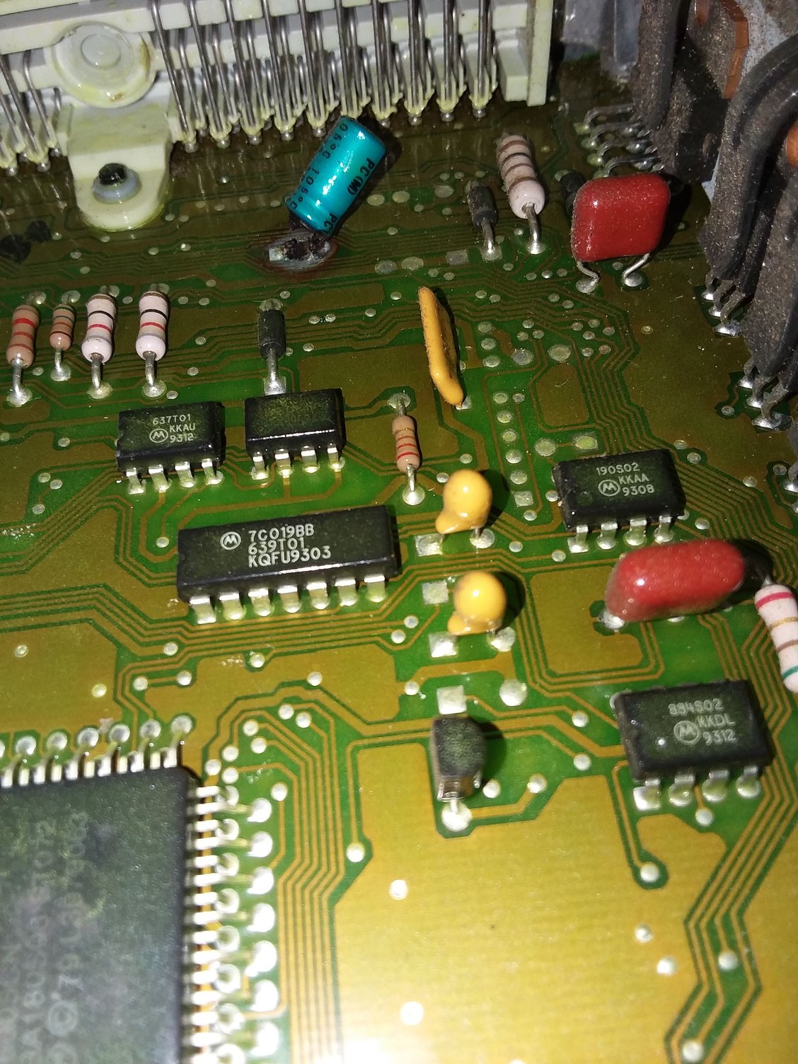

Update: Here is the computer. Three busted capacitors. I will pick up the remanufactured computer tomorrow (F2TF12A650LB Cardone #78-5302). It should be plug n play. <--Hopefully!
Model Number
1. Burnt Broken Cap
2. Burnt
3. Maybe ok cap
