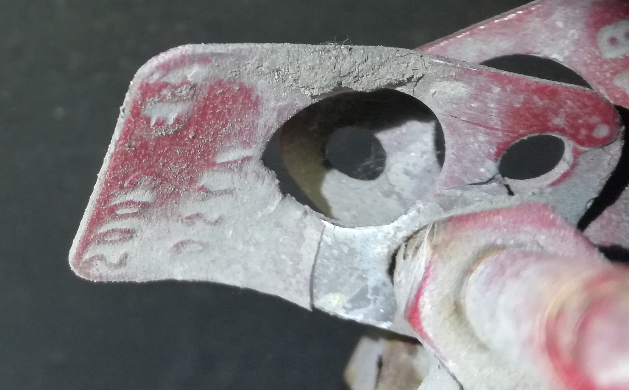

I'll take a look. My truck started with a gas 534, but was converted to a 3208T in the late 80's. I think the trans is an Allison, but I could be wrong. I have no operating lever for a parking brake that I can see.
My booster is a Bendix. The tag on it appears to say 2510085. I looked on NAPA and they have similar hydrovac numbers but not the same. Kind of confused on this one...

That number doesn't come up, but there are a few outfits like this that might could help.

Not sure if this helps anybody, but this is the best picture I could get of the tags. I don' see any casting numbers on the body. The booster doesn't look as bad as I was thinking. How hard is it to pull the hubs off to do the slave cylinders?
