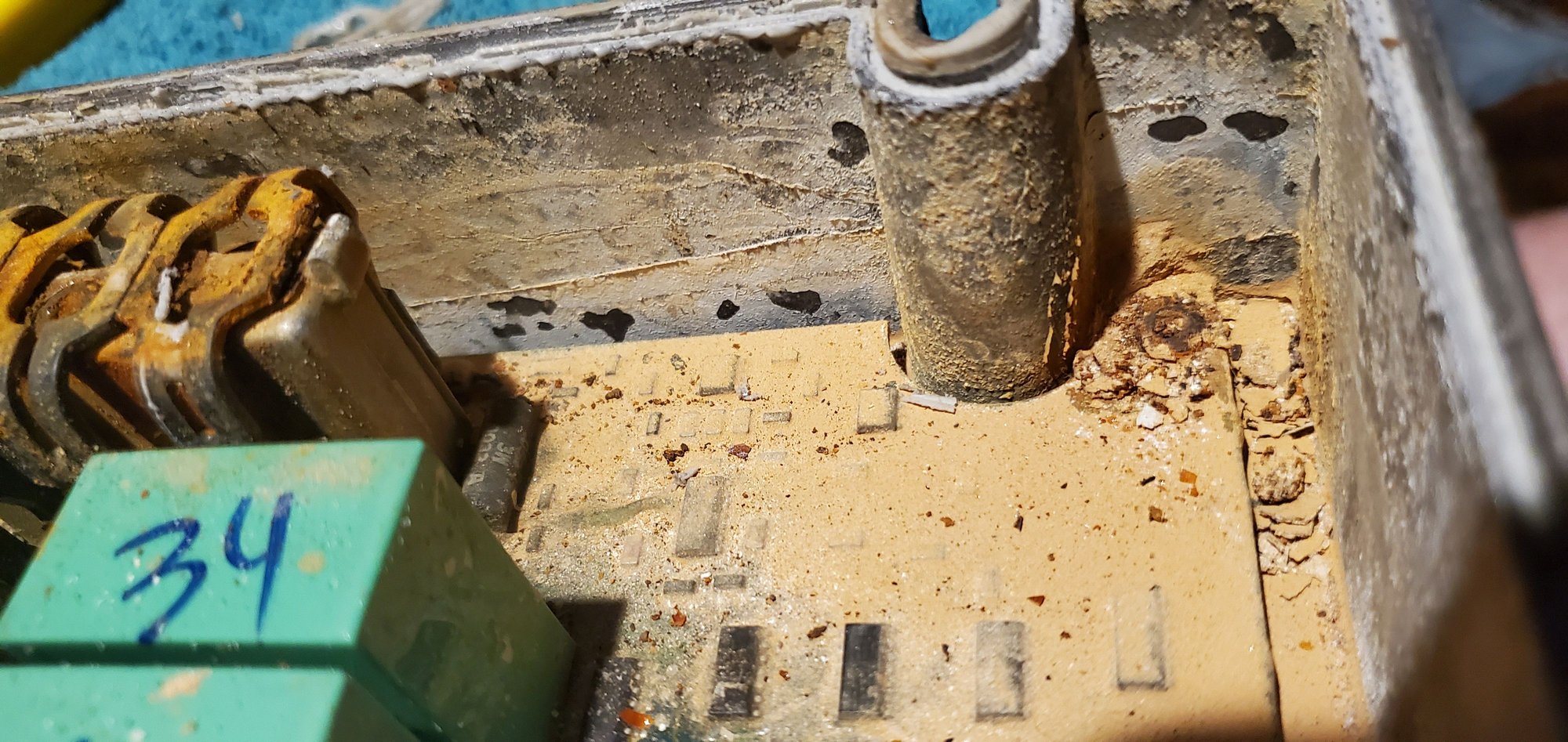

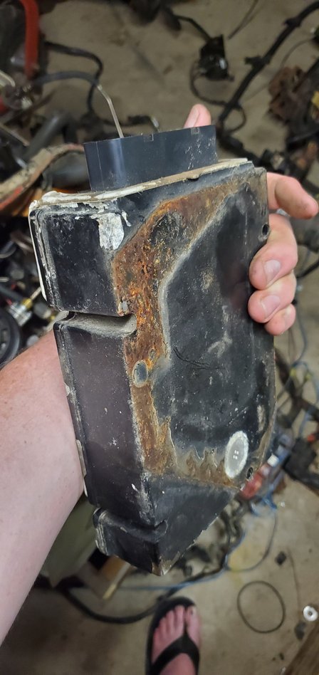

Any FTE members here rebuilding IDMs? If its competitive with buying a 'used working' IDM I would rather support a member.
May be too far gone but if anyone wants to look at it and its unfixable you can keep it for parts
Thanks~James

Water intrusion, she be toast.
RAE has stock and high voltage reman IDMs for good prices.

Thank you, Looks like these things were mounted harness up in the vans so they could take random baths

There was a tsb on these getting wet in ambulances. I never could actually read the tsb but my hunch is they need to be covered from water rolling down the windshield.
on Redford i used a pc of flashing from the box store. Drilled 2 holes for the fender bolts and used those to hold it on. I did fold over the top corner so it did cut up the supposed seal. Also used some silicone on rh top side.
