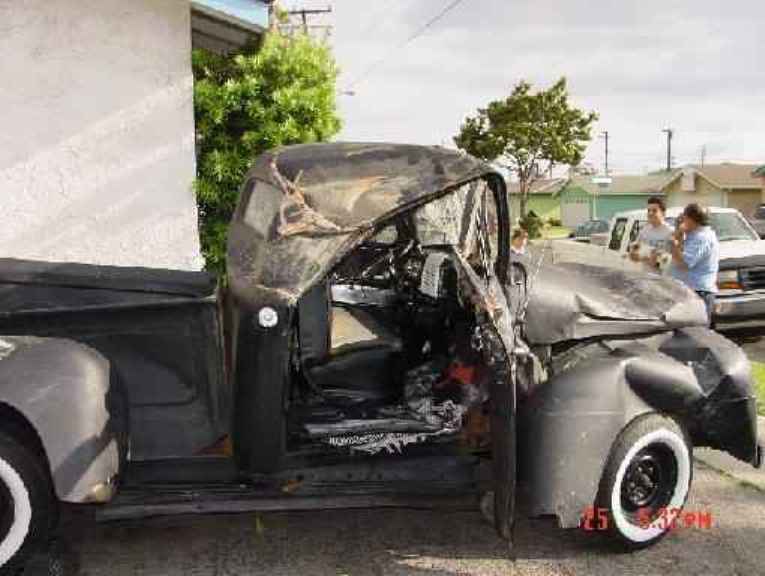

This truck was posted by a member on the HAMB a long time ago. He was in traffic on a SoCal freeway, got hit and it rolled a couple of times, went into the guardrail and got hit again by other cars. It didn't explode or catch fire. Look at the damage, the area around the tank (lower back of cab) is hardly touched. There is more steel reinforcement under and behind the tank than anywhere else in the cab. The tank sits on a major structural member. I have never heard sloshing, people who do need better exhaust (Smithy's). No gas smell. It's not a bad location IMO.

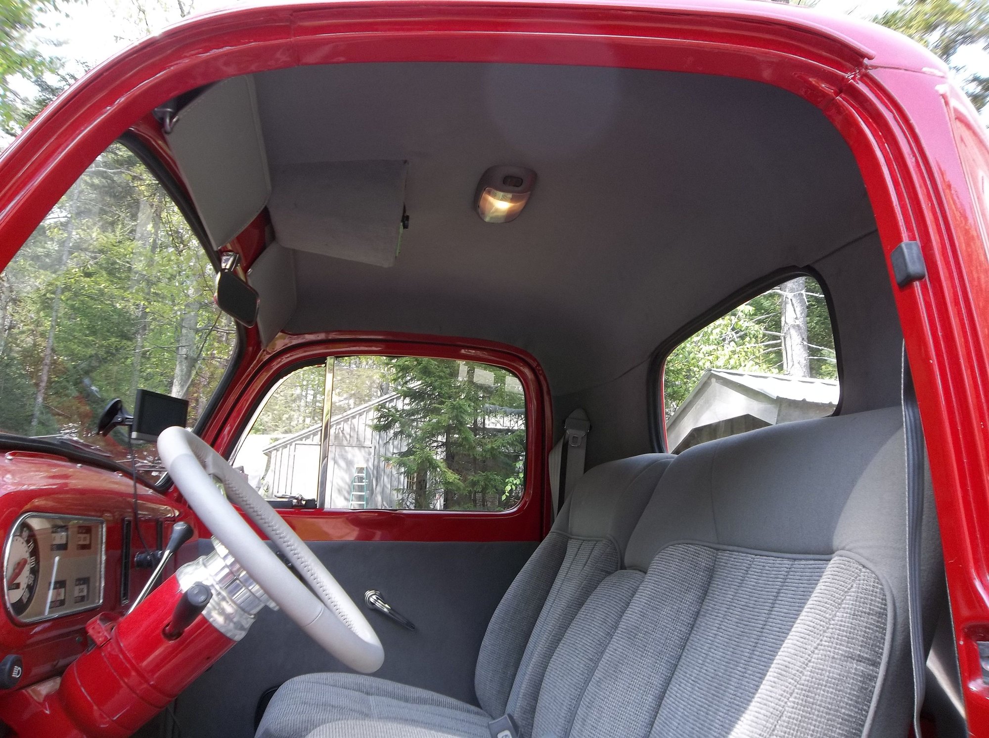

Moving the tank from behind the seat, at least in a Bonusbuilt cab, will not provide more leg room with either an original seat or a replacement seat. The reason as the seat back will hit the back of the cab at the top before contacting the tank. If you installed an old true straight back chair in the cab it could provide more legroom, however that would not be a very comfortable ride! Car seats are always tilted back on both the lower seat surface and the back seat surface. In the pic below, the original tank is there and there is space between the seat back and the tank.

I don't think you would gain any leg room in a 56 either, the seat back hits the back wall before it would contact the tank..it's just wherever you feel comfortable with where the tank is. What you gain is storage behind the seat if the tank is moved..
