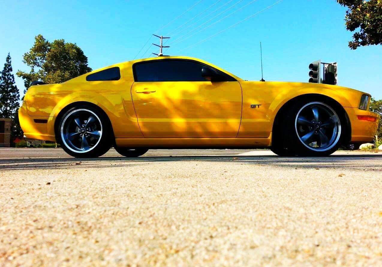

I just bought my first truck on Tuesday the 23rd, a 2001 F250SD. But, I have a background in competitive motorsports and grew up in a restoration shop, so we have done lots of gear swaps. I was happy to find a 5.4 2-V with a 4.30 axle. I put 4.10 or 4.30 in everything anyways. I even put 4.10 in Mom & Pop's Mercury Grand Marquis (when the diff had a noisy bearing) and didn't tell them anything, just re-calibrated the speedo. They are surprised at how much "better the car runs" and it's pulling better MPG.
People will undoubtedly say "Well, you can't apply that logic to a truck."
Maybe not directly, but to properly understand axle ratios, you must take into account both the transmission overdrive ratio and tire diameters, which result in your Final Drive Ratio or FDR.
Example:
One of the first things I did in my daily-driver, stick-shift 2006 Mustang GT was put in 4.30's. I picked up a consistent (over 30 tanks of fuel) 3-5 freeway MPG after the swap and even better in-town MPG numbers. In stock form, the 2006 GT has a 3.55 axle. Combined with the .068 overdrive of the TR3650, that's a lug-worthy 2.41 in 5th gear and a 281 CID V8 doesn't have the torque to pull such a high gear efficiently.
With the 4.30 gears, and the TR3650's .068 overdrive ratio, that equates to a 2.92 final drive ratio (FDR) in 5th gear.
