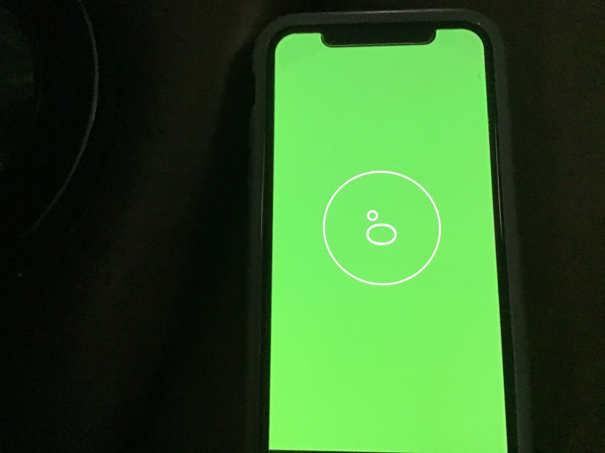

My RV has no leveling bubble from the factory. So I have nothing simple I can use to determine if the RV is level.
I used two beam levels on my last outing. A 4' beam level and a 2' beam level, both using bubble vials. No two surfaces in my trailer agree on what is level.
Should I be using the sidewalls to determine side-to-side level? I tried that but liquids in pans on the stovetop drain to one end of the pan, and the tub doesn't drain quite right.
To determine front-back level, I put the 4' level down the middle of the trailer, parallel with the frame. That worked OK, but it still felt off a bit.

I have bubble levels, beam levels, level app on my phone, glass of water, etc. It's my dang RV that doesn't have any 2 places that agree on what is level. The floor in RV seems to have a crown on it. I tried the phone on the floor and wow was it bad!
Choose your battle then, pick one of the liquid locations (stove, tub...) and get that level both ways and stick on a set of the RV bubble levels mention above, that way you can easily get back to that same level point with decent repeatability. I would focus on the tub personally, the stove may be able to be shimmed to make it level with the new tub zero bubble.

The door to the bathroom wouldn't stay open last weekend. That was one indicator that it wasn't level. I suppose I could use the door frame as a point of reference to see if it is straight up/down. Similarly, I know if the outside door binds then my leveling jacks aren't quite right. Since it's a toy hauler, I would expect it to not flex much, but maybe it does.
Given the lack of anything in the trailer being square, I'm not convinced that the sidewalls are a good place to determine if the trailer if vertically straight or if it's leaning.
