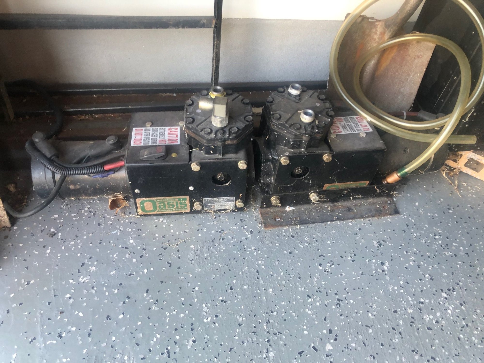

Originally Posted by 1qwktrk
oasis compressor. basically an electric motor driven york
I have two of those on my garage floor collecting dust. The motor's both started pulling WAY too many amps (over 200) and Oasis wanted $700 to fix one. I had one mounted on my crawler and one in my overland truck.. both motors crapped out within about a year of each other. I just went with the ARB dual compressors. I want to get another for the SD. But those Oasis compressors are beasts!! I should go find an auto electric shop and see what they can do with them.
I'd make you an offer for em, but I'm not near Texas at the moment.
Can you convert them to belt drive and mount on the engine?

Probably cheaper to just get an old York AC head from a scrap yard and make a bracket. They are monsters though, weigh close to 50lbs a piece, capable of 9CFM at 90 PSI. Part of my issue with sending them back for repair was they were going to put new motors on them, which is great, but the new motor was about 4" longer so putting them back in the spaces I had allocated for them was not an option. Mine are the 1000 series IIRC.. only model they sold back then. They ran about $1300 a pop when new about 12-13 years ago. They have a couple newer models if you are interested.
Well that's a little dis-concerning... I have one hope it doesnt die on me. thing was expensive.
Well I hope you have a newer one. Mine didn't get used a lot, airing up tires basically. Oasis has since put a fan on the end of the motor so that should help with longevity. FWIW, the one on my crawler was in open air (stretched metal around it) and the one on the overland truck (a Tacoma) was in a tool box in the bed with airflow around it, lid was open during usage. Also, mine lasted about 4 years, and I did change the oil in them even though I doubt I hit the 50 hours of usage for an oil change.
