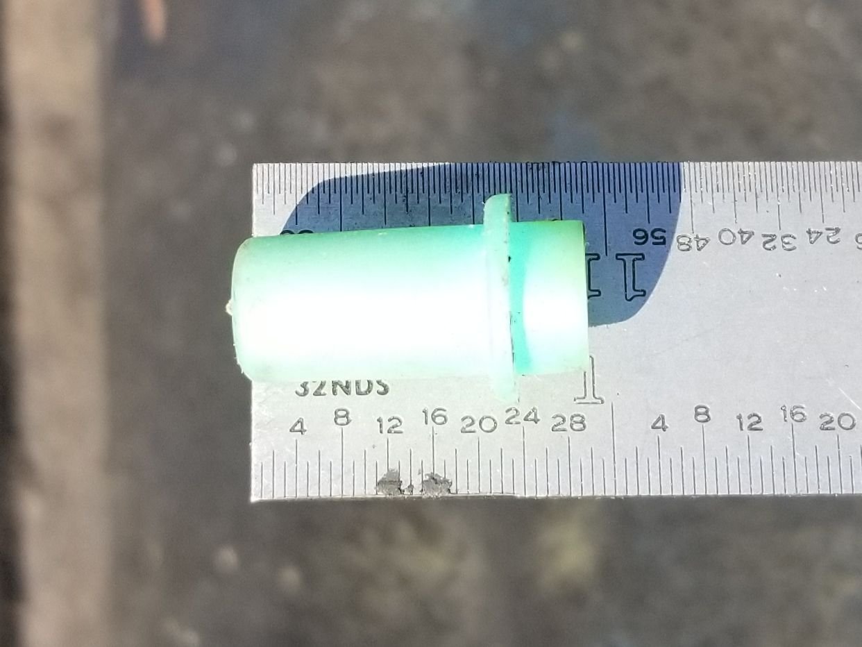

Also I forgot to mention when I unplugged the harness on the passenger side this cap/plug came flying out. Is it anything or just some random junk?
If dimensions match, it may be a shipping cap from something like an HFCM like this one .

Yep thanks that's what it appears to be.
