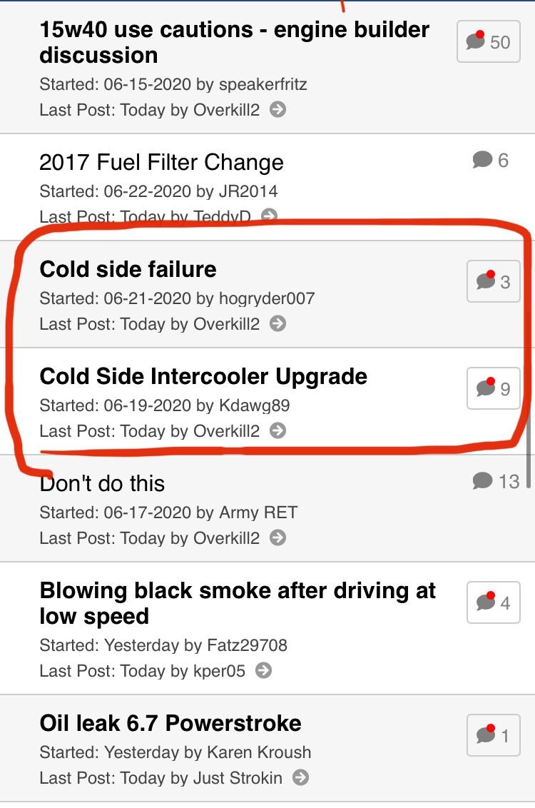

How fitting that these threads are right beside each other lol

Not anymore
Thanks Captain Obvious. Somebody's gotta be nice to the new guys.
Old Jun 24, 2020 | 06:22 PM
TeddyD's Avatar
TeddyD
Joined: Jan 2019
Posts: 3,422
Likes: 20
I wasn’t being an ****. It’s not very often you see the solution right below the problem. 😀
Old Jun 24, 2020 | 06:47 PM
Overkill2's Avatar
Overkill2
Joined: Mar 2017
Posts: 31,962
Likes: 9,194
From: Western NY
Sorry couldn't help myself. I see your point.
Old Jun 24, 2020 | 07:10 PM
TeddyD's Avatar
TeddyD
Joined: Jan 2019
Posts: 3,422
Likes: 20
I would of done the same thing 😂
