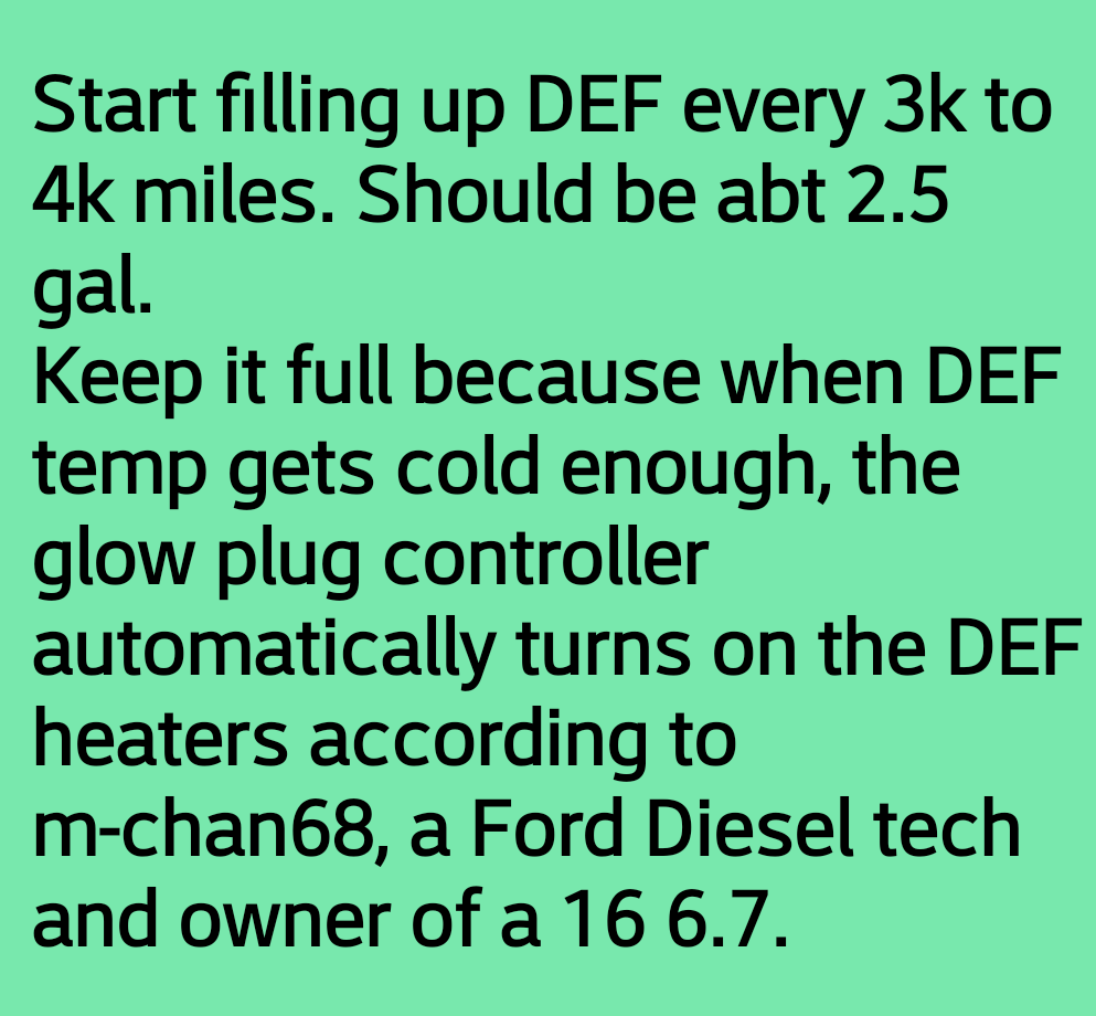

You're correct that I can't speak for all the 6.7 Fords but enough people post on here that they have their DEF in-tank heater go out. I have let the truck go to the 500 miles warning but once I started thinking about and saw that from a Ford factory tech, @m-chan68 I wanted to prolong my heater's life if possible. I tagged him here so hopefully he will respond. I have never had any DEF fill level sensor problems by keeping the tank topped off. Maybe I'm not correct about the DEF heater coming on in the warmer weather, but I thought I read that when the glow plugs light off, the DEF heater comes on because it's on the same circuit. m-chan68 can correct me.
I keep notes on my cell phone. Here's the one:

I believe you are correct about the def heater coming on during the glow plug cycle. It does a self test during every key cycle if I recall correctly, just to check that the current draw to all the def heaters are within spec.
When my def tank heater failed, I'd get the fault code, and no matter how many times I cleared it, It'd keep coming back after a key cycle, even in warmer weather. This seems to me to imply that the self test occurred even in outside temps above freezing atleast.
My Def tank heater failure was due to me filling the tank full in the winter, by the way. I filled at the pump until the pump shutoff, then drove 100 miles and parked the truck for the night. Theory is that the def froze in the full tank and expanded enough to damage the heater. I now intend to never fully fill the def tank in the winter months when it'll get below 12 F.

I fill up with the factory fill nozzle that prevents over filling so it doesn't freeze and crack the neck in cold weather. I even use it in the summer.

The factory fill nozzle prevents overfilling spills, not overfilling in regards to freezing. It'll still fill the def tank up into the filler neck, which is too full in freezing weather. I use this nozzle too and its nice to prevent spillage that can damage paint, but in the winter, I have to make sure to stop before the factory fill nozzle stops.
