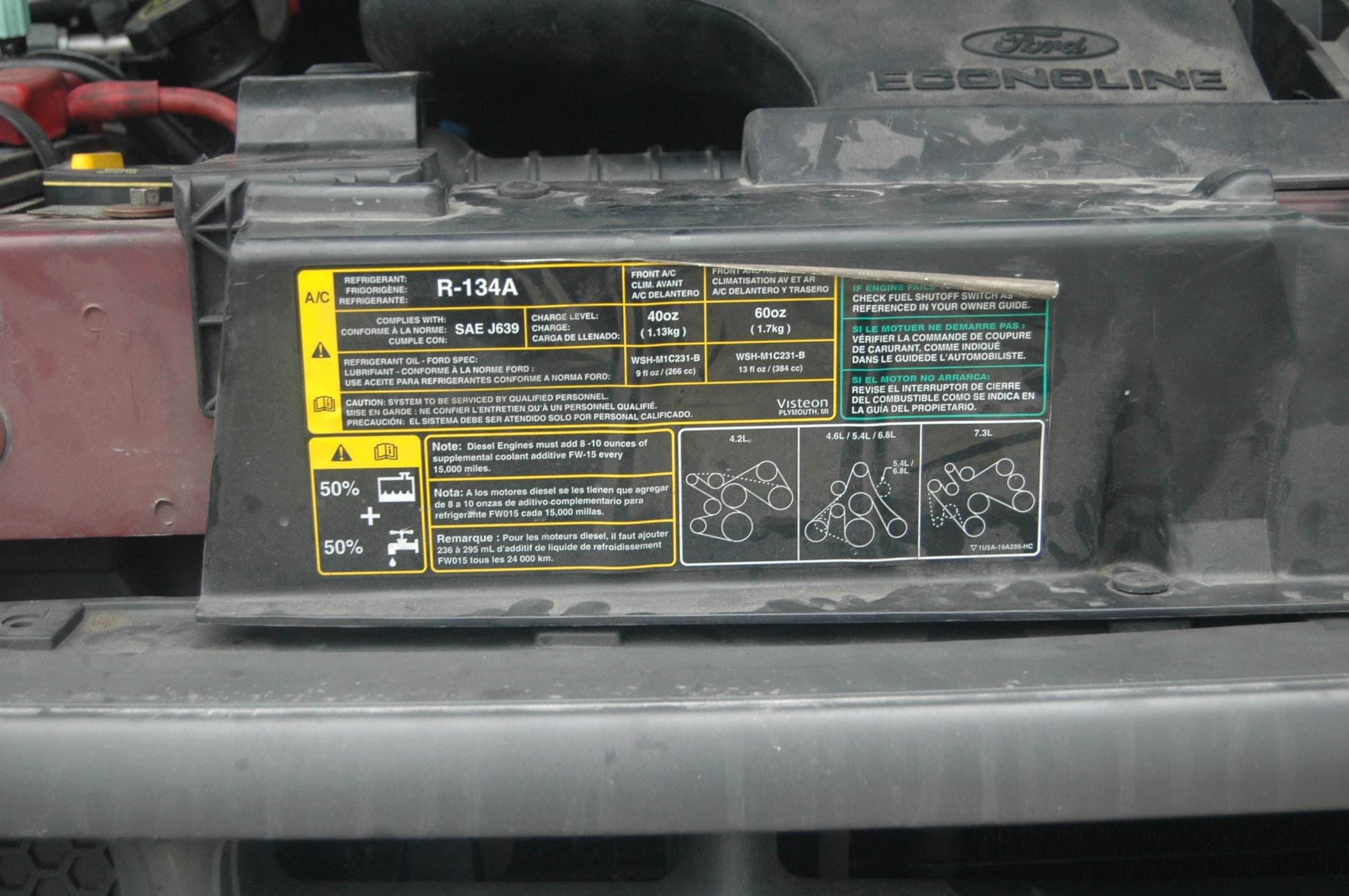

Let me second the idea of using new OEM parts---once you have the Motorcraft part numbers finding what you need or want can result in a considerable cost savings. I have an extended body E350 Club Wagon that came to me with the rear A/C which I immediately disabled and removed most of those parts. I had to replace the receiver/dryer, the high side hose and changed the FOT just for grins as well as the Schraeder valve core stems and caps. We won't talk about an "lost" Snap On 3/4" combination wrench that took out my original condenser---that one still hurts.
Originally Posted by pbarsoum
My "03" E-350 Super Duty holds around 3lbs of R-134 but if you have a Club Wagon with rear air, it's obviously going to hold more.
A/C System capacities are (or should be) clearly displayed under the hood on the plastic trim panel covering the radiator & condenser mounting areas like this:

JWA, those 3/4" Snap On Combination wrenches are really expensive!

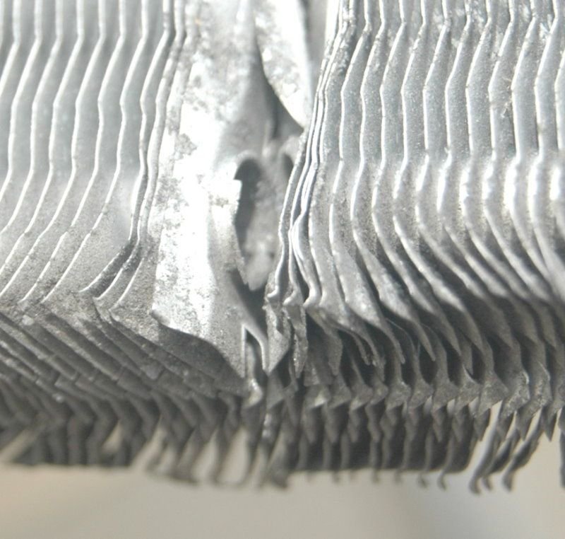

I got off kinda cheap though---the replacement wrench was a mere $55 but it'll last a life time of my limited use; have a friend in the new aftermarket radiator business so he hooked me up with a condenser for $95 out the door. Evacuating and recharging the system was basically free but the customer's shop who did that work just asked me to give them a discount of some sort next job we did---I deducted $60 and bought the shop lunch.
And yes I did use an aftermarket part ONLY because I wasn't sure the condenser had a leak, didn't want to replace it without a good reason, had guessed and feared there was another leak in the system or a failed compressor. During removal though I found this:
Come next summer and fingers crossed there are no issues with the A/C this summer I'll probably replace the Chinese condenser with an OEM part as I notice a tiny bit of reduced efficiency with the current part. That'll be about $300 from dealer or through eBay private seller.
