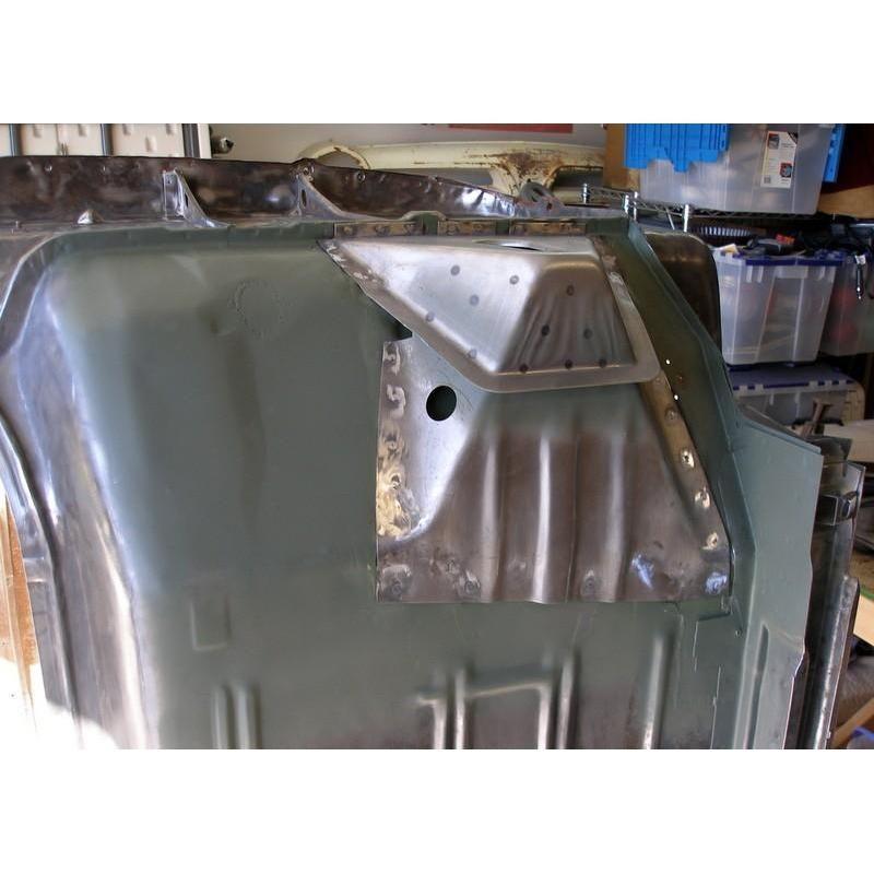

Here are the front cab mounts used on straight axle cabs:
....and here are the mounts used on Twin I Beam Cabs.....
May I ask what has you considering such a swap?
