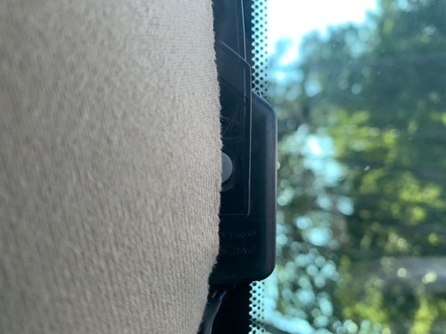

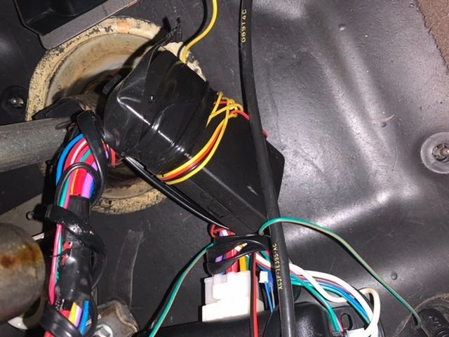

What is this box
Old Jul 14, 2020 | 05:22 PM
LandR's Avatar
LandR
Joined: Jun 2020
Posts: 112
From: Raleigh, NC
And this?
Old Jul 14, 2020 | 05:32 PM
ArmyRover's Avatar
ArmyRover
Joined: Nov 2018
Posts: 285
Likes: 12
From: Fort Gordon
Originally Posted by LandR
What is this box
Looks like part of an aftermarket alarm system
Old Jul 14, 2020 | 06:16 PM
LandR's Avatar
LandR
Joined: Jun 2020
Posts: 112
From: Raleigh, NC
That was my first guess. Which leads me to my second worrying question.
when I lock the doors using remote fob, if I press they keypad 3-4 it unlocks the vehicle. Repeat pressing the fob and come back ten minutes later and I can unlock the vehicle just by pressing 3-4.
in other news double tapping the unlock fob button remotely starts the vehicle.
Old Jul 14, 2020 | 06:42 PM
ArmyRover's Avatar
ArmyRover
Joined: Nov 2018
Posts: 285
Likes: 12
From: Fort Gordon
I guess it would all depend on what they did to the wiring. You have Rover's you know as well as anyone how bad wiring causes craziness.

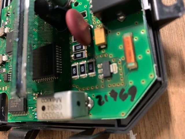

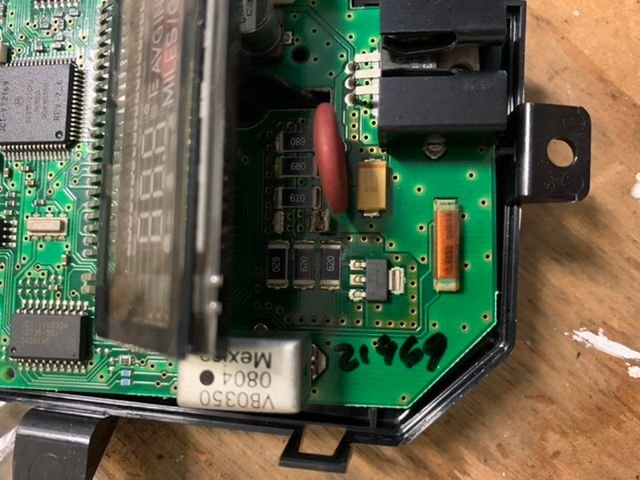

Easier than expected
First real item that is getting taken care of - fixing the trip computer. Took 11minutes from start to finish. A lot easier than the European cars that I am use to working on.
See that 680 resistor that is standing up
And now horizontal with a dot of solder adhering it

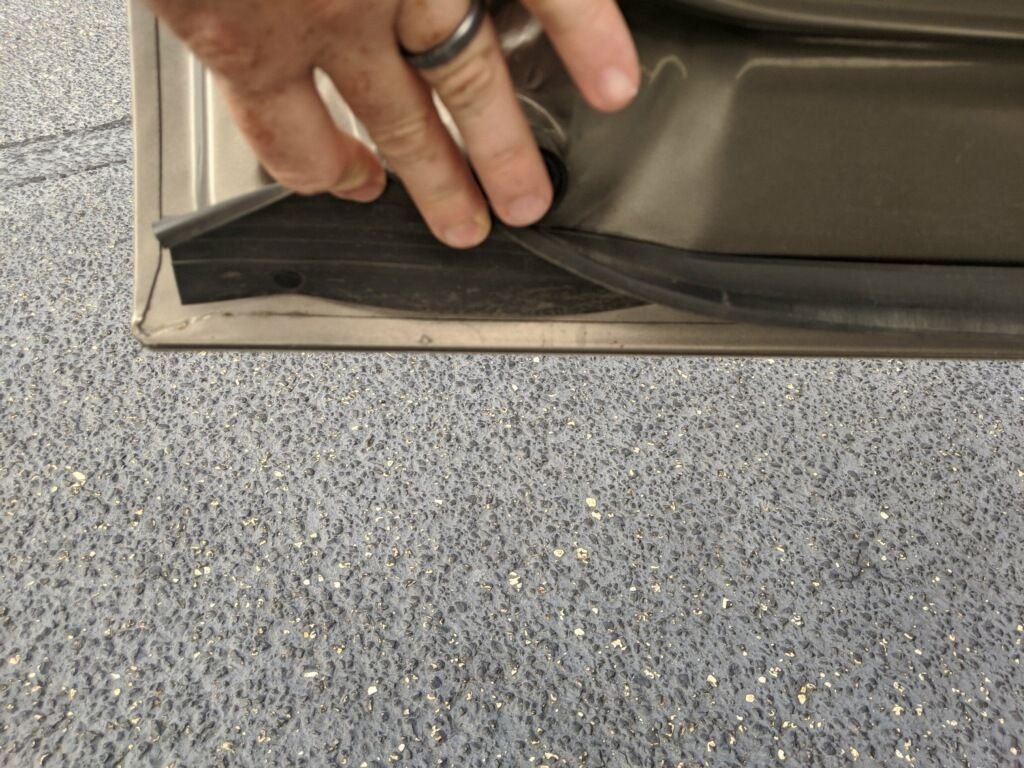

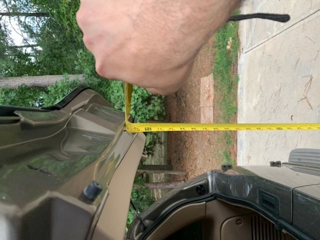

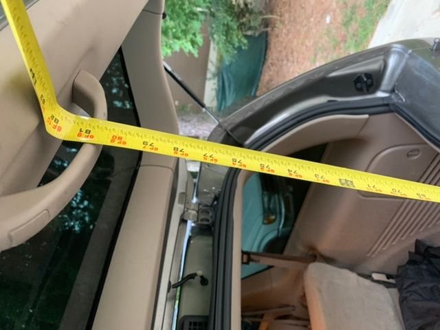

Head Bangers Ball
I was surprised at how low the door hatch opens. A quick fix easily solved alone and in under 10 minutes.
a shame as the old struts seemed fairly new with a bit of white grease still visible on the ball.
you can also see the new bumpers on the hatch lid. I’m not particularly thrilled with them as they tend to pop out. May need a dab of caulk to hold them in place
A wimpy 72 inches
Much better

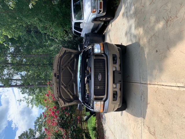

Guess the new one
Headlights had silver stars. No comparison to OEM. Did the fog lights too but they aren’t illuminating. Will be checking wiring soon.
