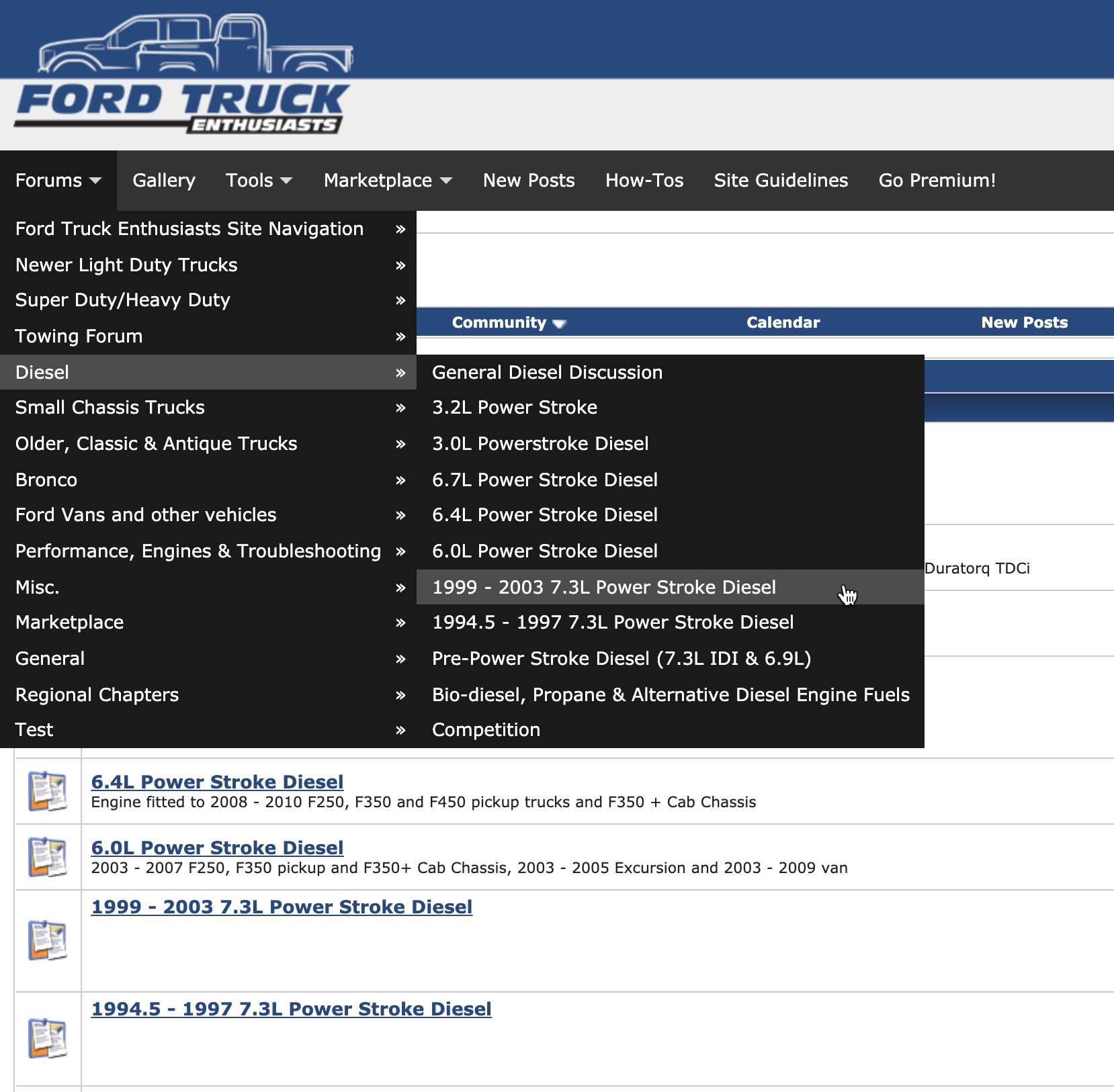

@brente91
Welcome to the FTE.
FYI, You have posted in the Excursion sub-forum. You might get quicker/better responses if this thread is in the right engine specific sub-forum. Please let us know what year 7.3 it is, and we can point you to the proper subforum.
