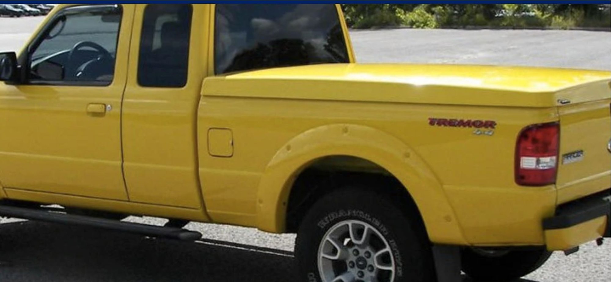

Dont forget about the Tremor sticker. 😂

Ah yes, silly me, cant forget the sticker.

😂 Too funny.
