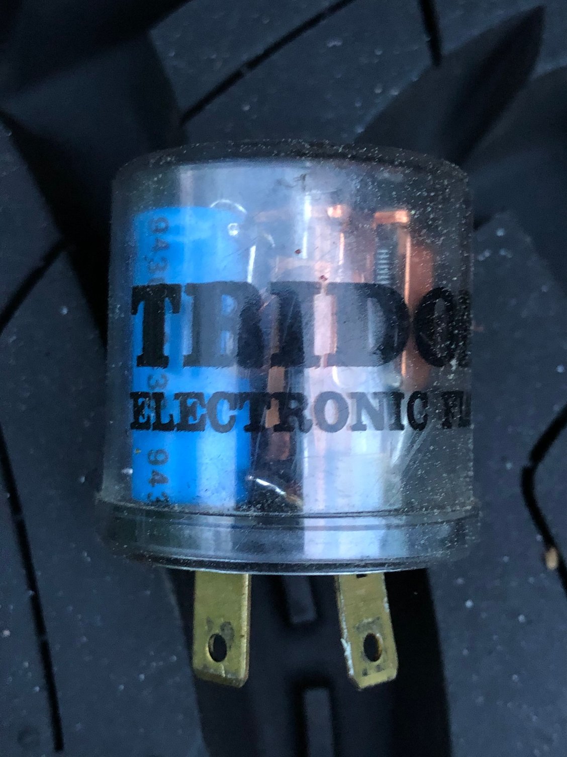

Well I swore I would NEVER do a cab swap again...but stupid me went and did it again.
previous ones were 2nd gen Dodge Rams.
Well not just the cab. Entire truck. Fenders doors bed and Rad support.
So I’m at the point of throwing in the dash.

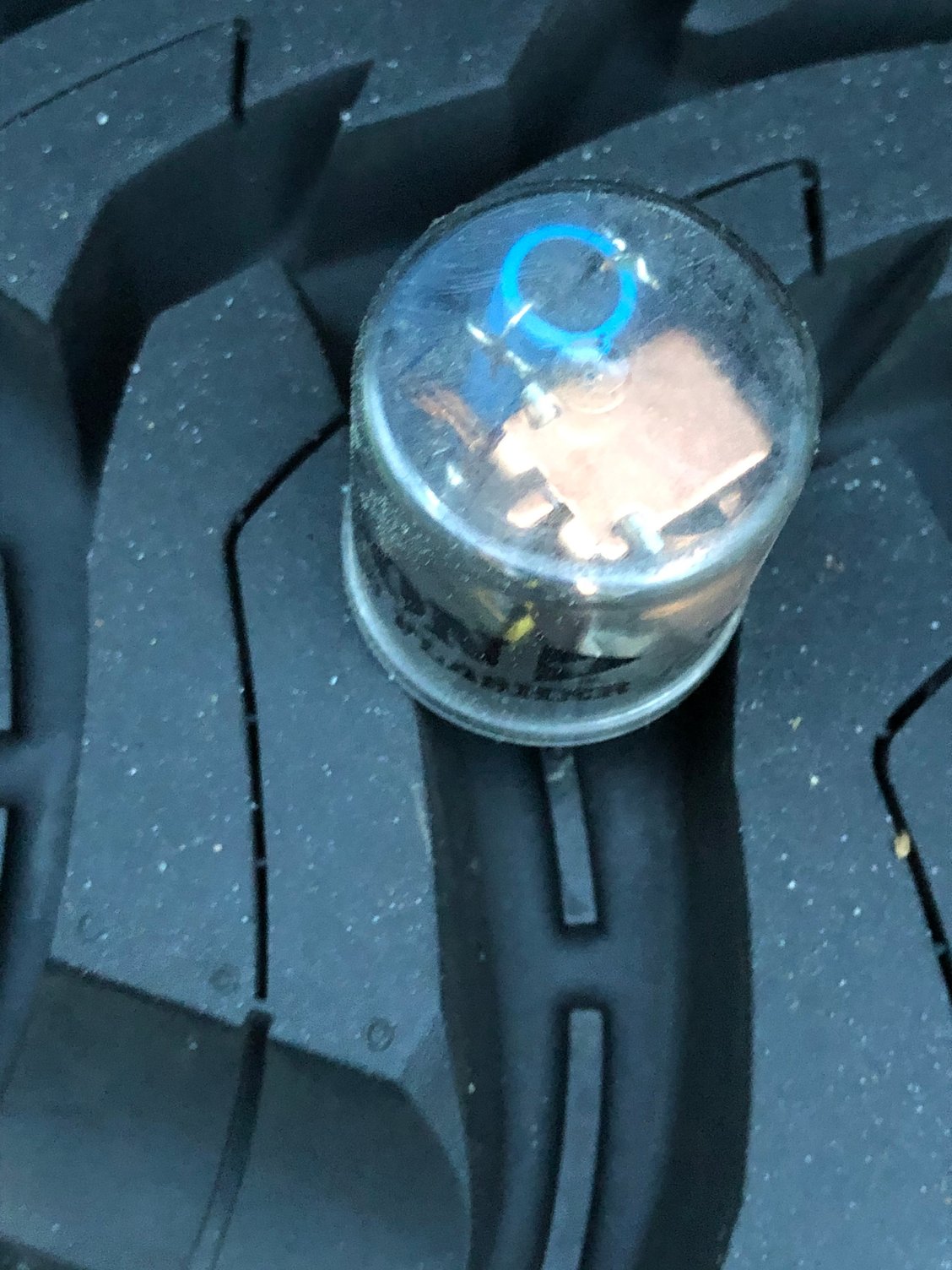

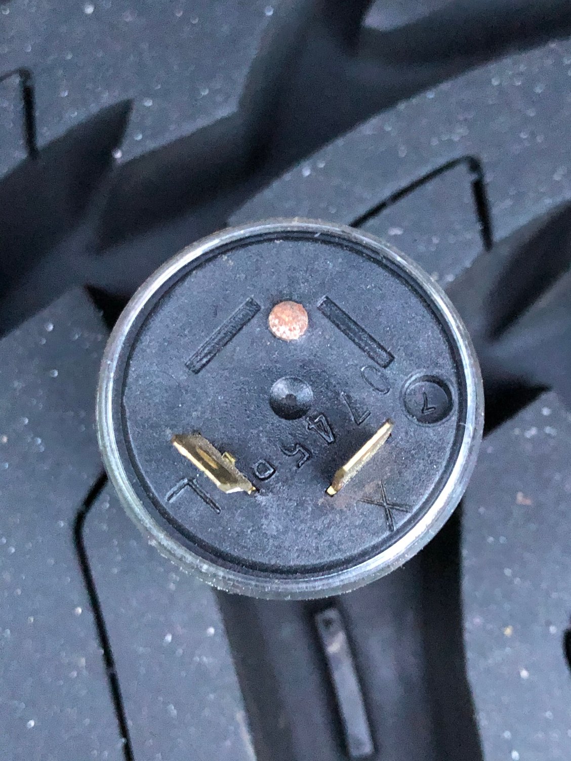

while doing so this part fell out and I have no idea what and where it came from.

Looks like a flasher

And not a stock one. OE were metal case.

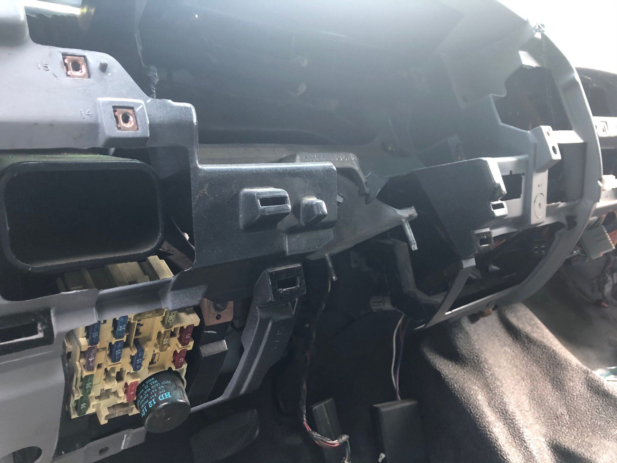

Agreed, that it does look like a flasher. You should be able to pop open the cover to the left of the steering wheel and find where it came from.

Flasher relay.

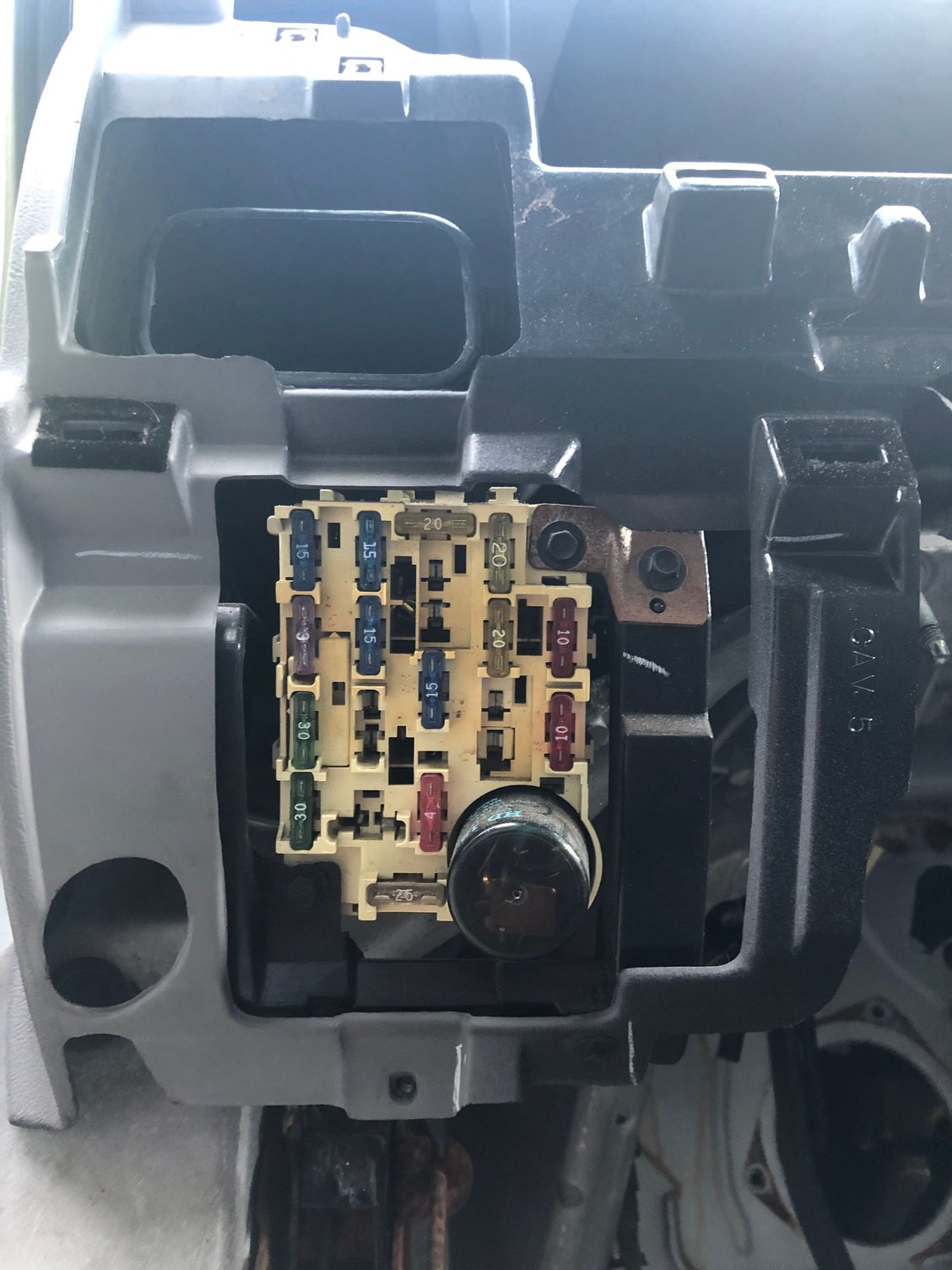

still not finding a spot for it.

Poke your head to back of fuse block. I recall front for signals and rear for emergency flashers.

Heavy duty version so it won't over heat with a trailer attached. When your out changing a flat with idiot cars going by at 80mph you need the blinkers working!
