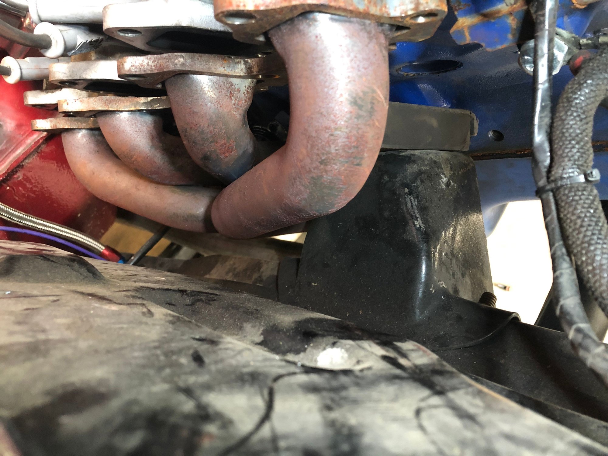

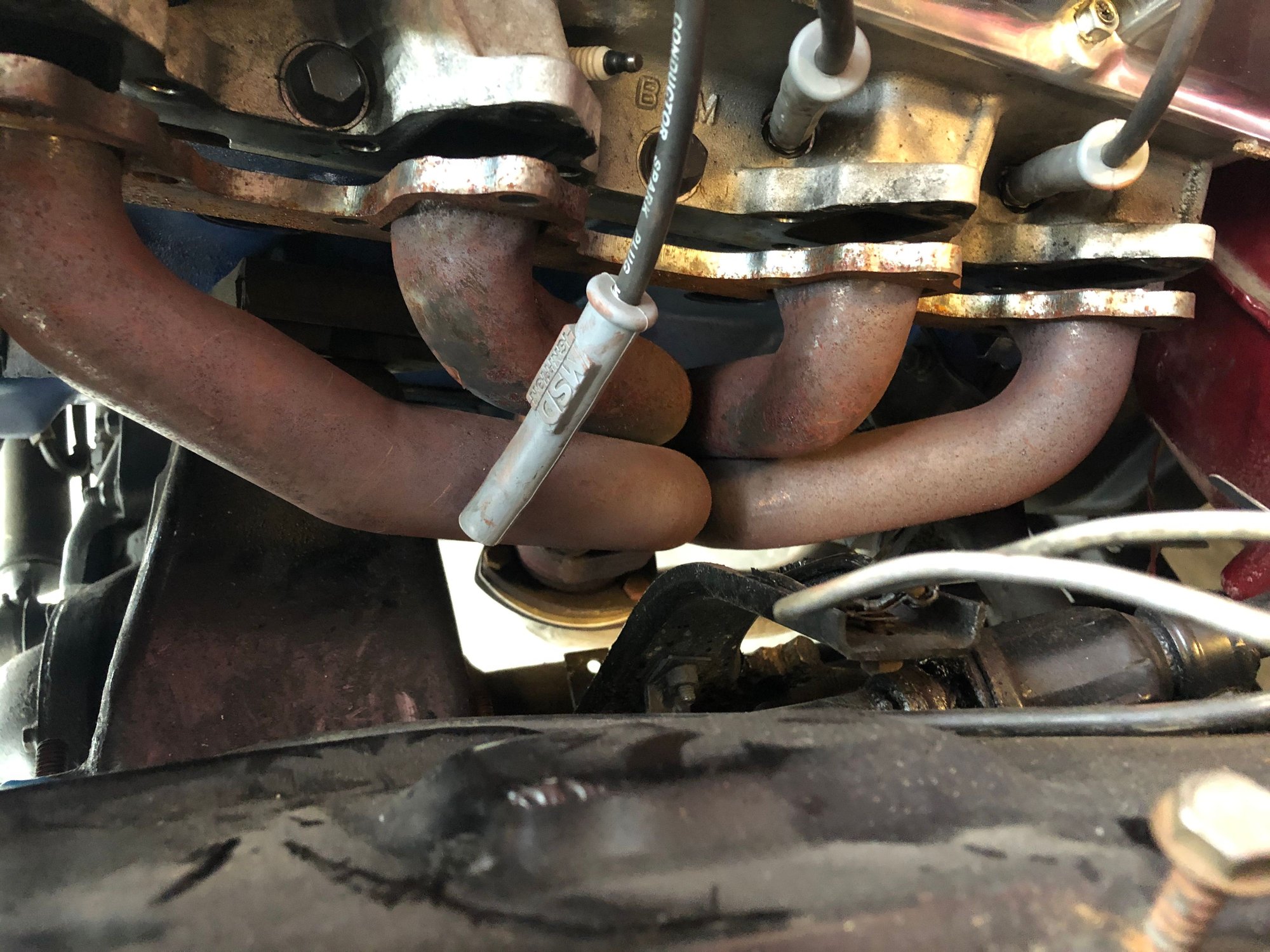

I can send you pictures of Sanderson shorties on and F100 4WD, can't say anything about your setup.

Yellow truck if you could post some pics that would be great.

No problem, just stepped out to the garage and snapped a couple. My master cylinder and brake booster are out right now so I'm pulling them to blast and coat them. I also had some exhaust leaks. In any case also a good time to take pictures where you can actually see.
I had a muffler shop make the extensions - I used to have a set of long tube but there are no long tube that work with the Cobra Jet style exhaust ports on my BBM heads, so went with Sanderson plus an extension. I did learn that you should listen to Sanderson and NOT the muffler shop.
The muffler guy insisted he had to use gaskets, and they leak. Use silicone as recommended by Sanderson.

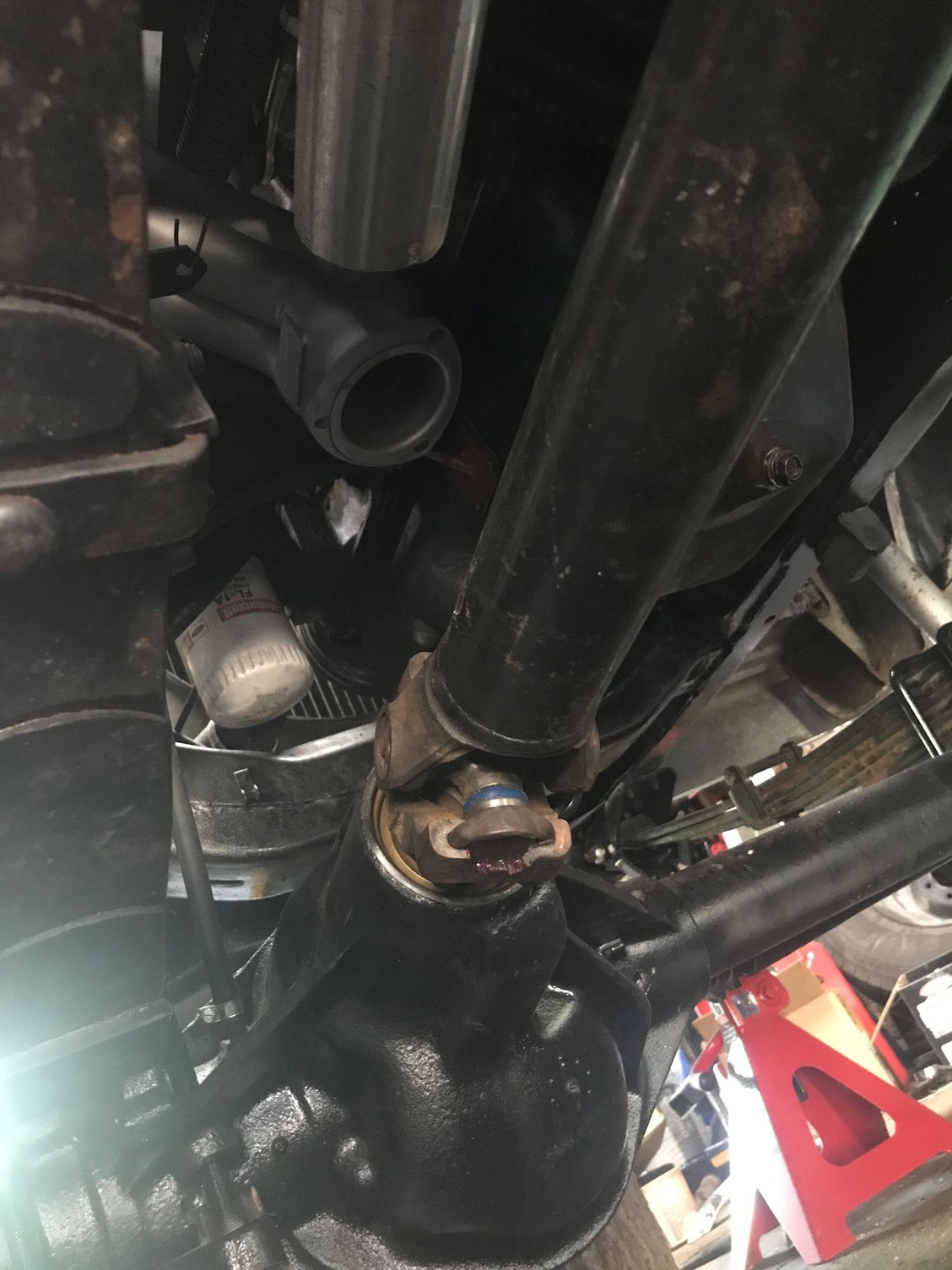

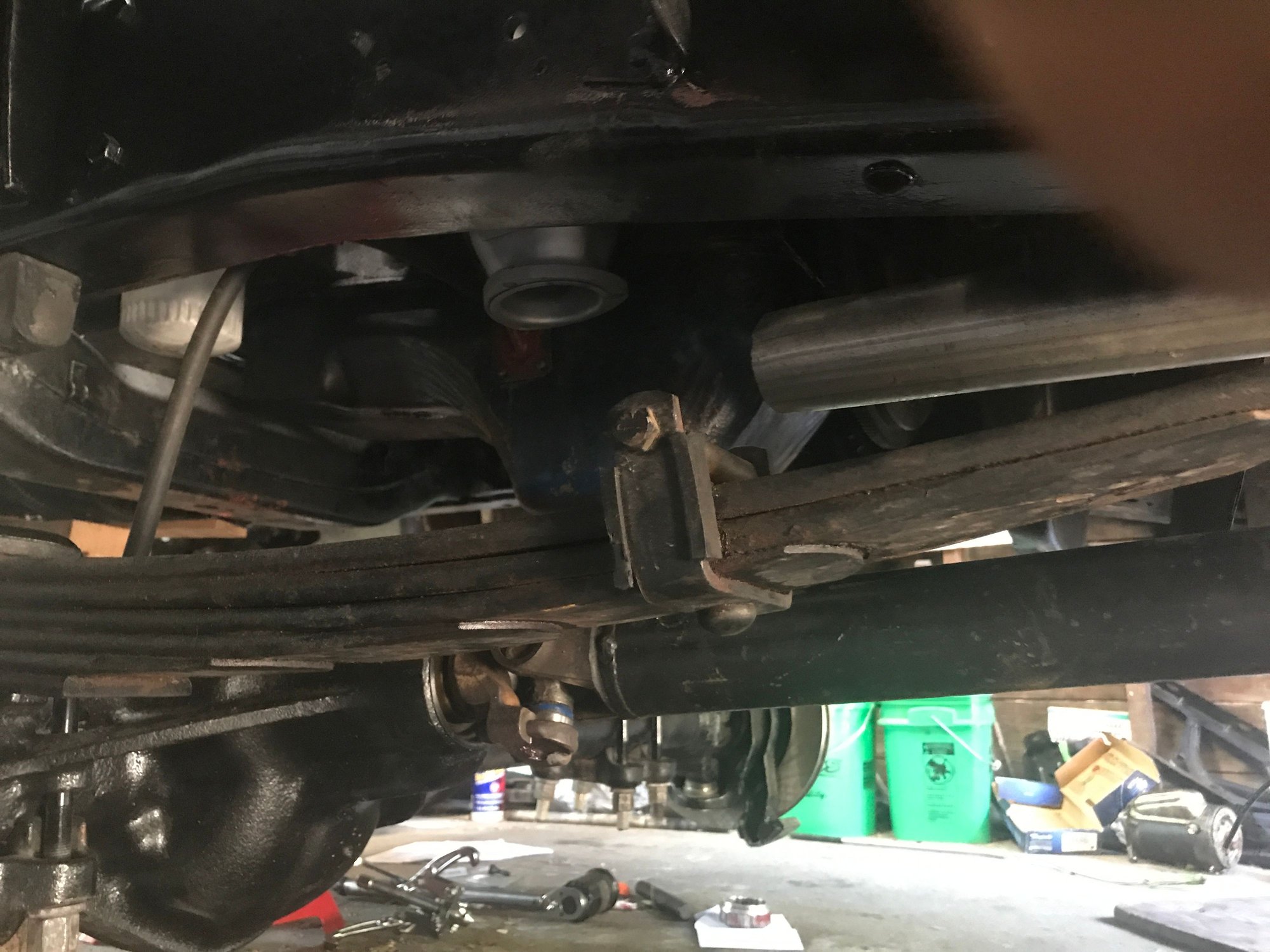

I just put the FF427 sandersons in and an hp Dana 44 1978. Block huggers. Check over the picture for collector exit.
The collector shoots straight down and ends high up. I’m going to put flex pipe I want to drive it to the exhaust shop and then have them finish it up. Anyone Advise running the exhaust pipe above the crossmember that is between the clutch and transmission to help in clearing driveshaft?
I had originally bought the hooker 6905 but found it the long tube headers would hit the high pinion drive shaft, then found the FF427 Sanderson’s.

stpackard..... Thanks a million. You knew exactly what my problem area is. And those pics are like gold for me. But now I know it is doable. Once it starts to come together I'm hoping I can get both the pipes to run down the truck on the passenger side. At this point I'll take anything that keeps the headers from slamming into the driveshaft. And while I'm at it, small world. A real good friend of mine lives close to you. Oakland. Been out a few times to visit. Always enjoyed the people I met in Nebraska.
