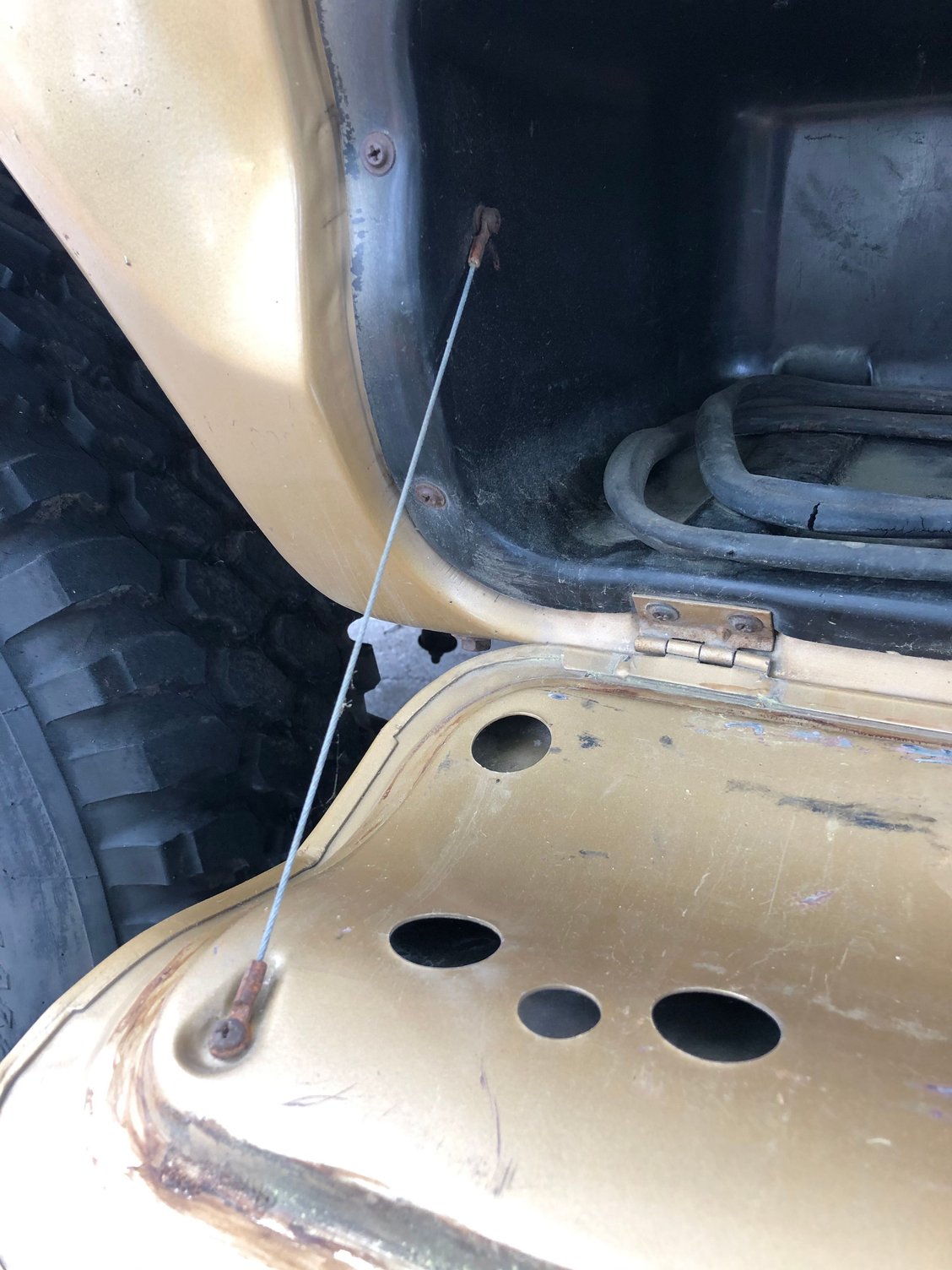

Here 'tis....

What is that seal sitting in the compartment?
This is great looks easy enough to create.

That is the original seal for the tool box door.
I have another image of it's cross-section if anyone needs to see what it's like. I assume they are reproduced these days, but have not looked lately. Been meaning to call Steele Rubber Products to see if they have all that stuff and also what they have for the early Bronco doors that does not make them hard to close.

If I remember correctly (too lazy to actually look it up) Dennis Carpenter has the seal.

Thanks all. Even learned that there is supposed to be seal in the box.
