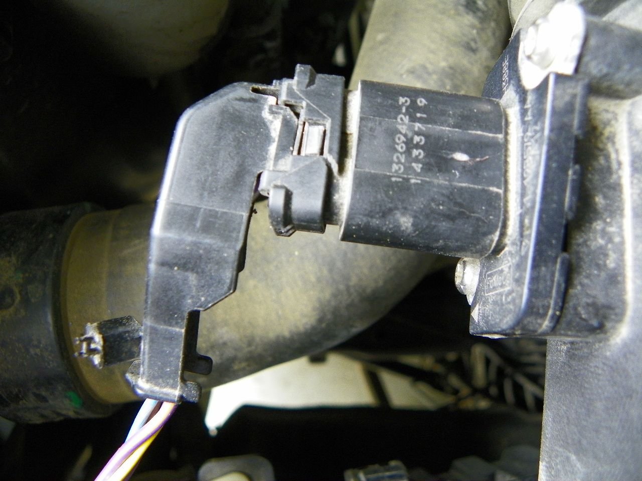

Change out my Air Filter today.. I attempted to remove the electrical connector off the housing just to make it easier to remove the housing but could not figure out how to disconnect the connector.. Also, there is a real small connector coming out of the side of the main connector.. see photo.. What this small connector for.. nothing is connected to it...

That’s the Mass Air Flow (maf) sensor.

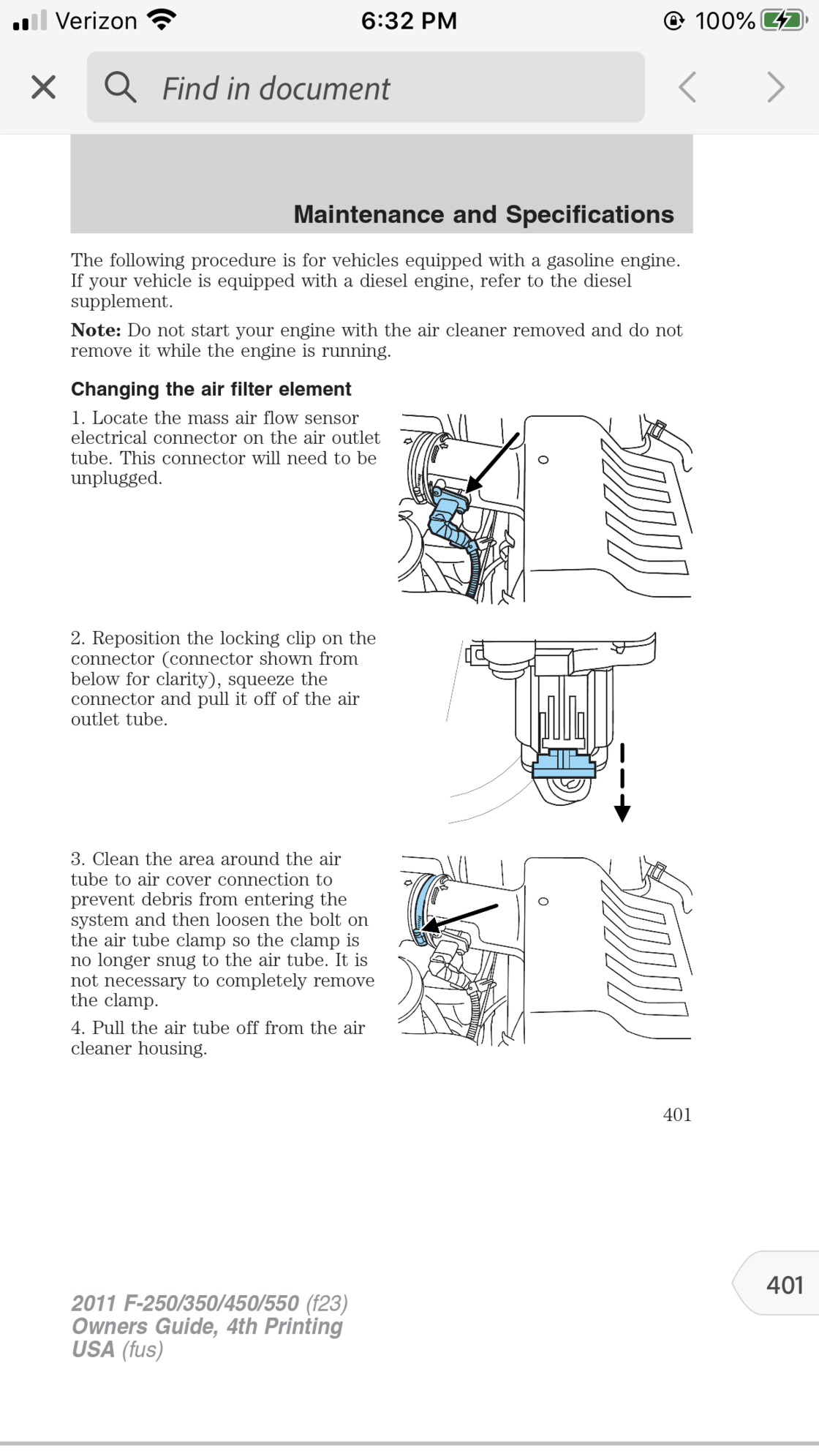

there’s a tab on the underside of what is in your picture. The tab is pulled towards the front of the truck maybe 1/4” yo release the socket, then pull it out.
Believe it’s spelled out in the manual for changing the air filter
