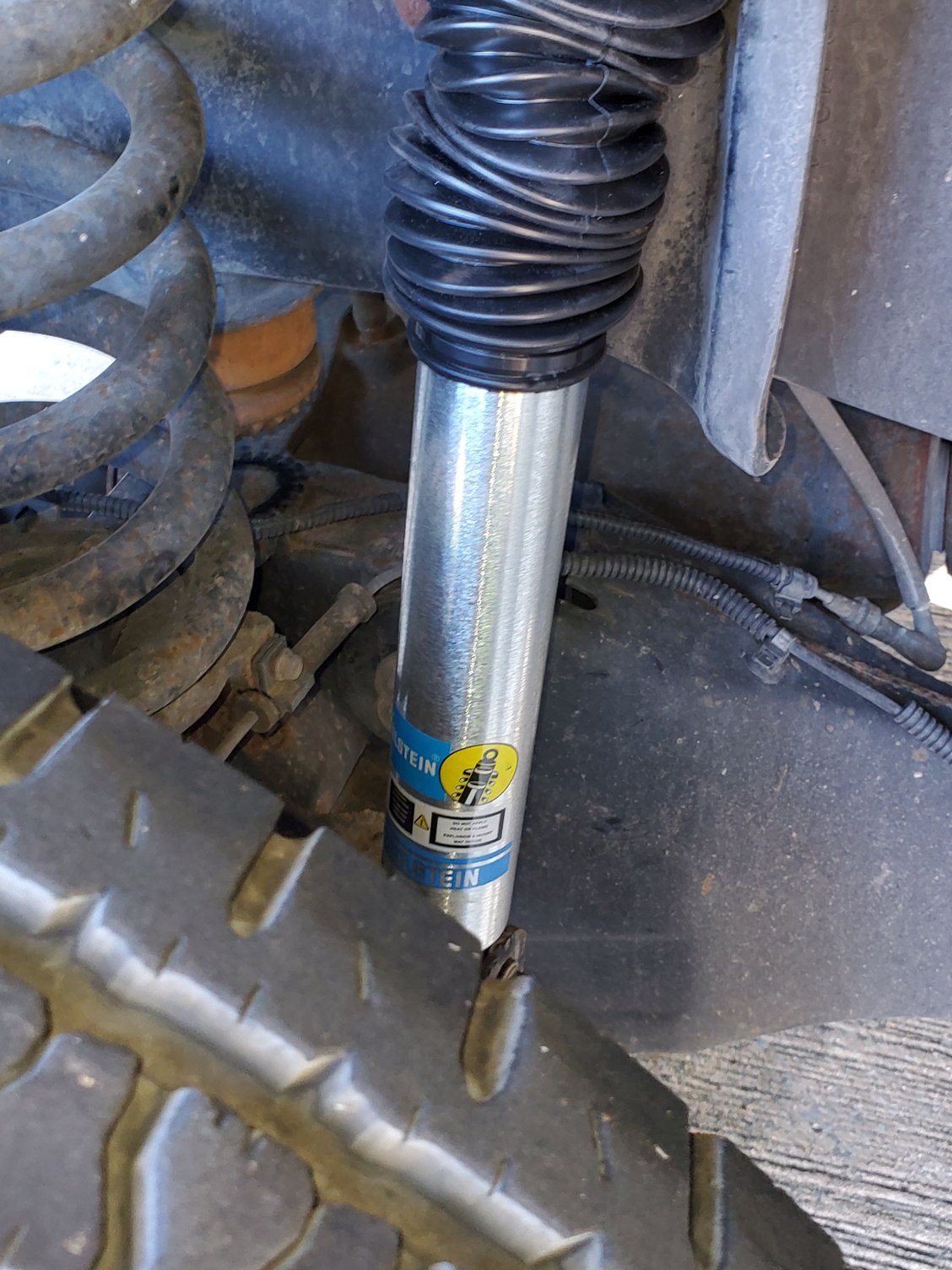

Finally got around to replacing the shocks on my 2015 F350. It had Ranchos on it when I bought it and I'm figuring they were the original shocks. The truck had 97,000 miles on it today when I replaced the shocks. It rode horribly - jarringly harsh. I replaced the shocks with a set of Bilstein 5100's. Took me 2 hrs in my driveway. I didn't remove the wheels or have to jack the truck up. The rubber isolators on the top of the front shocks were completely worn and warbled out. I took it for a spin afterwards and it definitely seemed smoother. Will have to see how it does on a longer trip. A very doable project for the average mechanically inclined.

What lengths worked for the front and rear? I've got to repalce mine, 165k miles on the originals

My truck is factory height so I ordered the set for 0 - 2 inch lift.
