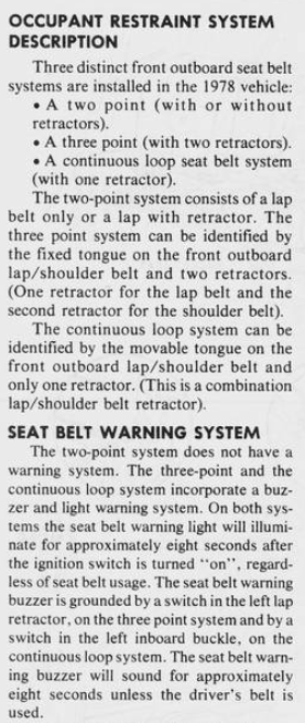

Typical Ford...the answer is "it depends" on if you have a "three-point" or "continuous loop" seat belt configuration. The 1978 wiring diagram shows the switch in the seat belt retractor (outboard of L. H. seat, on floor). 1979 shows a seat belt buckle switch...
From the 1978 Factory service manual...

What I love about FTE, you can learn something new everyday. Guess I have only seen a continuous loop system and the left inboard buckle switch/gnd point.
