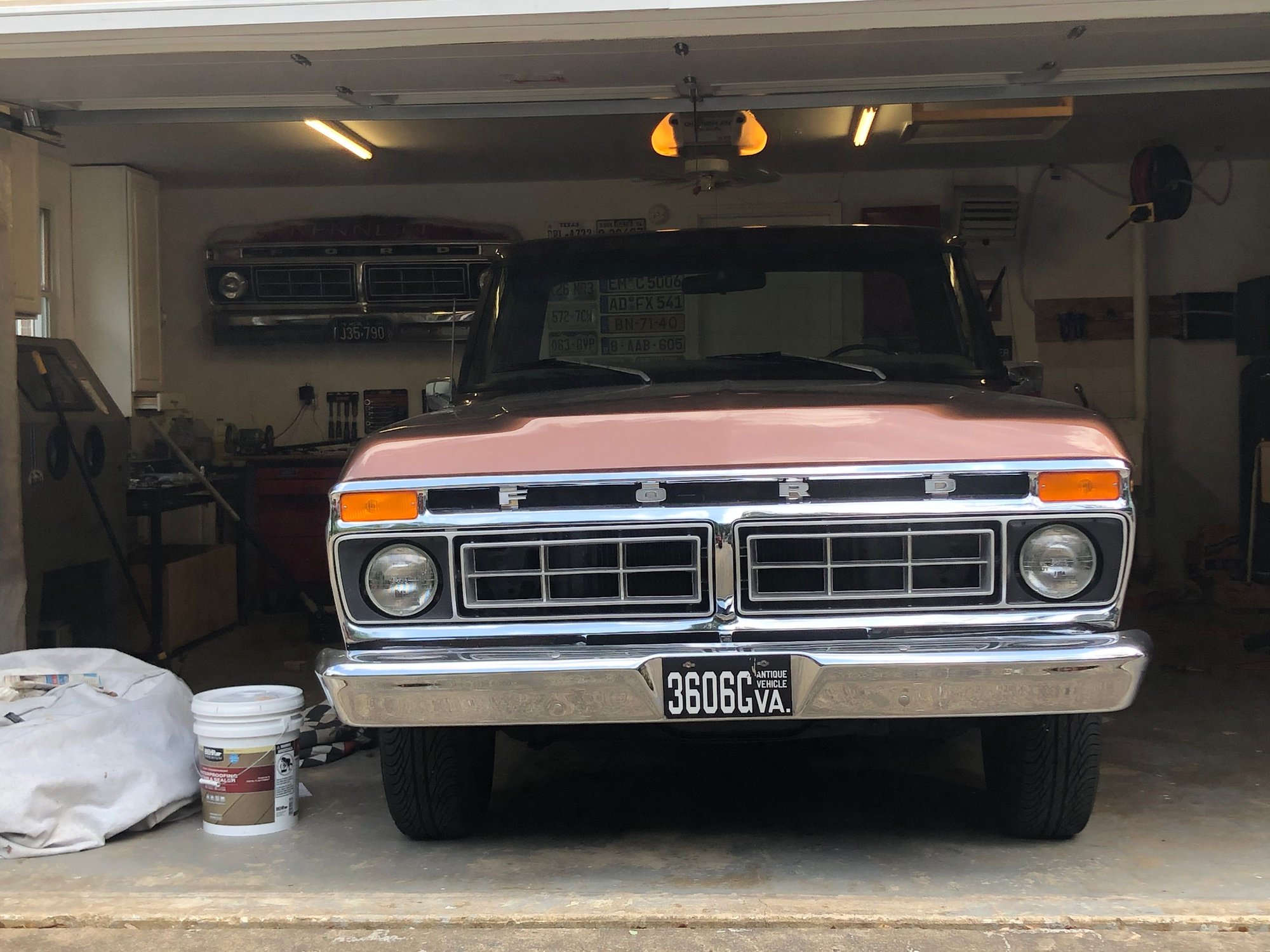

Hey Everyone,
I have a 76 Short Bed, 2 WD. Very good shape. However, the truck is leaning to the passenger side. On the driver side front, from floor to top center of the wheel well is 31 3/4 inches, passenger side is 30 1/2 for a 1 1/2 inches difference. the back, Driver side 33 inches vs 32 1/2 - 1/2 inch difference. I replaced the front springs, nothing changed. I unbolted the front shocks just to see if that would do anything - it didn't. The compressed springs are aprox 9 inches, both sides. Body mounts are original and probably need to be replaced but they're not rusted out or gone - height differences are minimal. I don't think the truck's been tweaked, I saw it pre-paint and it wasn't smacked. I'm at a loss and about to bring it somewhere. Any ideas? Any suggestions?
from the back, not so bad
Leaning pretty good from the front.
measurement on each side is the same. Body mounts are original and probably need to be replaced but they're not rusted out or gone- height differences are minimal. I don't think the truck's been tweaked, I saw it pre-paint and it wasn't smacked. I'm at a loss and about to bring it somewhere. Any ideas?

I'd look at the rear springs. if you raise the passenger side rear it will obviously raise the passenger side rear but at the same time it will push down on the driver side front. but you're leaning pretty good it may take a little more than that to cure it.
I'd jack up the right rear and see if you can level it and bring the left front down without raise the left rear too much. if that doesn't work you may have to do some creative spring modifications on the front and add a leaf or something in the rear. this problem really isn't uncommon and you can't depend on new springs to be perfect.

What does the gap between the passenger fender and cab look like vs. the driver's side? Have you taken some measurements of the frame to the floor? Like a set from both sides up front, at the rear of the cab, and at the ends in back. I'm wondering if it could be a misaligned fender or if maybe it is the frame itself that is out of whack slightly.

Because the body had no obvious accident damage does not mean the frame hasn't. I don't believe there is a frame problem but to be assured you would need to jack the frame up and place on jackstands EXACTLY the same height Lft & Rt.rear...... and Exactly the same Lft. and Rt. front.The front & back do not have to be the same height. Measure up to corresponding spots on the frame side to side on front to level the stands/blocks/shims etc.... same on back.You are leveling side to side front & side to side back. Once established; start measuring along the frame in the same spot (a factory hole is a good reference each side) side to side,down to the level floor, along down the frame.For a couple of hours this will tell you if the frame has an up or down tweak.
Other than that I think you possibly have a weak rt. rear leaf spring.I always re-arch the springs if needed, to match, myself, and easily done with a bit of labor. Increase,decrease,leveling ride height can be done with arching rear springs especially if you have one that is weak. gary
