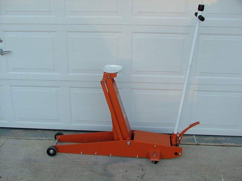

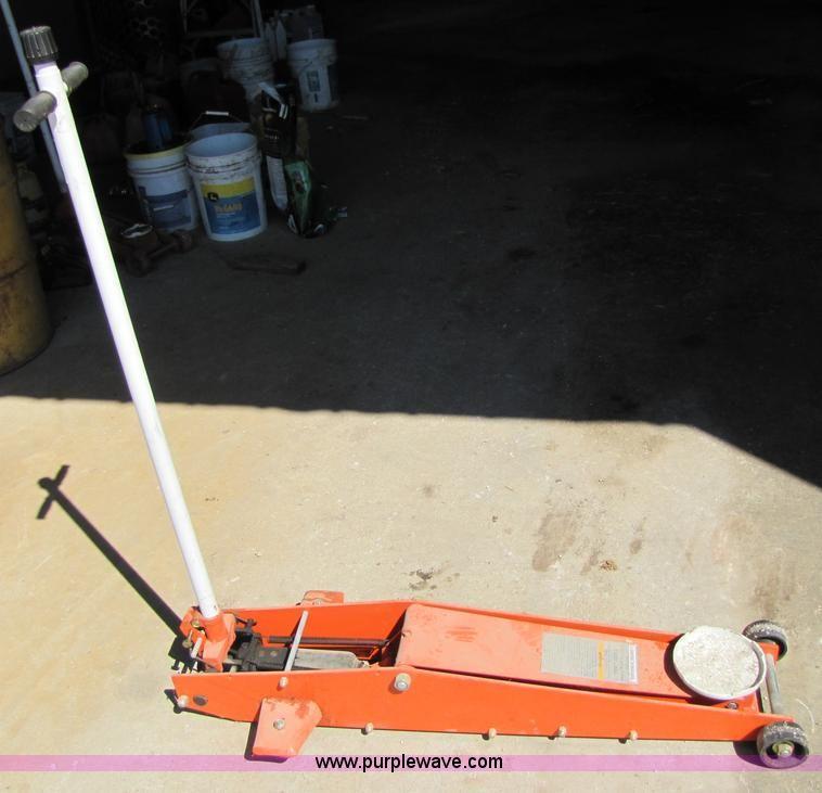

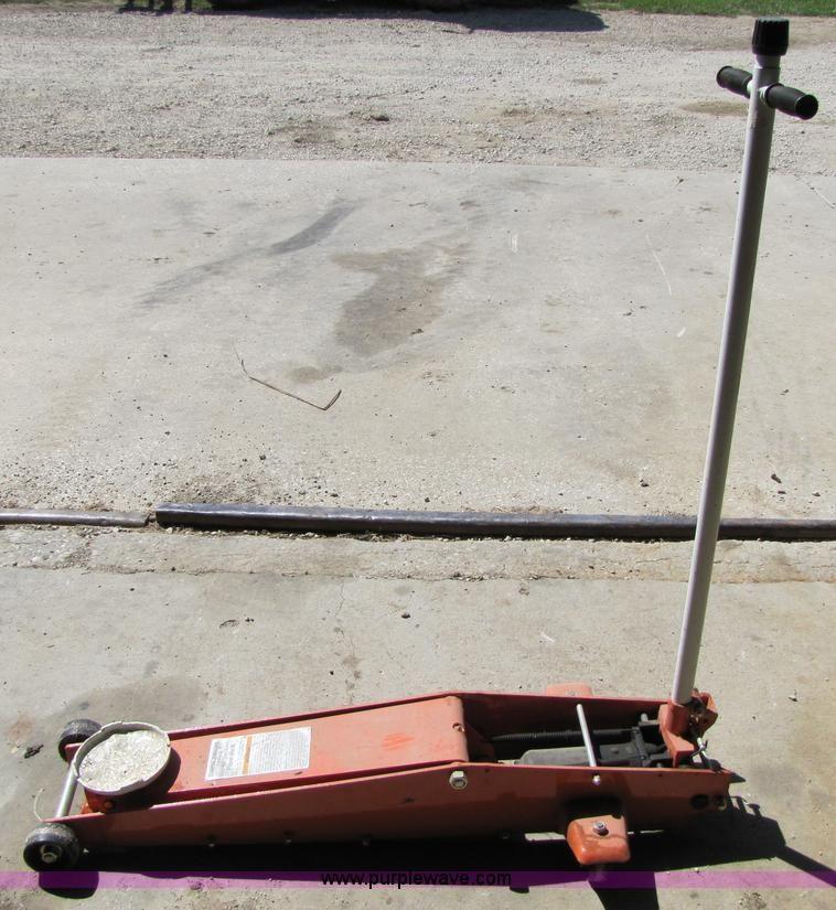

Recommended floor jack:
1. Long reach. Being able to roll a floor jack under the frame rail of the truck from the sides, or under the spring perches of the axles from the front or rear, while still being able to apply a full arc of pump on the handle, is worth the extra weight and cost of long reach, long frame floor jacks. Front or rear floor jack entries under trucks to reach the axles, where additional equipment is attached to the front or rear bumpers (winches, liftgates, etc) is another benefit of long reach floor jacks.
2. Get two, if you currently have zero. Having a pair of floor jacks provides an incredible measure of additional utility, convenience, and safety when raising and supporting a vehicle. Easy, smooth, bilateral lifts - without racking the body or cracking the seam sealer or twisting the frame - is just one of the benefits of having two floor jacks. Being able to reposition a jack stand while leaving the original floor jack in place is another. Being able to unload the springs , or reseat and align spring parts, by raising and lowering the truck separately from a simultaneous ability to raise and lower the axle independently, is another power of having at least two floor jacks (I've used as many as four floor jacks at once under a motorhome, along with eight jack stands.) Adapting one floor jack with a cradle to raise or lower drivetrain components like transmissions, or to shift the engine up or down off of the motormounts to aide in the installation of a turbo... are among the many ways that an additional floor jack can prove useful to those who do their own service work.
3. High lift. The higher the lift that the floor jack is capable of delivering without monkeying around with placing boards underneath the floor jack to raise it higher... the safer and easier life with a floor jack will be. The combination of long reach and high lift is ideal. There are quite a few long reach jacks that are not high lift, but all high lift jacks have somewhat of a longer reach than a typical floor jack. The downfall of some high lift jacks is a reduced capacity, but this is resolved under recommendation number two, which is to get a second high lift jack, and use both simultaneously, one on either side of the truck. This reduces the lifting load on each jack by half, while offering the benefit of a higher lifting capacity, with less twisting of the body. For those who run leveling kits, lifts, or larger tires, the high liift floor jack is worth it's extra weight in gold, for the safety and convenience that operating a floor jack without stacking boards underneath it provides.
4. If using the floor jack for other vehicles, such as passenger cars, then a low saddle height is another recommended feature to look for in a floor jack. Just being able to wheel the floor jack underneath modern fuel efficient vehicles that are low slung to the ground can be difficult with some floor jack designs. Something to look out for.
The following photos show a floor jack design that meets three out of the four recommendations above (1, 3, & 4). Obtaining two or more will then meet all four recommendations.

Thanks a ton, or rather 3-tons! I do have an old Craftsman 3-ton floor jack, but it's difficult to release the pressure and usually drops the vehicle pretty quickly. I'd like something easier to control. I like the idea of a long reach, that's makes a lot of sense. I'll also be using it to lift one side of our fifth-wheel camper to do maintenance on it - it weighs in at about 7,500 lbs; the truck is right at 7,900 lbs., so 3-1/2 tons ought to work just fine. I do have four 4-ton jack stands as well - i never rely on the hydraulic jack if I am under any part of the vehicle!
Thanks again.
