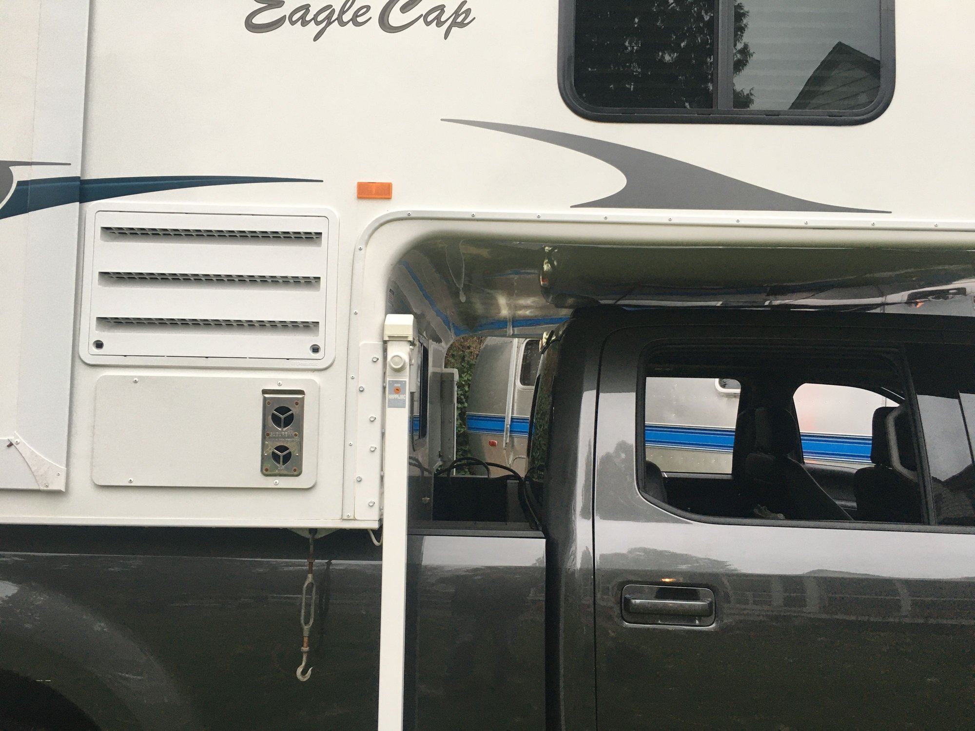

The only other choices I can suggest you look at are the Eagle Cap EC850 (if you can find one used - they stopped making them I think in 2015/16 and switched to the...) EC811 or the Arctic Fox AF811. The Eagle Caps will be more expensive and the Arctic Fox, much heavier... so basically - Lance 855S still sounds good! What a waste of typing that was...

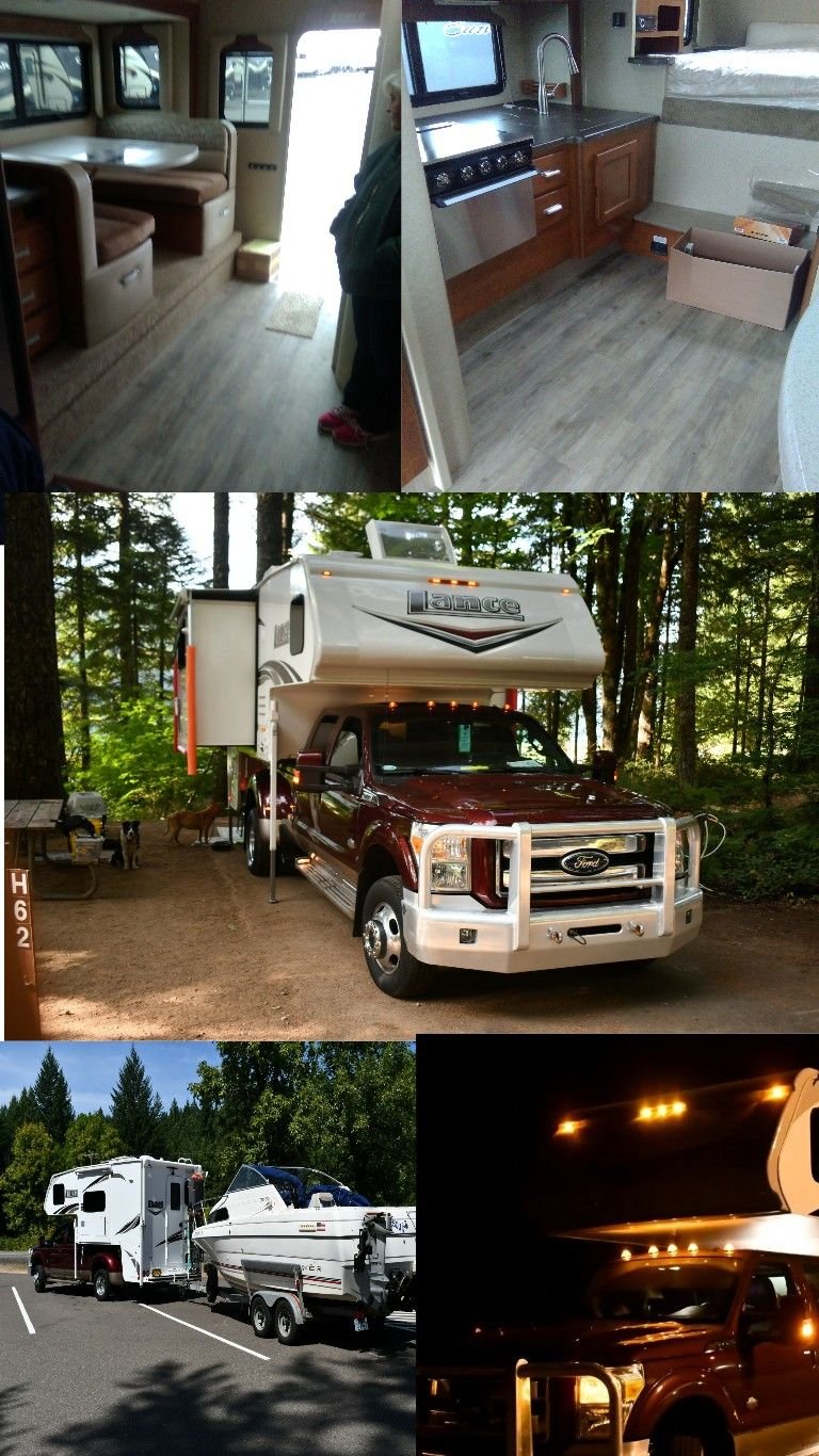

I think everyone has pretty well covered everything.
We have a Lance 1062 double slide. We have had a number of campers of various brands. This is our second Lance.
We like Lance. Personal preference. A good friend likes Artic Fox. Discussions between us around the campfire can get interesting (wives call it entertaining) as not only does he have an AF, he has it on a Dodge as well. We have pulled boats and horse trailers. These days our towing is by far a boat.
https://www.lancecamper.com/
On the Lance web site you can "build your own". It shows you the options available and gives you a weight figure after you have those options added.
Lance lists standard options + water & propane tanks in their weights.
Inside the camper in a closet or pantry they will have a sheet that lists the weight as above along with the weight of the camper as built with optional equipment that is over 25# that has been added.
We take our camper off anytime we are going to be someplace for more than a couple of days and we plan on 'sight seeing' or doing other driving. The only problems we might possibly run into with this is if we can't find a camp site that is level enough to facilitate a "safe and sane" removal / loading of a camper. I watched fellow try to unload his camper on an inclined pad at a camp site. I watched as the camper started 'walking' down the incline and only stopped when it hit the back of his pickup.
We tow a 6K + depending on load out - it is also used as a 'utility' trailer for long trips.
