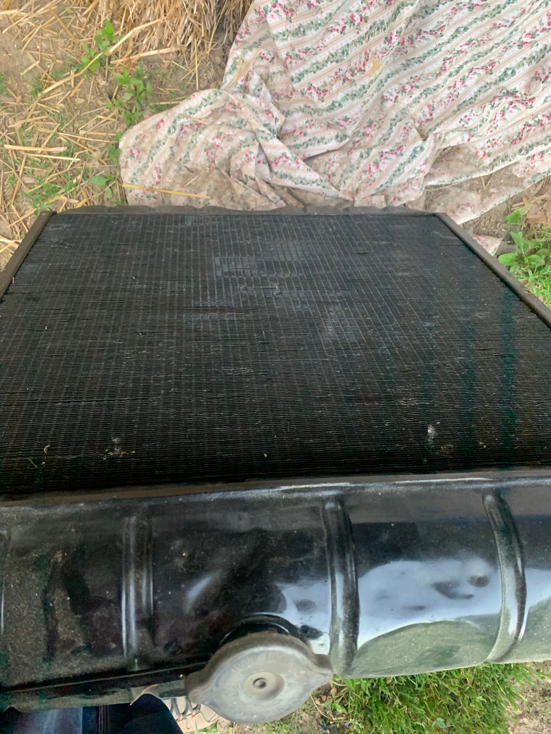

I have this one that I was told was just tested
