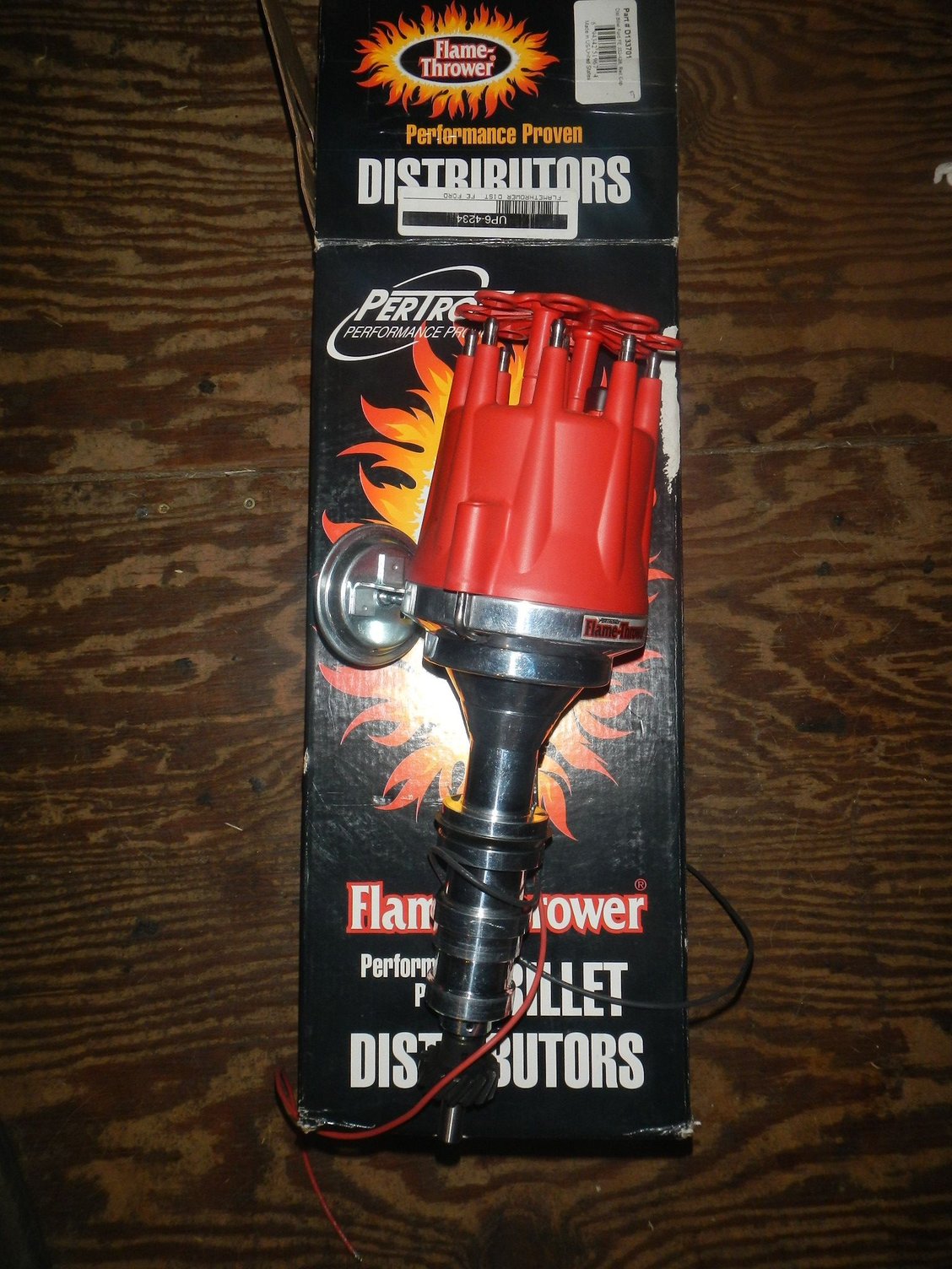

I also have a 410 and here is the one your looking for

Thank you Christmas, but I would like a stock, not HEI, cap. Is there a difference between the 410 and other FEs?

That's not a HEI cap, just a standard cap with wire retainer. Still need the Flame Thrower coil. From what I understand a 410 is a 390 with 428 crank and rods and was not used in Ford vehicles only Mercury.

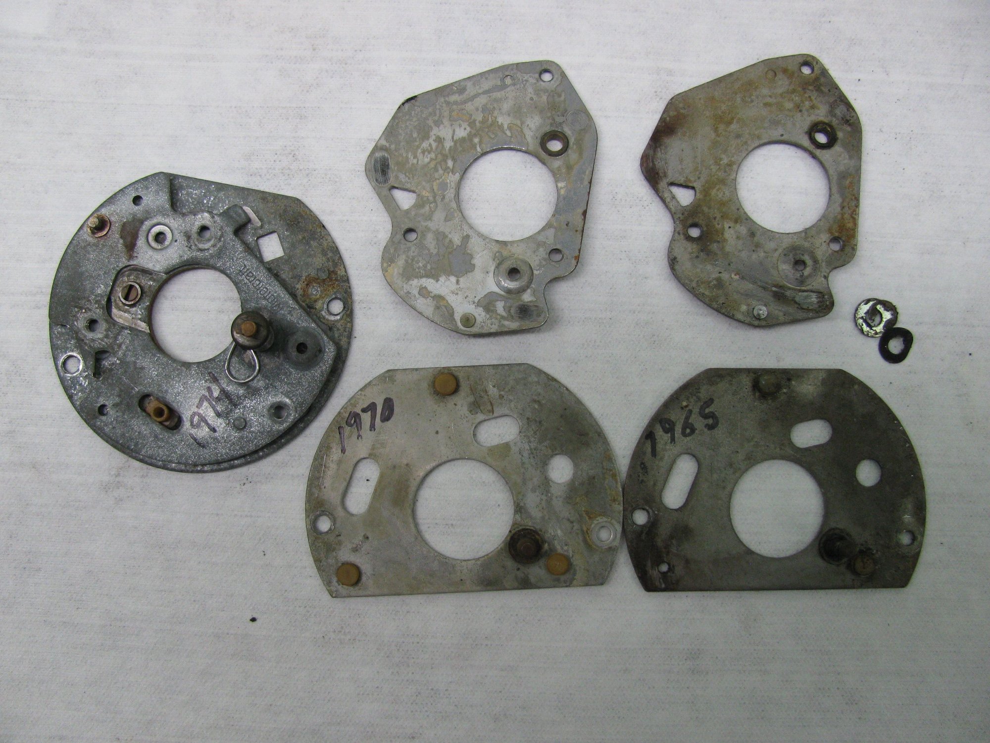

If your distributor bushing isn't worn out and it probably isn't. Your problem is most likely the Autolite breaker plate that came in it. The original Autolite plates were a poor design and were replaced with by a much more stable advance plate in 72. The two on the right in the pic are Autolites the one on the left is a Motorcraft the Autolite plate is only held down with a flimsy wavy washer and slides around on those three nylon buttons which tend to wear out and fall out. You can get them at any parts house or E-Bay and replace the points with a Pertronix pickup and you should be good to go for 1/3 the cost of a new distributor. The PN's are BWD BP1, Standard FD8006, Motorcraft DB-187 A.
