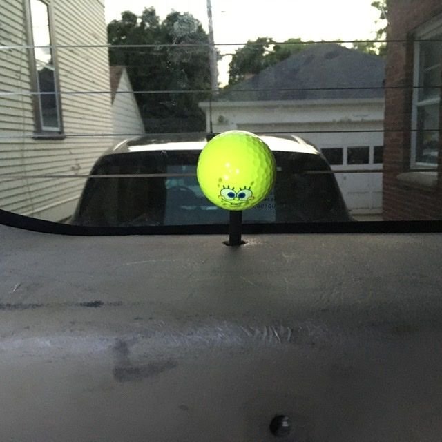

Here’s my DIY interior hatch release. I like camping in the Ex and wanted to be able to exit out the back.

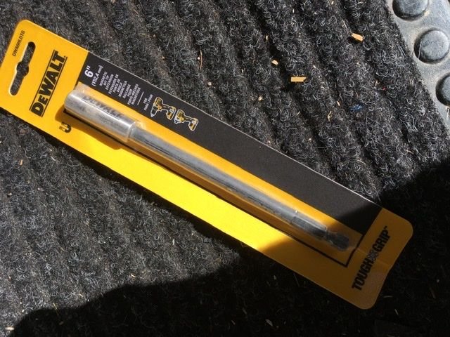

All I needed were two items. A magnetic bit extension and a golf ball.
Pics are included but not showing when I look a the thread. Maybe it's just me or maybe an Admin can help out?
Latch release in action:

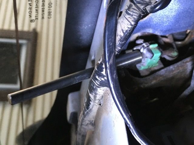

Push rod actuating the lever:

I used a 6” bit extension Dewalt DWA6JLDTG, $9 from Lowe’s. Hole sizes are all based on this specific part.
The guide hole:
Measure 1 3/4” from the rear glass and 1 9/16” from the driver side. Drill a 19/64” hole at a 70 degree angle (front to back).

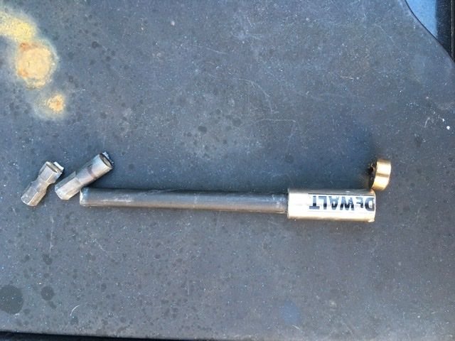

The push rod:
Cut down the bit extension. The black part should be 3” and the bit holder should be 1 3/16”. Chamfer the end. It’ll make installing the golf ball easier.

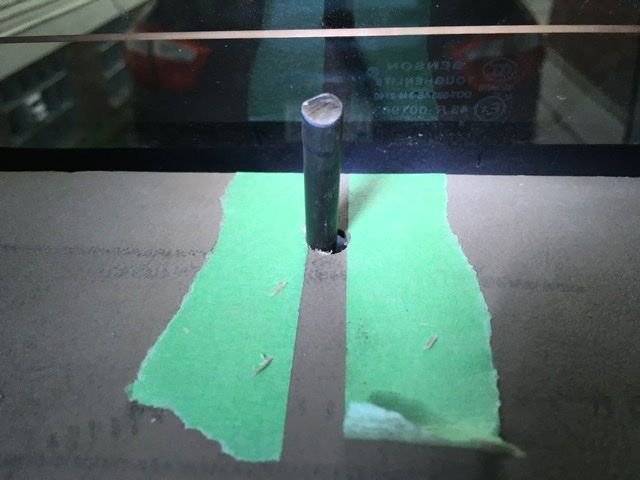

Drill the interior cover panel:
With the push rod installed, fit the trim panel and mark the left to right placement of the rod. Measure 1 7/8” in from the window side and drill a11/32” hold at a 70 degree angle. Check fitment and oversized the hole so the rod moves freely. It should not drag on the plastic trim.
