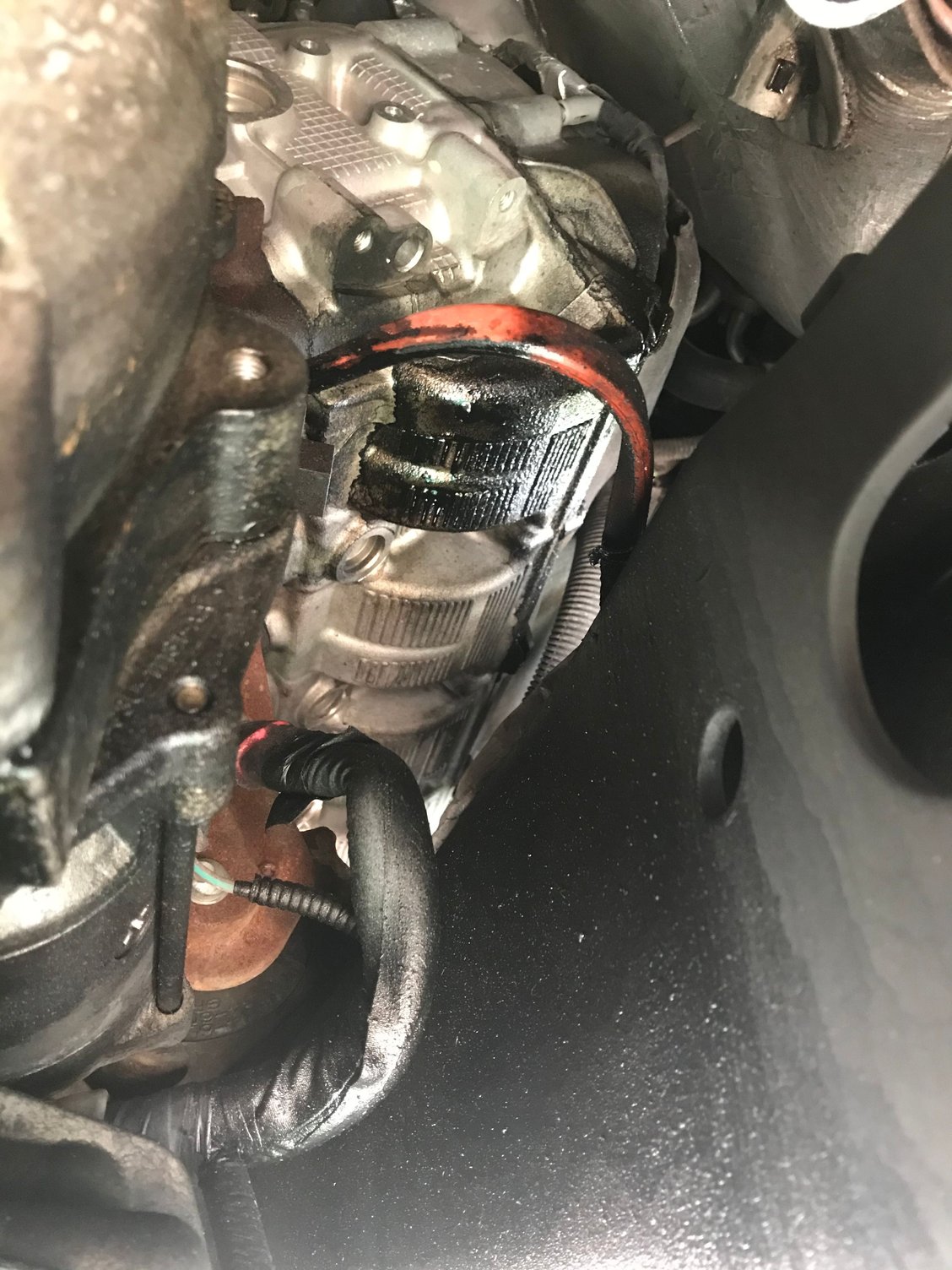

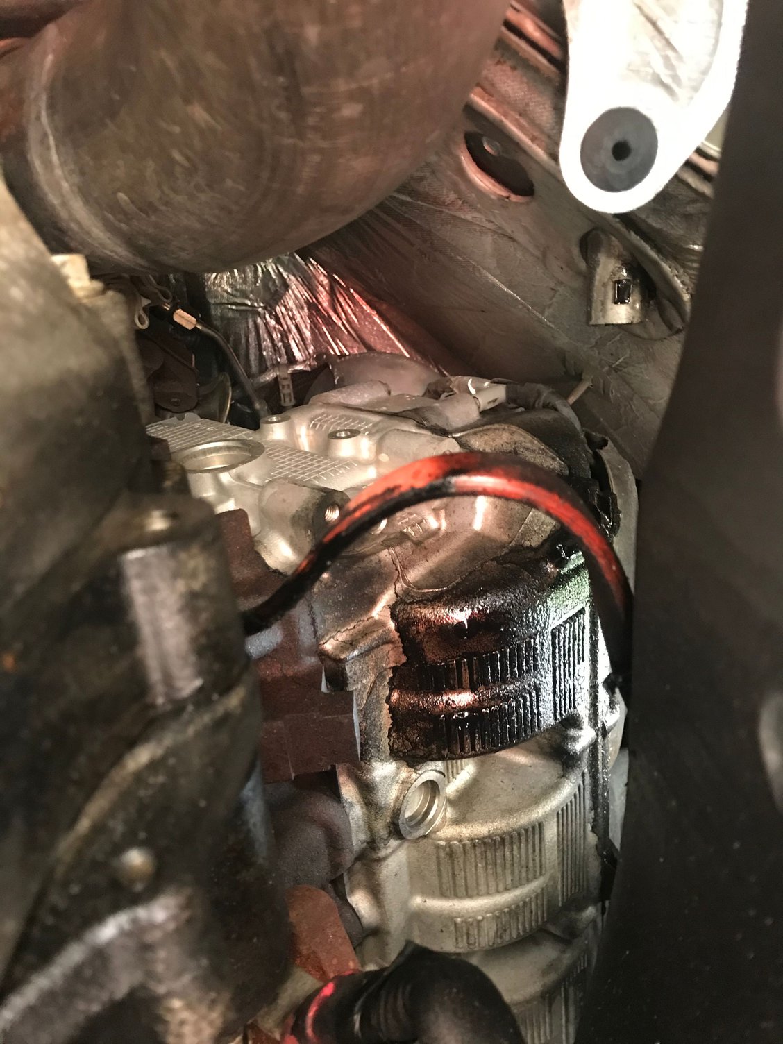

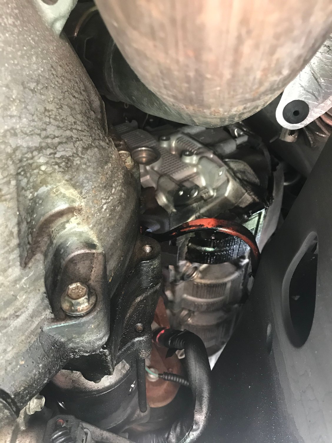

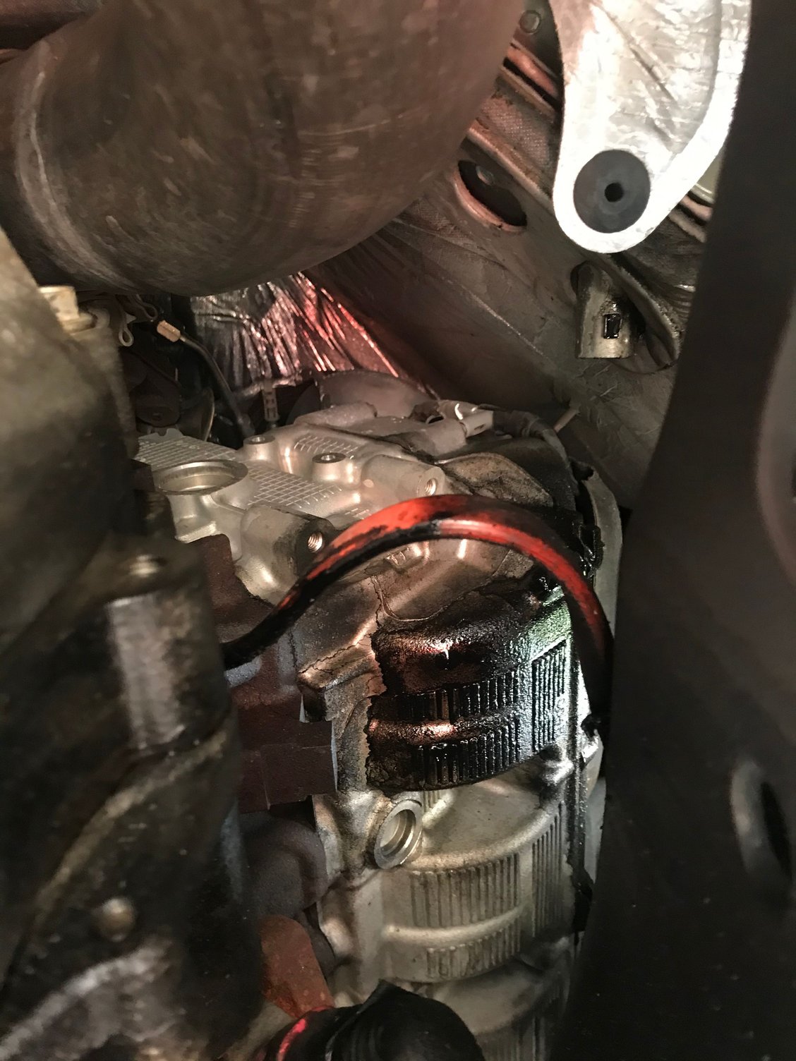

Hi guys, I’ve owned my 2011 for many years and have replaced most of the typical things. Just want a second opinion before I tear into this one, looks to me like a valve cover leak. I have leakage coming from only the right side. Looks like from the bottom of the head and dripping all the way down to the starter area. Everything else is clean. Am I on the right track? The oil pan is as clean as the day I replaced the seal and all. I’ll try to post some pics. Thanks everyone

That's what it looks like from here.

Make sure you don't see oil around the turbo and engine valley. The quick connect oil line going into the turbo is a common leak source.
