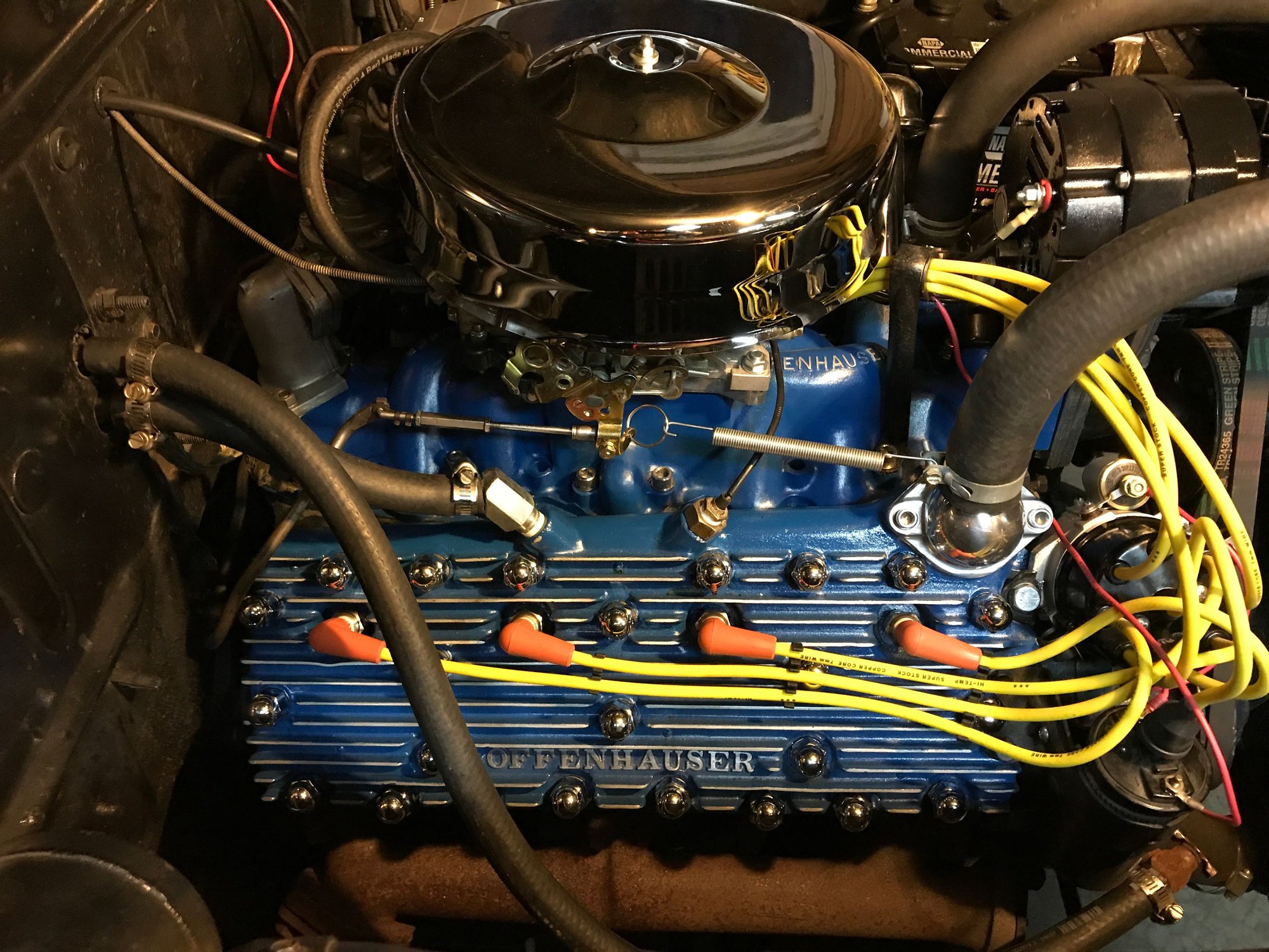

Bob, I think that the bad rap on Clifford is 2 fold. First all of their products are old school tech and the new generation of hot rodders just don't know how to work with it, they want plug and play. Second, Jack passed away a while back and his daughter and son-in-law are running the company. They do the best they can but a lot of expertise went to the grave with Jack. The 223 setup is a bit expensive but so far I'm very pleased with it. It's a little out of place in this forum but I'm attaching a picture of the engine in my '49 to illustrate just how old school I am. Keep me posted on your progress with Suzie Q.

Helpful as always, Chief! The '49 motor is a beauty. I'm not building a 21st Century race truck - frankly I understand the old school tech much better anyway. Just need a little more pep out of the 223. Was your motor stock when you added the Clifford kit?
