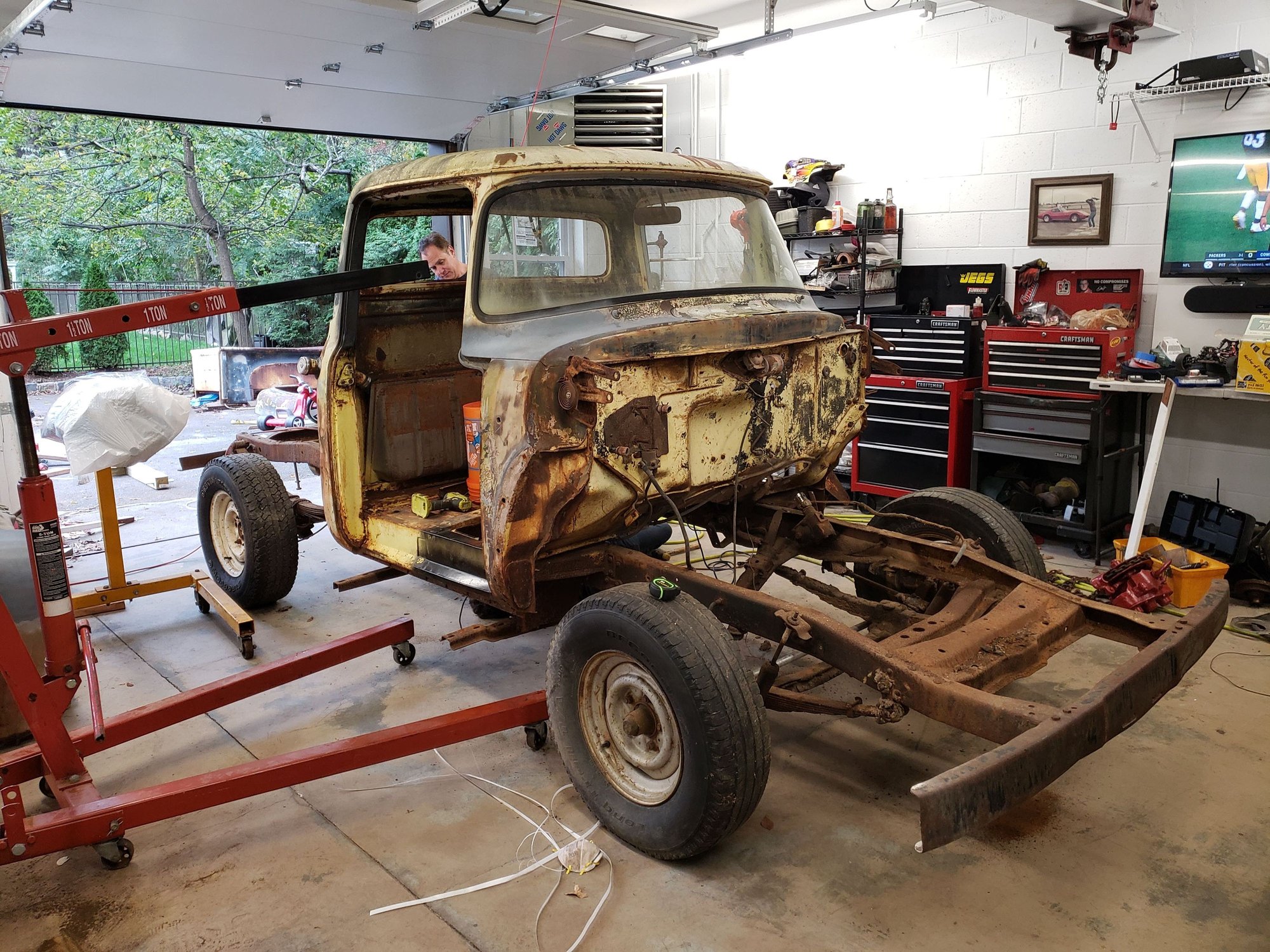

I left my pedals attached and disconnected the floor panels around them. Lifted the cab up over them.

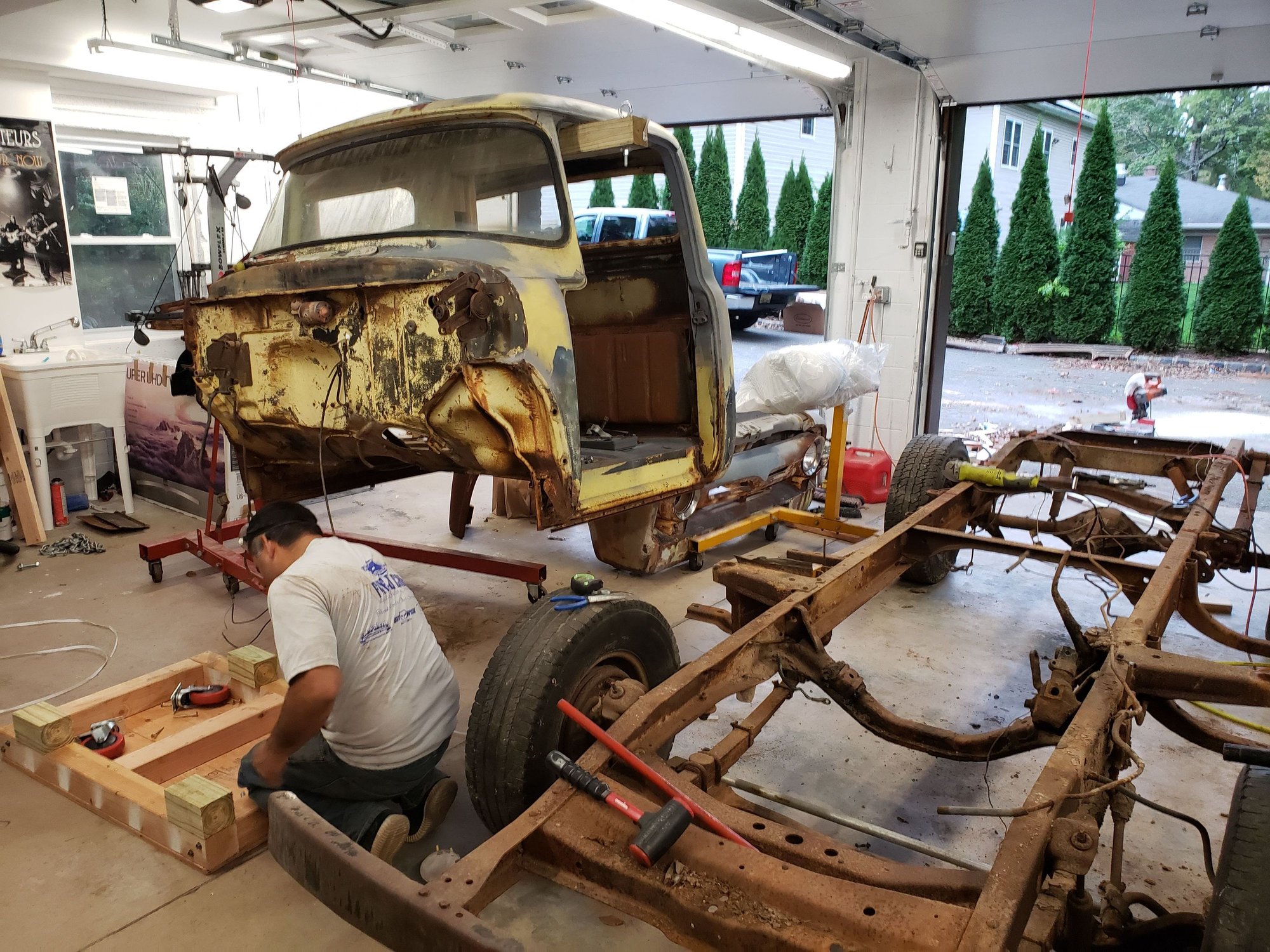

To answer your question, for me it was easiest to remove the cab first, then the pedals.

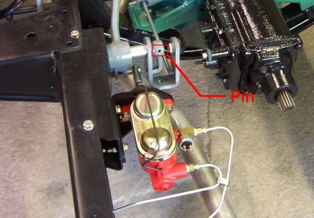

The only way I could get the pedals off with the cab in place was, after removing all linkage and return springs, drive out the pin holding the arm on the end of the pedal shaft:
Push the arm off, then swing the clutch pedal down enough to clear everything and slide it out through the body support. Keep in mind there will be a sleave, a spring, and a number of washers fall off as it slides out.
