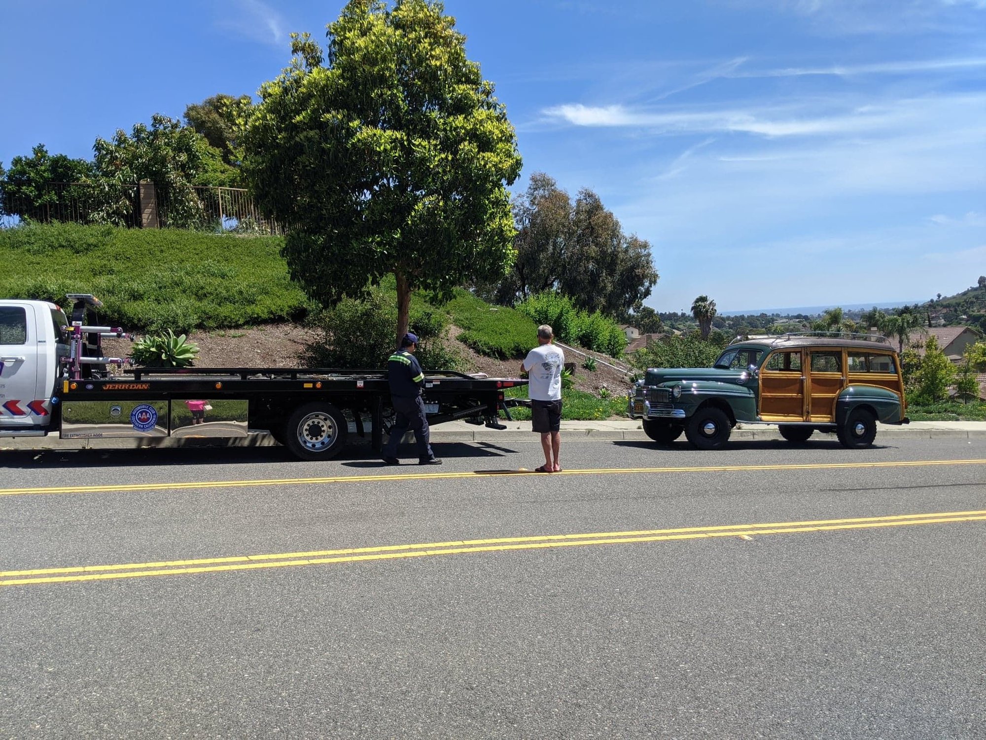

The non-synchro, 1 1/2-ton truck 4-speed in my '47 Marmon-Herrington Mercury wagon scrambled itself yesterday...anybody have one in good working order? If not, are parts available for a rebuild? THANKS!

It ate it a few blocks from my house (worst sound I ever heard!); a heroic AAA guy got it unloaded and pushable into the garage, so at least it's safe. It had a nice 73-year run. First thing I did was email Chuck.
