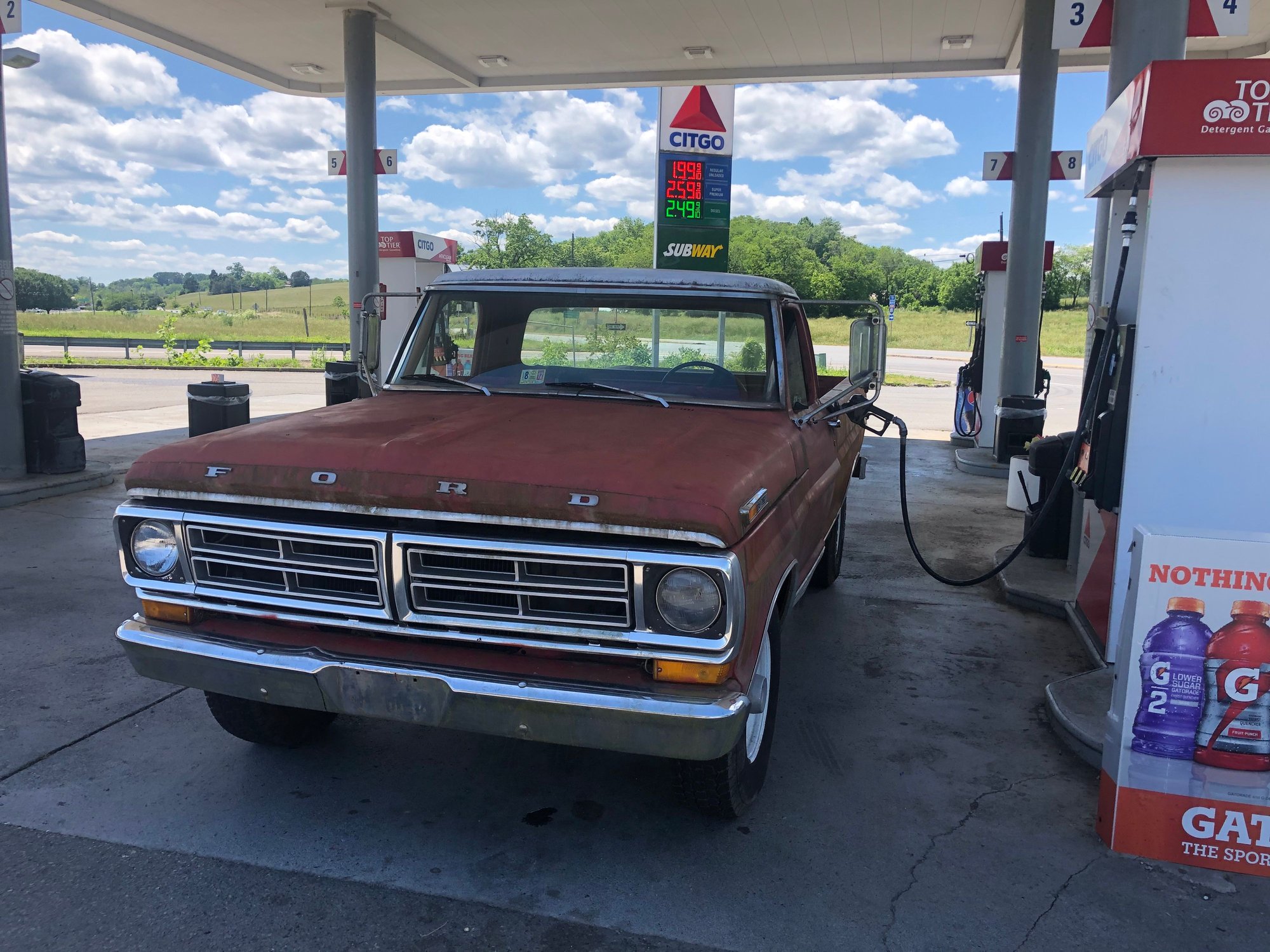

I was able to get the leak sorted out. I have drums all the way around and the front portion of the master was for the rears. The culprit of the leak was the rear driver side wheel cylinder. I was also in for quite a surprise when I had to remove the entire axle in order to remove the drum, which fought me valiantly. I then took the truck for its first trip on the road in over 5 years. It was quite a momentous moment. I have been working every weekend on this thing for the last month+ to just get it worthy to go get gas under its own power.

Congratulations. That's a great feeling when all that work pays off.
Truck looks good there getting a sip of go juice.
So what's the project for THIS weekend? Never ends, right?

Gas is about 40 cents higher up there than down here
But, as mentioned it's a good feeling when it's "on the road again"

The project for this weekend is to try to tighten up the manual steering box. It will turn a good 1/4 to 1/2 a turn in either direction before it actually directs the truck. At this point the steering wheel is just for looks. It was quite terrifying driving down a one lane back road. I might also crawl back under the truck to see what is up the the shifter since it moves a great degree side to side while in gear. Also, the gas price is so high because that station was right off the interstate in kind of a dead zone.
