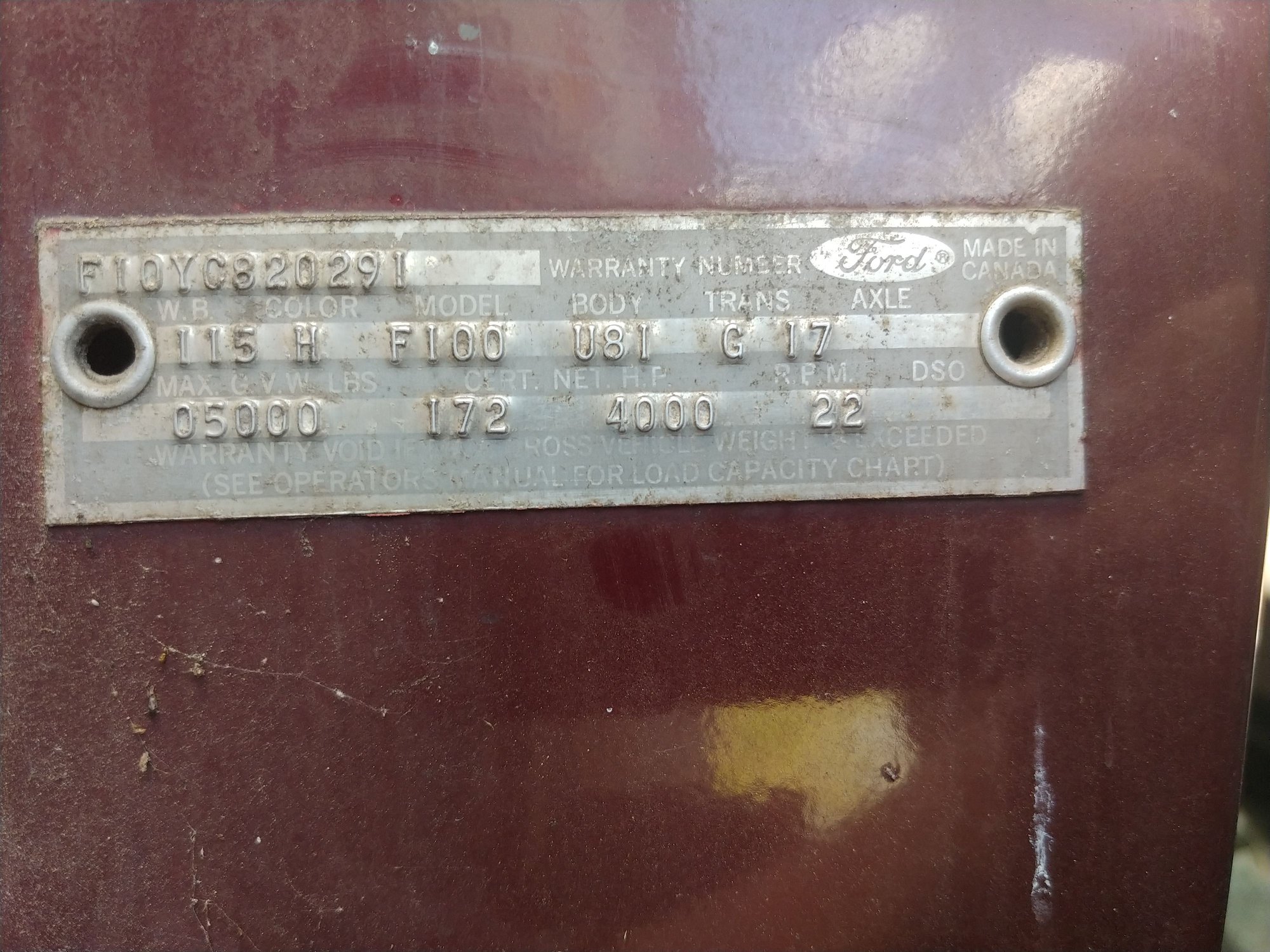

A C6 swap is pretty simple but you need to post a little more information. What engine and transmission is in it now? I don't know if you can post pictures. If you can, post a picture of the warranty plate on the door and someone will decode it so you will know what it had in it when it was born. If you can't post pics just post the info on that plate.

Crop Duster - I guess that I could have included that. The engine is a 352 and the plate should be below. I wish it was smaller to view better.

I see that says made in Canada. Some one with the books will show up eventually. As far as the transmission that is in it. Look under there and see if it has a cast iron main case if it does it is most likely the original Cruise-O - Matic.

Chad, can you decode that warranty plate?
I agree if it is all original I would fix the COM.
Old May 31, 2020 | 11:53 AM
TA455HO's Avatar
TA455HO
Lead Gopher
Joined: Aug 2012
Posts: 10,066
Likes: 1,622
From: Seattle
F10 - F100 4x2
Y - 352 2V 8 cylinder
C - Ontario Truck assembly plant
820291 - 1966 - Assembled February 1966
115" Wheelbase.
H - Sahara Beige
F100 - F100 4x2 5,000 Lbs GVWR
U81 - U = Parchment crinkle vinyl and black rosette pattern vinyl bucket seats (Ranger) - 81 = 81B = Custom Cab
G - MX COM automatic transmission
17 - Ford 9" 3.25 (3.3M) WDM-H-S
5,000 lbs. Gross Vehicle Weight Rating.
172 net HP @ 4,000 RPM
22 - Charlotte, SC sales office
