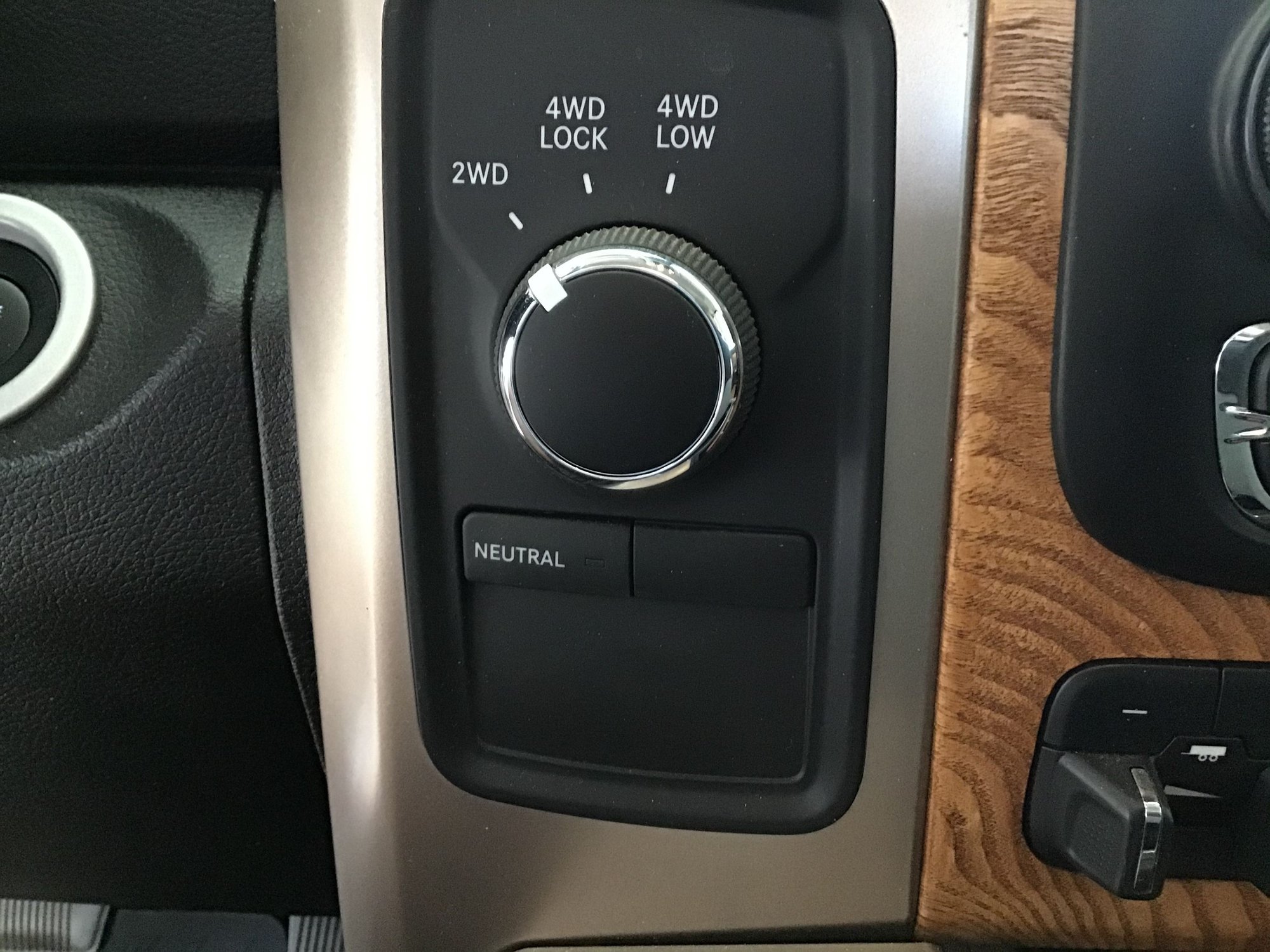

Seems like this is one of Ford’s better ideas!!! LOL
A simple “N” button by the 4WD switch would work very well. I think *most* other makes with the electronic shift do it that way.
Nissan doesn't. I agree that N would be helpful. But that would just be way too obvious and guess how many vehicles would be "lost" due to rolling away.
Well, Jim; I guess I was wrong thinking Ford was the only one to over-complicate things then.
