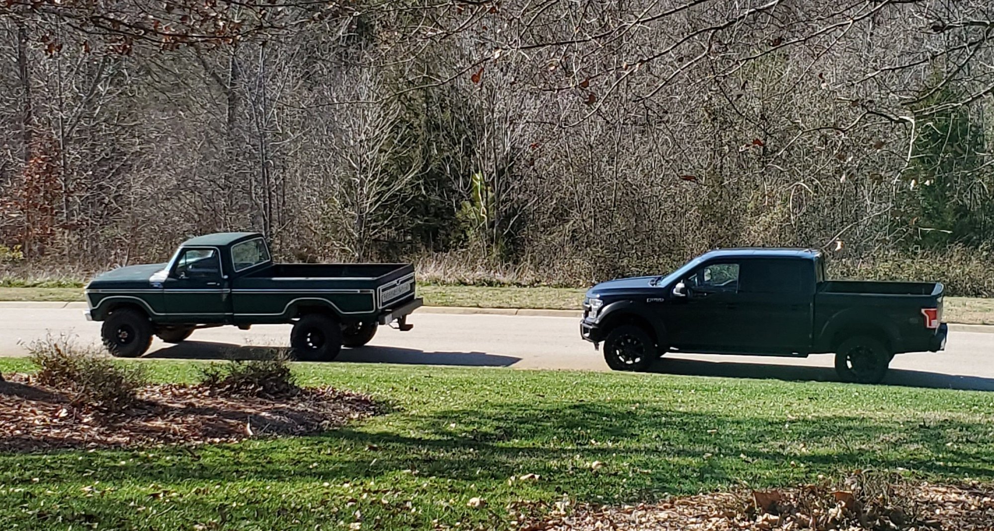

What shocks do you all like? I've got an early '77 F250 4x4, stock 7700lb springs, swinging military 36s. Thinking of just going with the Yellow Monroes (HD) from the auto parts store. Looking more for a compliant ride, not too harsh so that I can hustle down a dirt road a little bit if I want. OK maybe that doesn't happen on a 250 highboy . Pic for attention
