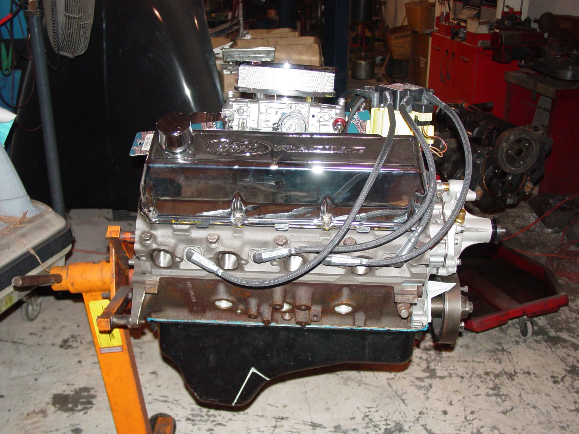

I am about to put my motor 460 with a and trans in my fat man CUSTOM chassis with mustang IFS do I need a special oil pan ITS A 71-73 460

ITS A 54 F100 PANEL BODY

you need a double sump pan with a MII suspension... little sump in front, big sump in back I used a 2/4 laid flat
to space mine up off the cmember...bought mine from Bishops engine replacement parts, inc in Dallas their part # 535 it was 35 bucks in 1997

I used the milodon foxbody swap pan in my truck
