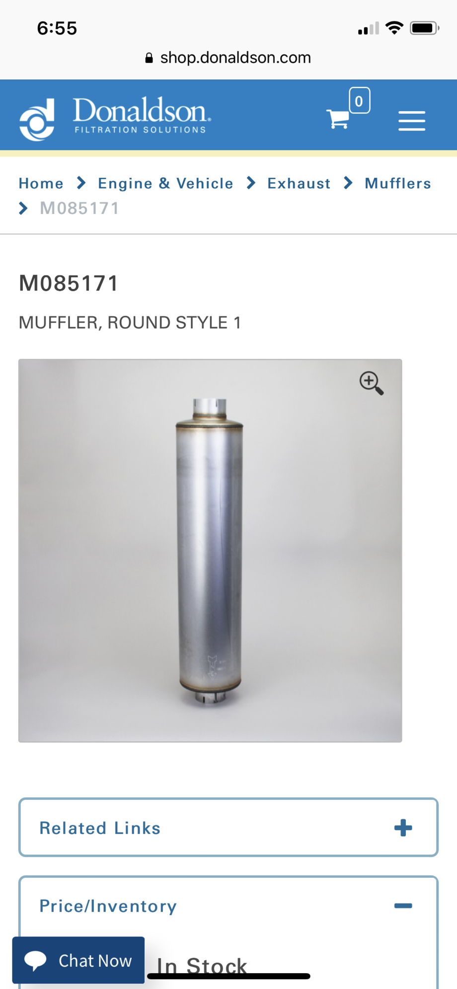

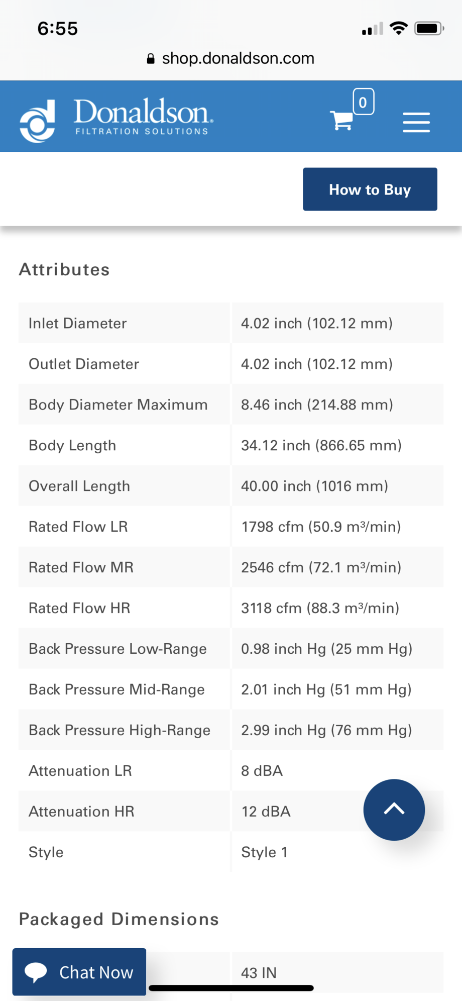

On the couple cummins trucks i had, a 40" Donaldson eliminated the drone, i think because of the chamber in the middle. The 51" does also but the 40" gives a much throatier sound outside and is more compact. Its very similar to the obs 94-97 mufflers.
If i cant fix mine with 1-2 tries of the 1/4 wave pipe i may drop the obs muffler on there since its laying around. However my drone is barely noticeable, not the ear splitting I have has on inline 6 trucks.

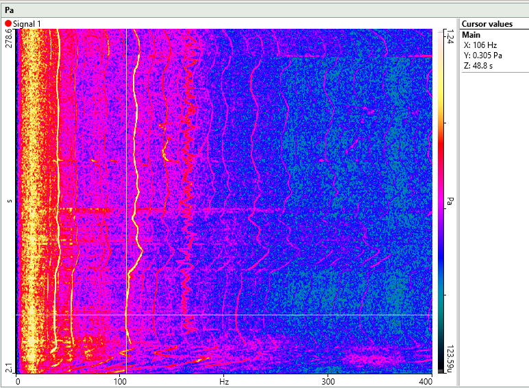

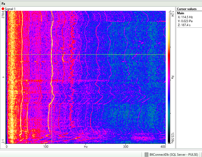

I measured the drone frequency at about 104-106 Hz at 55 mph (roughly the 40-60 seconds range in the images below) and about 114-116 Hz at about 60 mph (roughly the 170-220 second range). This was going up a moderate grade....maybe 2-3%. I've got the 3.73 gear ratio its turning about 1740-1750 rpm at 60 mph.

That was recorded/analyzed using a Bruel & Kjaer system. Not a phone app.
Did this 40" muffler hurt power at all or could you tell a difference? My local exhaust shop told me not to put in a muffler that has baffles or chambers of any type cause it will kill power. I'm pretty skeptical of that statement cause the resonator I currently have installed is just 4 inch pipe with a corkscrew/grain auger on the inside.

I have some tab delimited data that I'm trying to graph...I see 160hz is my drone.....but, cell phone app.

I use it for work. That kind of hardware/software is generally too expensive for consumer use.
There is something there at about 160 Hz, you can see it as a red, squiggly that varies about 10-20 Hz over time.
no sir, the 5.9 i put it one was just over 500 hp to the wheels making 44psi
its straight thru but has a drone chamber in the middle . If you look it up the flow numbers are something.
pm me for more info if you like i dont wanna totally hijacks dan’s thread
