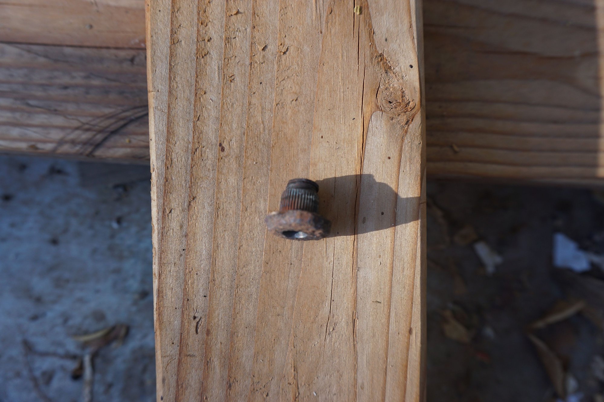

Kaplah!, It's out!
Good morning,
Thanks to everyone. I needed this forum. also special thanks to WWR for giving me the final solution. It may not be the hottest crab but it got the metal glowing red hot.

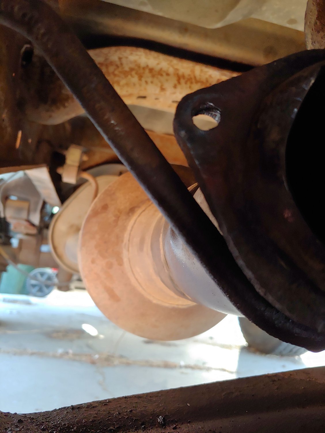

Started the morning with this.
Was concerned about setting the oil on fire which I left from yesterday with the drilling that I did so I tested a small area with the torch.
Spent a few minutes with the torch and got the whole flange glowing red hot from the front and the back of the bolt. Then I started hammering on it from the front.
I realized I got it out part of the way

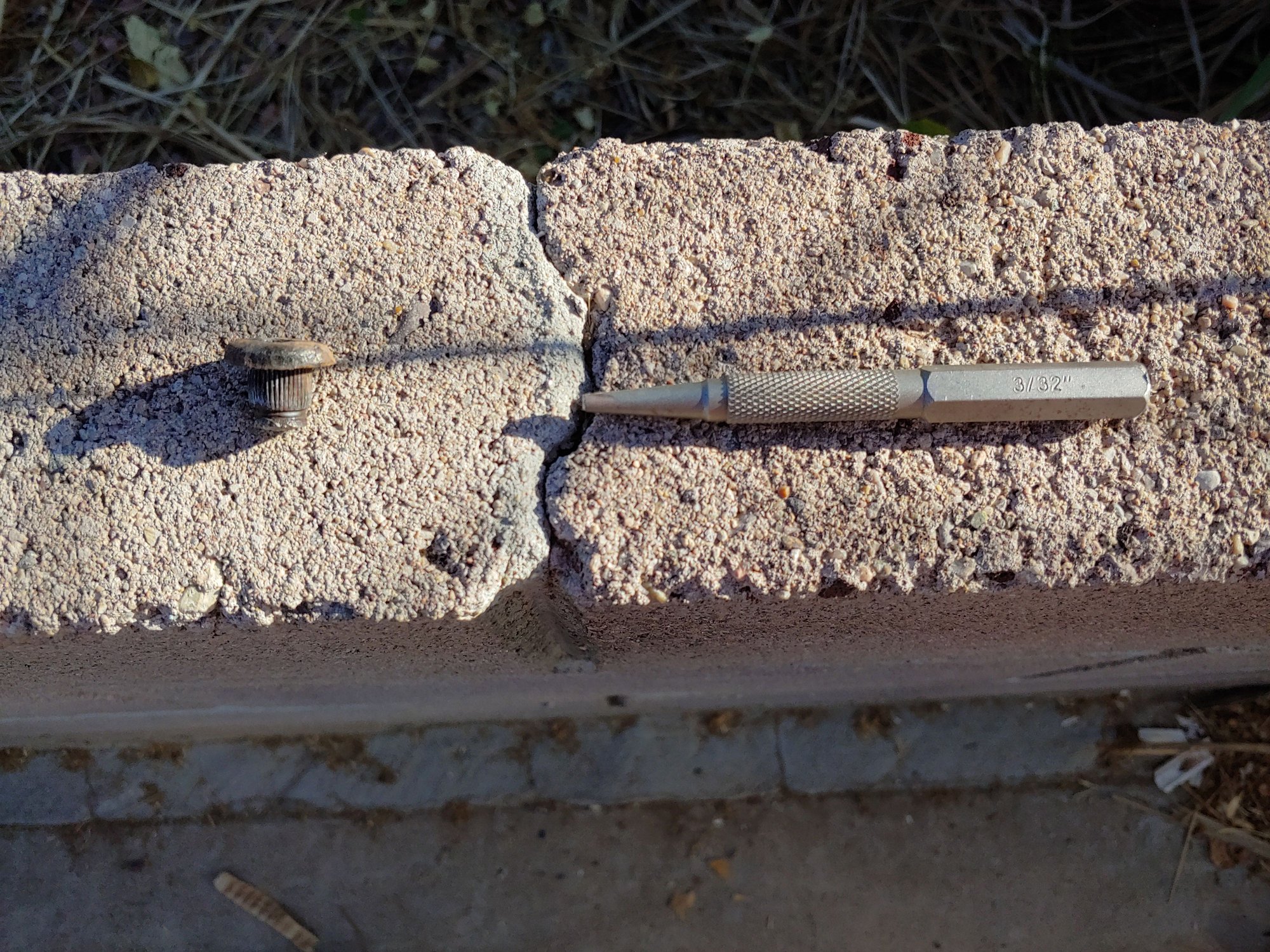

I used a punch to get it out the rest of the way.
So as You can see, It wasn't threaded in.
Thanks to everyone.

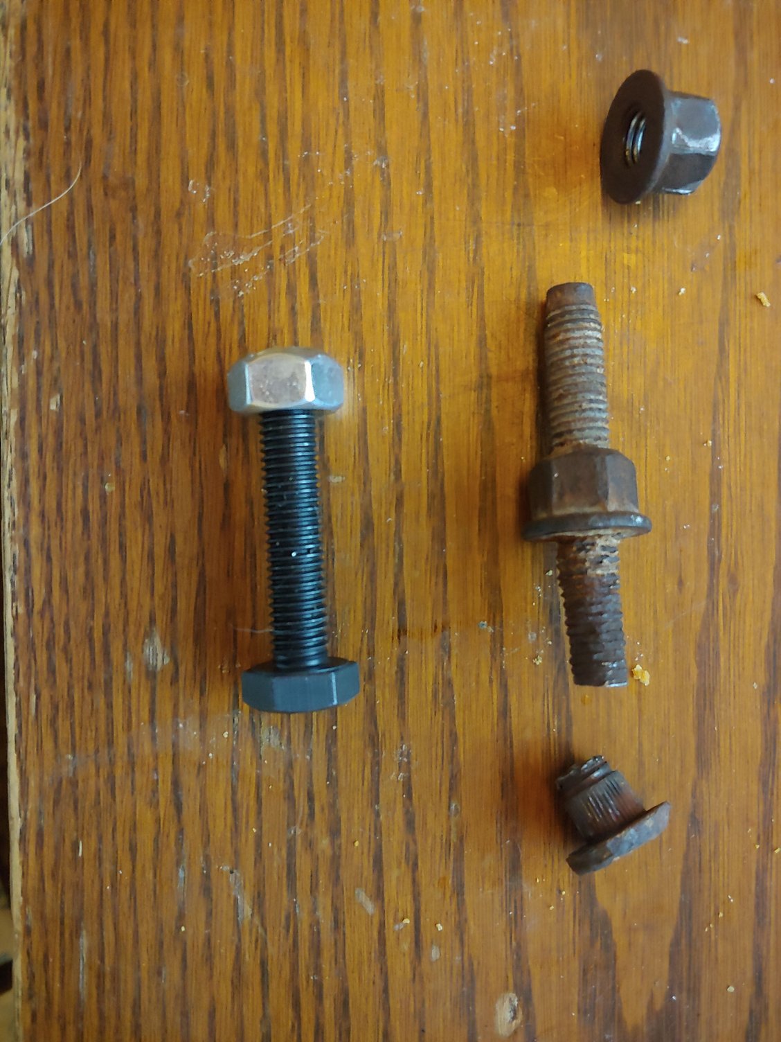

WWR,
I do my panicking between 1 and 3. Really, these days, I don't get out much, and I wear a mask when I do. I don't think I'll be down from this virus, but I don't want to spread it to anyone who might not have the best immune system. This truck thing is perfect for all that stay at home time and most of the parts I get on Ebay and Amazon. Like everyone, I'm starting to get stir crazy.
I dilly around with this work and I still have fun doing it. I don't need the truck to get around so I'm taking my time to get it done as well as I can, one problem at a time, and learning in the process.
I went to Advance Auto parts and Autozone with no luck so I went to Ace Hardware and picked up this. Shown here next to the broken part.
Guess I bent the flange some by hitting it so much when it was glowing so I tried the bolt in there and its a little tricky but I'll make it work.
Thanks again for all your help...
